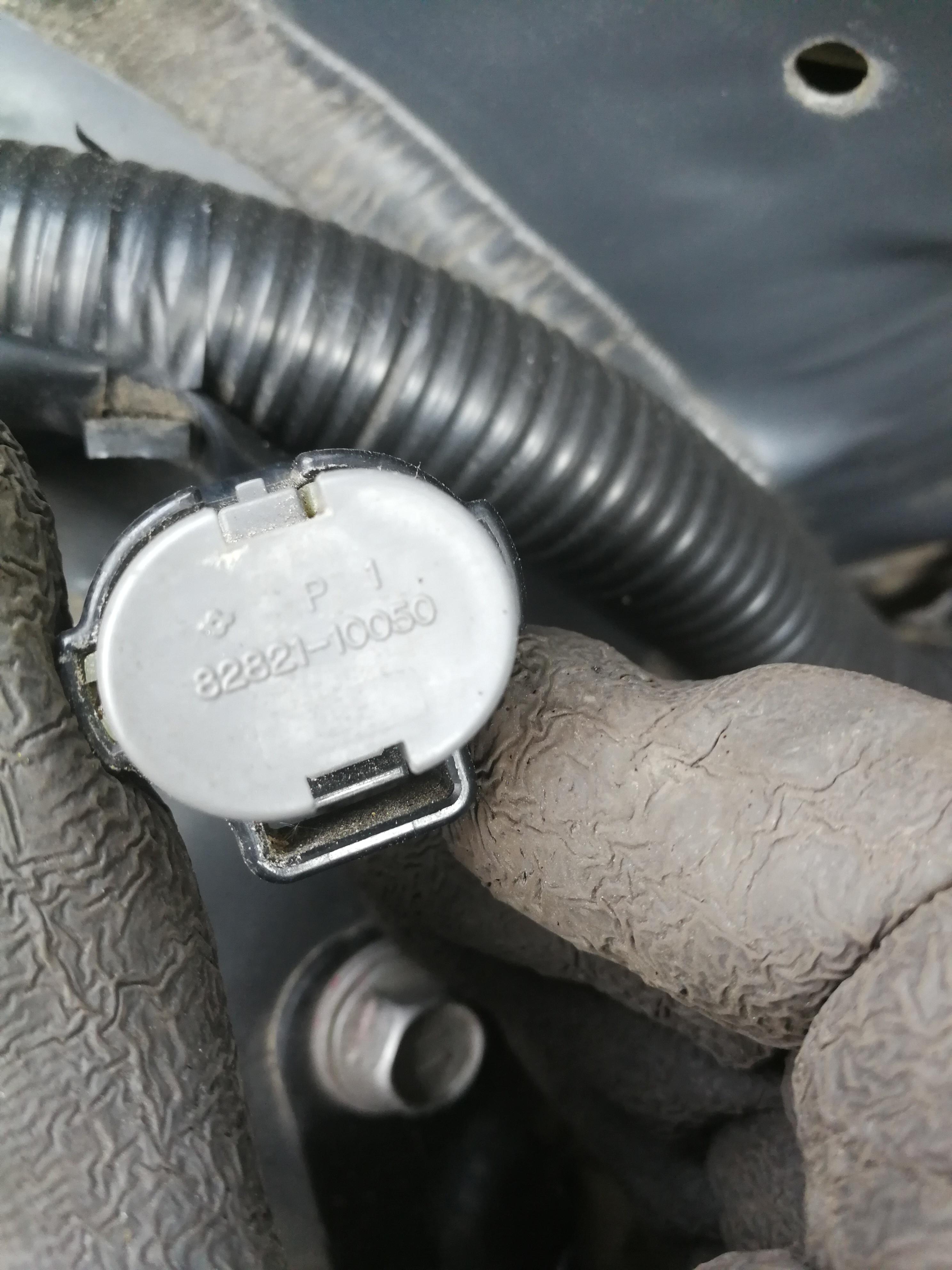

When i was cleaning the engine bay i found something that looks like a 'bypass' for something. (picture) It connects to the wiring harness that goes to the lights, i do not have fog lights.
Thanks.
It has a part number on it specifically so is supposed to be there? Did you check the part number to see what it's for? Is this it?

Look in the drivers footwell, to the left, theres a little black circle thing, with a cable going into it. Unplug this cable, does the squaking stop?
Its a temperature gizmo, if you unplug it you will no longer get hot air through the blowers. I got a 2nd hand one for 15 quid.
