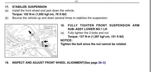

Have you made sure your steering wheel is straight along with the wheels? I once had a Seat Inca and had a similar problem, when the steering wheel was in position for straight ahead the wheels were slightly turned right, like yourself I changed all bushes, anti roll bars tyres brakes d whole lot only for it to be that the steering wheel wasn't aligned correctly with the wheels
Far as i know the steering wheel has never been off
Well, what can I say, Toyota did the alignment - recently, weird thing is, it does seems to vary
Not driven for a few days so, will check all tyre pressures tomorrow and test drive
Any garage doing an alignment / tracking should start off by centering the steering wheel.
So Lorc88s valid point should not come into play as you have had a proper alignment , unless you have lost alignment because you have changed or undone any suspension or steering part since  ?
What he really means is that when you are driving straight ahead, are the steering wheel  spokes  and its  center   even / horizontal in front of you.
Typically a bad knock  to the wheels/steering can result in  the steering wheel  being off center.
They should so , what happened there / i dont know
Steering alignment was done last nothing touched or knocked etc since
