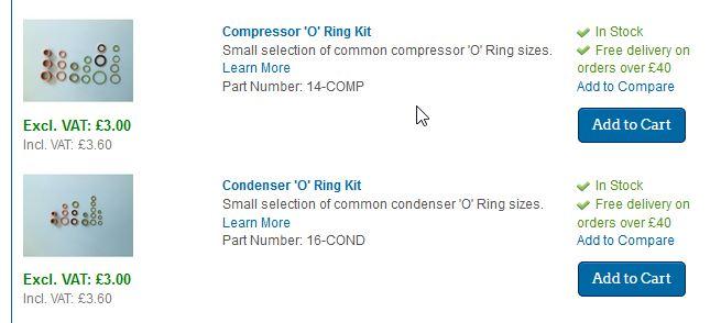

Sounds like you need these as well as they are critical to a good seal
