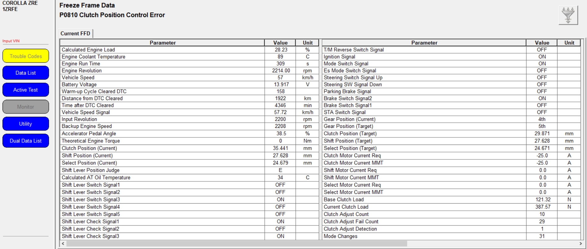

No response from Toyota whatsoever. The problem just happened to me again this morning. I was unable to drive the car, luckily I had my laptop and a VCI connector. Connected the car to Toyota TechStream, and saw the attached error details. I then reinitialized the clutch position and was finally able to drive. The fact that this is happening while I was driving the car is very scary and that's why I decided to sell my beloved corolla as parts. Too bad I really like this car
COROLLA_1ZRFE _22-11-2018 080223.TSE
ErrorReport_COROLLA_1ZRFE _22-11-2018 080223.TSE
