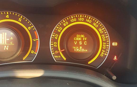

Hello,
I have Corolla E150 2008 1,6 1ZR-FE with a mmt transmission.
I was doing re-initialation of the ecu, clutch and the transmission, with this guide:  http://developer.ps/data/toyota-multi-mode-transmission-mmt.pdf  . So basically I connected the OBD ports 4th port in upper row to 4th port from the right in the bottom row with jumper cable, and put ignition ON and pumped break pedal 7 times fast, and the computer shows me "Diag code FF VSC" and sound beeps 3 times in a row repeatedly. Is this message somekind of fault message? How can i look my active fault codes with thiskind of jumper cable fix without actual OBD2 reader? Is the 3 and 3 sounds somekind of code, or should i be looking the blinking lights if there is somekind of code there? Or is this message just related somehow to "failed to reinitialie the transmission"?
Everytime i start the car it shows no active alarm lights, and checks that "VSC ok".
So I need guide how can i check if there is active fault codes with just jumper cable? And what this "Diag code FF VSC" means?
Thanks in advance!
