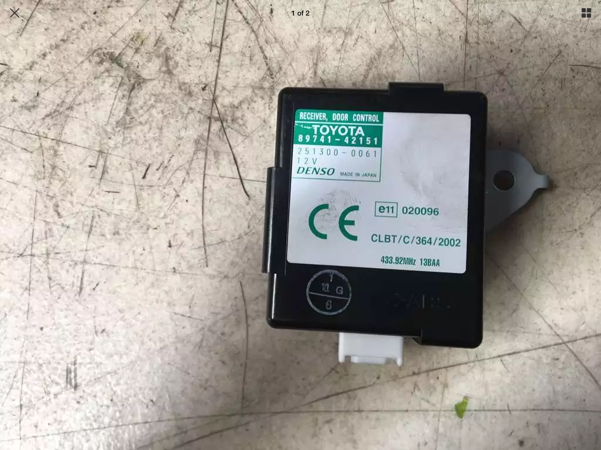

Hi Guys, had a unexpected problem with the Rav today, pressed the unlock button on the remote and nothing ! Doors didn’t unlock and no flashes from indicators, tried a couple of more times but nothing. The red light in the fob was showing well but tried our other key with the same result no response from locks or alarm as this was 5.30 am I didn’t try opening the door with the key as I knew the alarm would go off and panic my family and neighbours !
Left it a few hours then opened the drivers door and the alarm sounded i quickly started the car which silenced the alarm but did notice only the drivers door unlocked the other doors remained locked, toggling the lock switch on the drivers door unlocked all the doors.
The alarm will not turn off using the fobs and just resets to sound again when a door is opened.
We checked for blown fuses under the bonnet plus the fuses under the steering column but all seems ok we then checked for power at the door lock actuator inside the left hand rear panel where it showed approximately 12v but pressing the lock/unlock buttons on the fobs didn’t seem to show any reading on the ‘outgoing ‘ side of the plug but I have purchased a secondhand actuator to try when it arrives.
We tried re-programming the keys which went well with the locks going through the cycling process but no response with the final hold of lock/unlock buttons.
2005 Rav xtr 5 door.
Any ideas guys ?
Ok guys all sorted, it was the lock actuator unit which lives behind the rear left hand panel ( behind the fuel flap )
