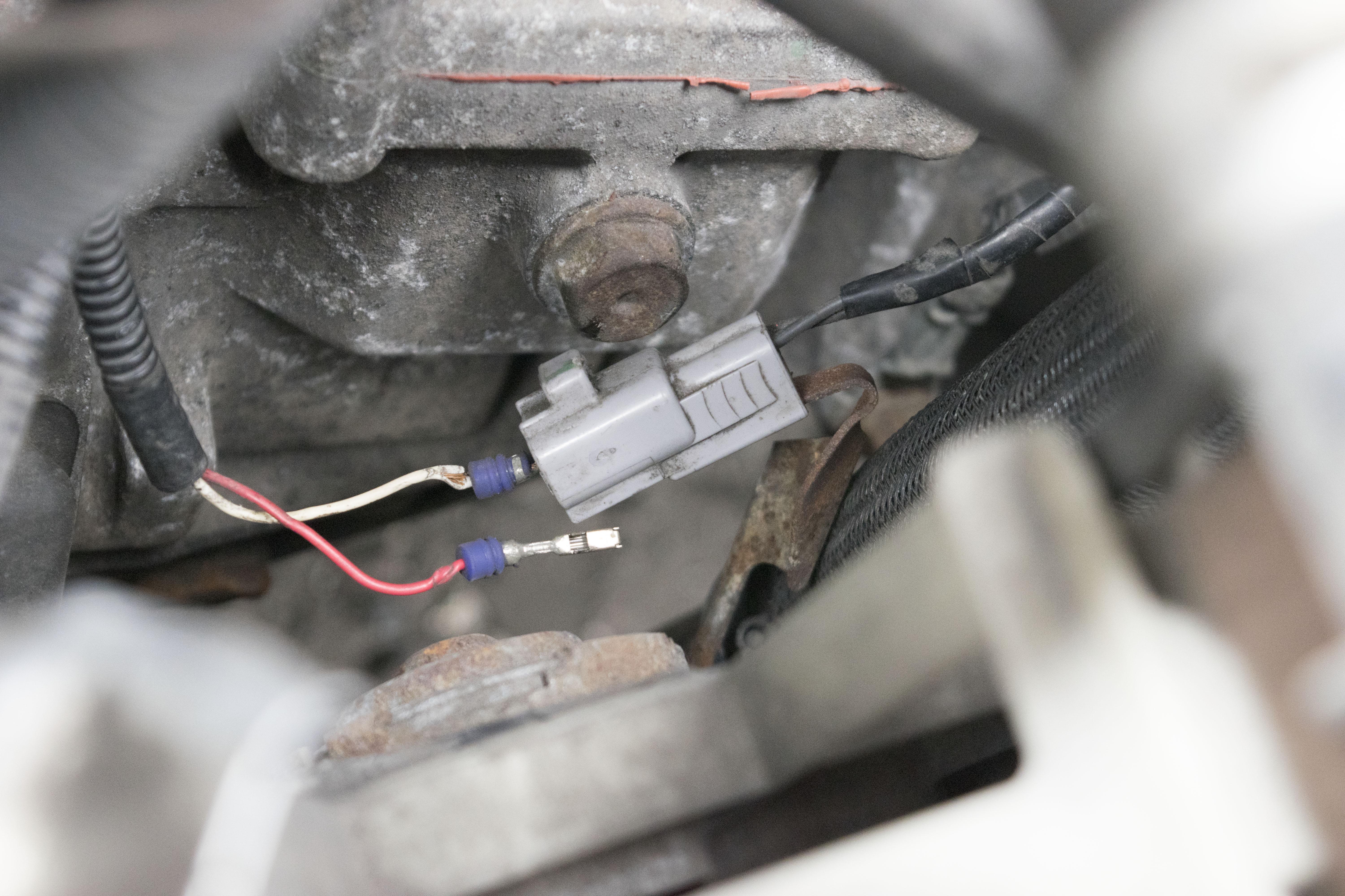

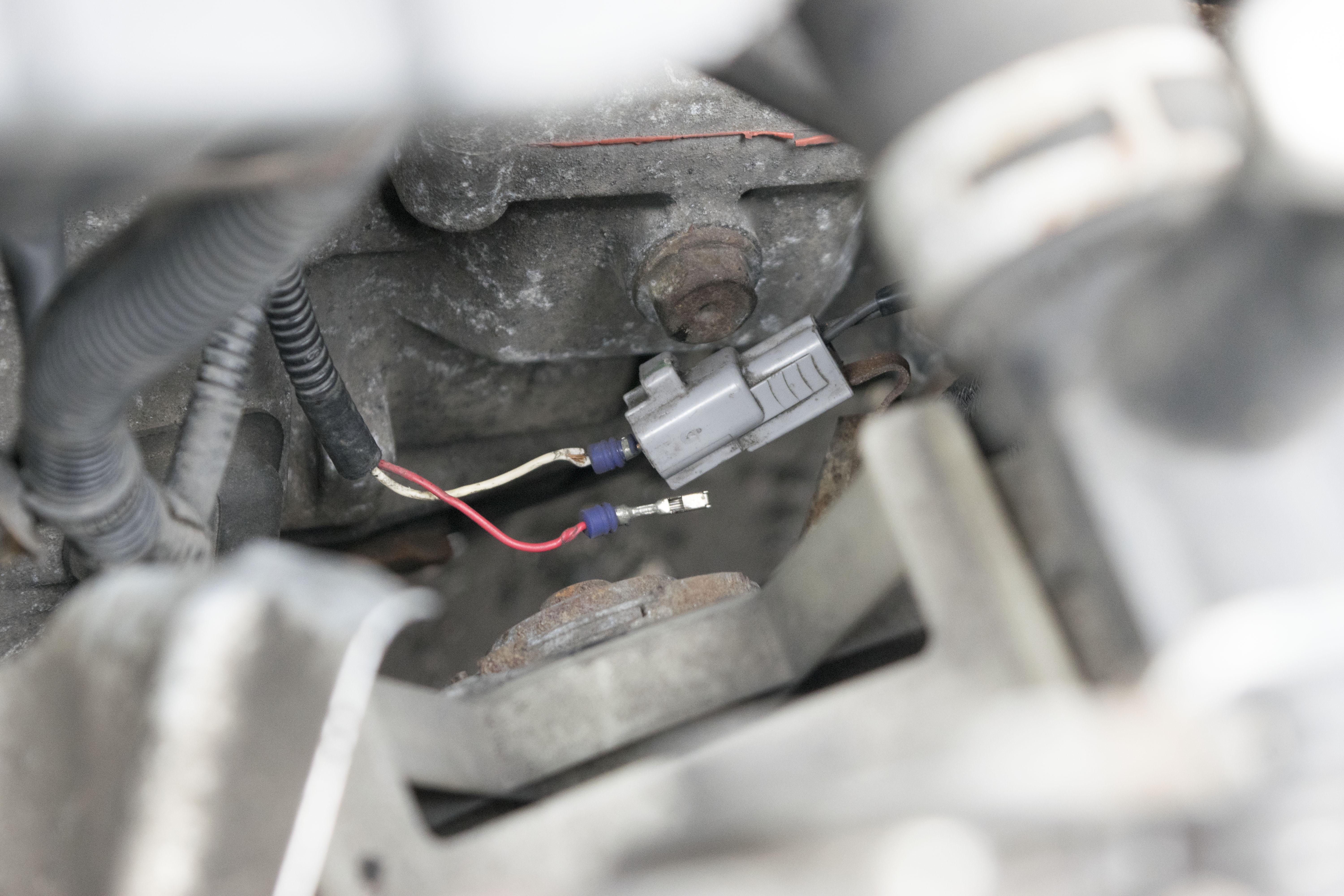

**UPDATE**
I had a look under the bonnet to see if I could reach the reverse light switch - I can't but I can reach the cable coming from the switch.
I've attached some photos - the state I found the connection was the red cable disconnected and the white cable connected. I have no idea why the red is disconnected - however, it is. So I plugged it back in, turned the car on and checked the reverse light - it was ON... the problem is that it stays on regardless if I am in reverse gear or not.... so my problem isn't completely solved but it does narrow things down a bit.
Is the switch probably broken or is the connection shown in my photos not look right? Should I try swapping the red cable around from the white cable?
You said that the lights were okay when you first got the car? It looks to me as if the wire has been disconnected on purpose? From  the symptoms you describe it does appear to be a faulty switch. As already mentioned this isn't an issue with your car when it comes to the MOT, so I can only presume you have need of the lights when reversing. If that's the case I'd simply wire it up to a switch on the dash (not an existing switch but one bought for the job) and turn the reversing lights on and off with that as and when needed. It's a bodge job of course but if you really need the lights and can't repair the actual switch yourself and can't afford to pay someone to do it for you, it's always another option (or last resort).

Any idea what that brown metal looking thing going into the right side of that grey connector is for?

As for the 'brown thing', it just looks like a holder for the connector.
