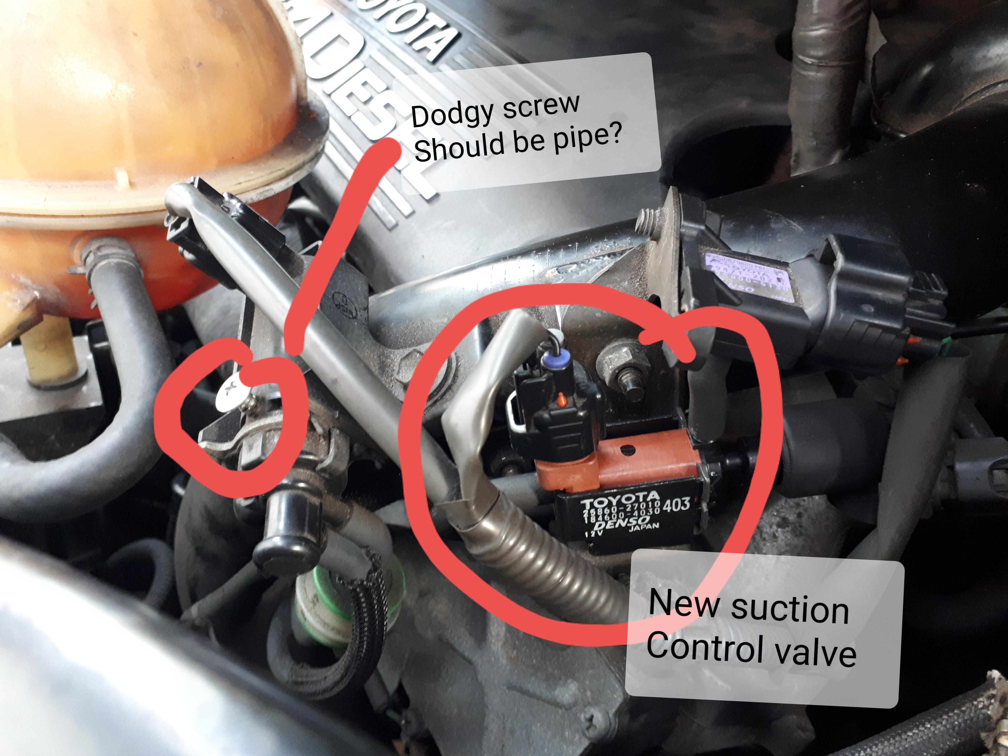

Update. Changed the Suction Control Valve but still got the issue. The mechanic pointed out the new part and also a suspect part with a screw in it! He thinks there should be a pipe there but hes not sure where it goes so he has given up and advised i take it to a Toyota specialist?

That dodgy part looks like the turbo pressure control solenoid and as far as I can see there's nothing too wrong with it. There are two little tubes coming to it and then the electrical connection.

Yes I think you were right.  I have been told by Toyota the Suction Control Valves are part of the diesel pump and main dealer only replaces the pump at circa £1300 + 5-6 hours labour!  The Turbo Control Solenoid is only (cough) £354 from the main dealer and there is no after market replacement.  There's one on eBay for £168.  I bought an OBD reader and its confirming fault code P0627 which is a fault related to the SCV.. God knows why the original mechanic replaced the other bit when the fault code was confirmed as P0627 - he even googled it and read the link on how to do it > https://www.techtips.ie/Blue-Print/toyota-d-4d-suction-control-valve-replacement-1.pdf
