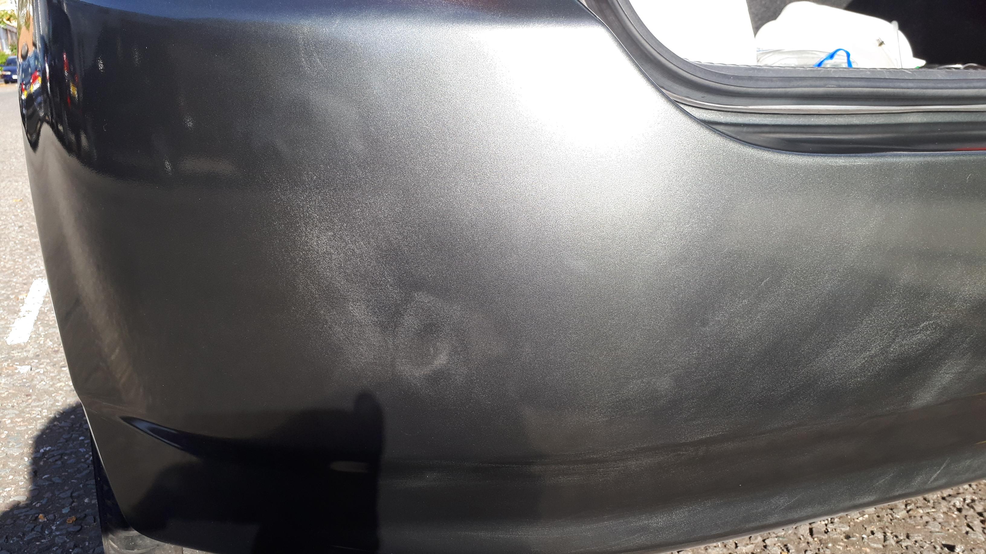

Hi All,
I had quotes of £350-600 to fix my bumper, couple of dents/spiderwebs I caused when I reversed into lamp posts while reversing, rest is caused by others. So I decided to go diy, it started well, sanded down the deep scratches and cracks and filled putty etc.  By the time I finished it was quite a few patches so I ended up scuffing the whole bumper, prime it and basecoat. I hadnt taken into consideration the extra paint I will need, so I just managed to cover the bumper with the one can of 400ml. Me being impatent, went ahead and did the clear coat as well, I only had one can of 500ml, managed to get one coat.
Very ill prepared I was, the result now is a matt looking finish, otherwise would have had goot results.
My question is, can I now apply further coats of the clearcoat by scuffing/sanding to get the wet coat on, its been a few days since I did the first coat
Or do I need to sand it all down and start all over? Which I'd like to avoid.
Thanks.
As long as you key it up with 1200 / 2000 grit, you can add more clear coat. Just be sure to coat the entire bumper or there will be a difference in colour.

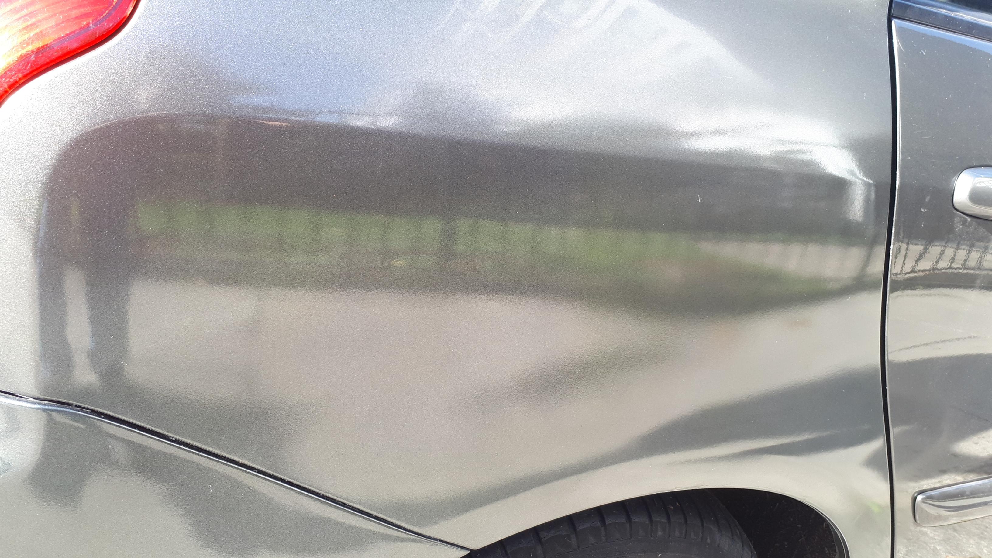

Thanks Jay, I did manage to get half of the wheel arch shiny but that took a lot of passes and the colour isn't 100% anyway, even tried Mr.T before 99%.

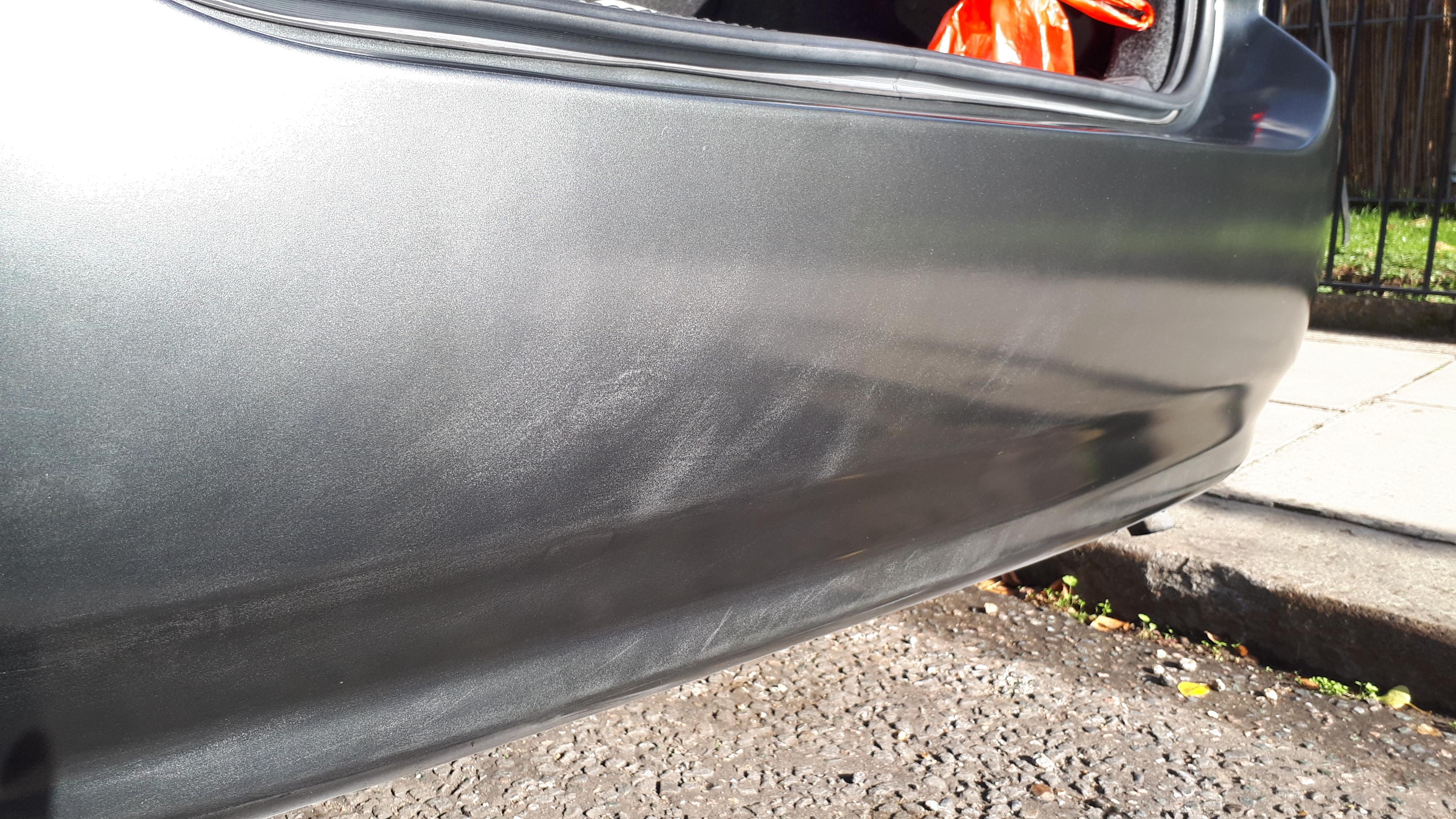

I went with 800, very lightly but still managed to go through in couple of places, wish I had done a couple of coats of the basecoat but luckley I had a bit of spray left over to cover those bits. Some place it didnt go through but the marks are visible (swirl marks?) if you look in certain angles.
Overall not a bad finish.

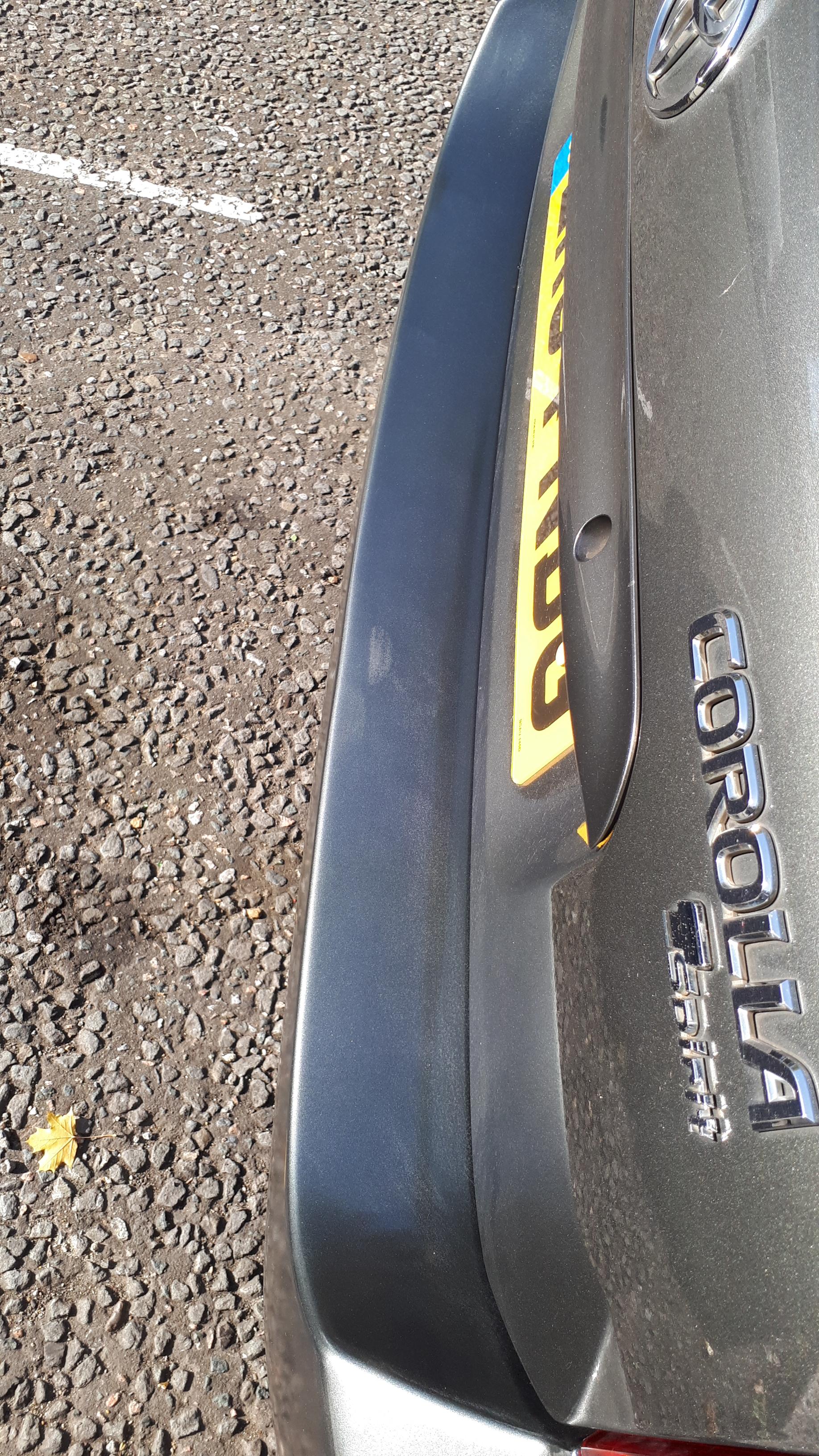

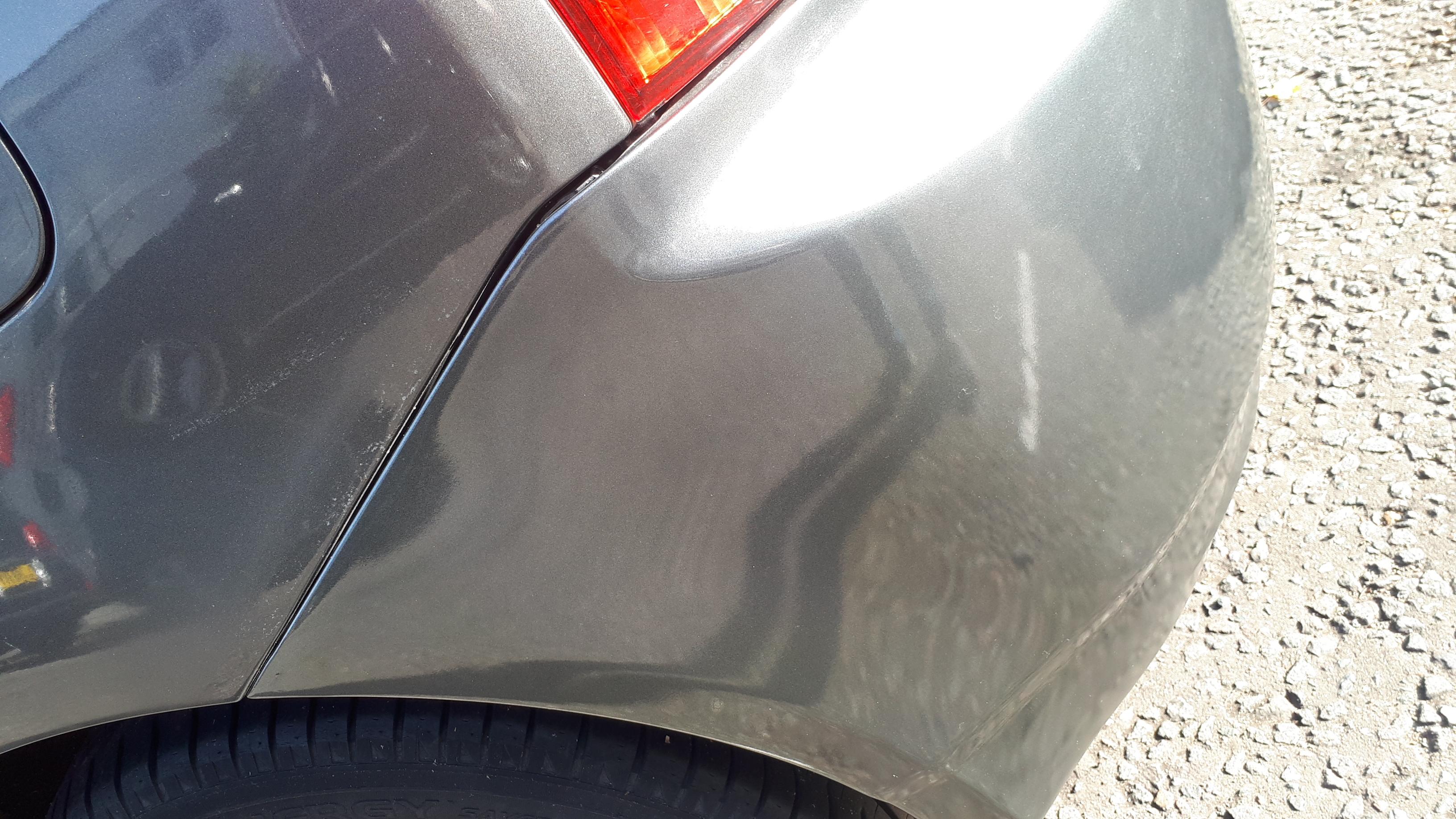

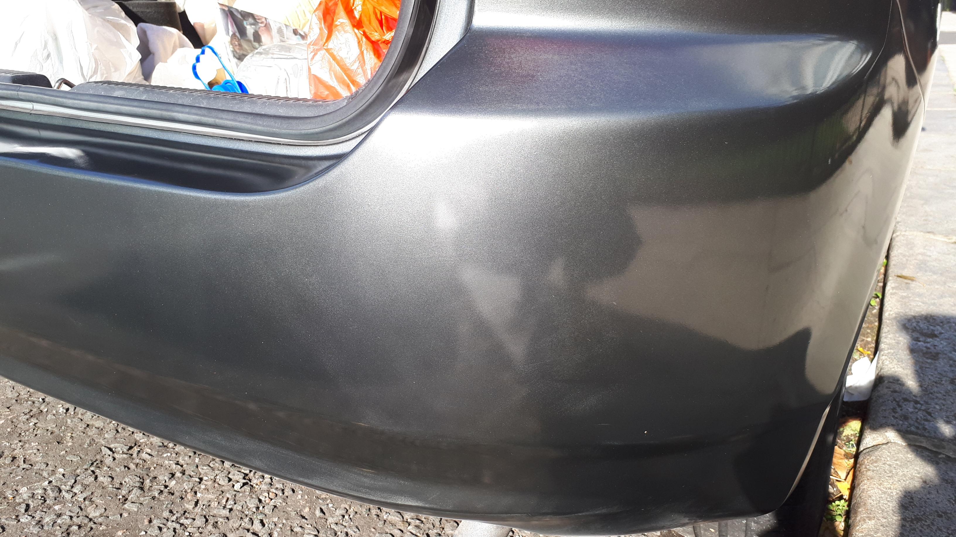

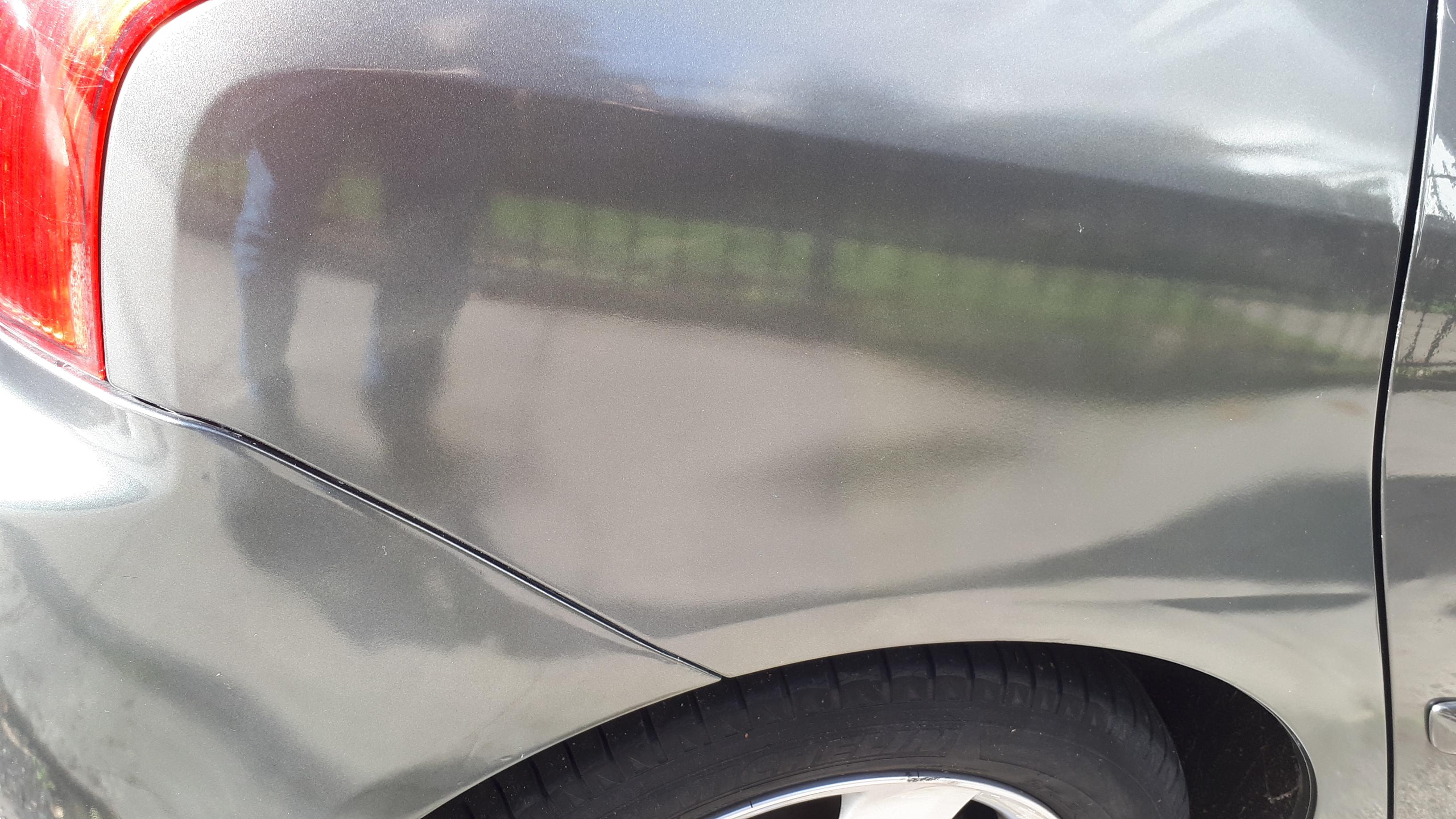

Here's some pictures, looking at it now, I can see some of the filler patch showing through in the corners...😐
Looks alright to me, job well done, considering circumstances.
Got a pretty decent paint match too.
Seems to get scratches/marks easily now...I guess the spray lacquer is not as hard as the factory 2k lacquer
Spray Paint is better if heated up to a warm 30 deg C to dry it so it sets hard. Best to do this in the hot heat of Summer really.
Yes I noticed warm cans sprayed better, I had left the cans in the dash while I taped up, they were nice and warm.
