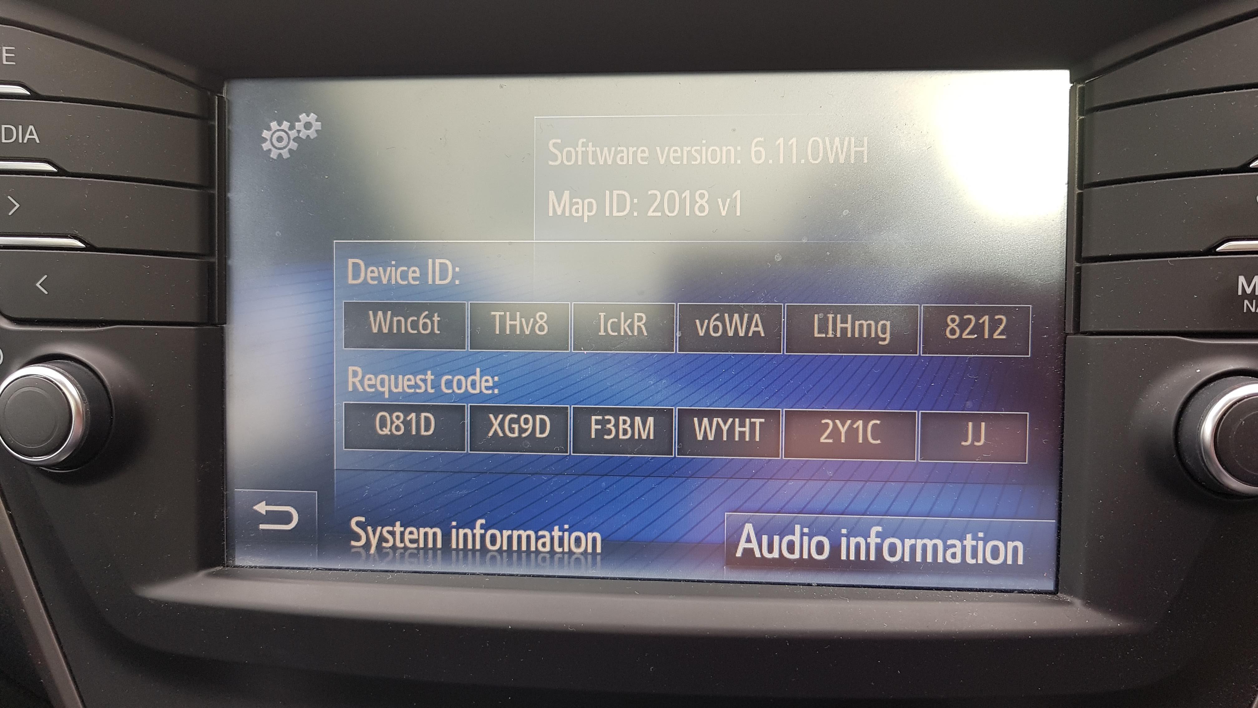

Version numbers of the software in my Avensis are shown below.  I definitely do not have the slow response problem that you are experiencing. I suggest you compare yours.  If they are the same it probably indicates a hardware problem. If different, the first step is to update.  IAN H

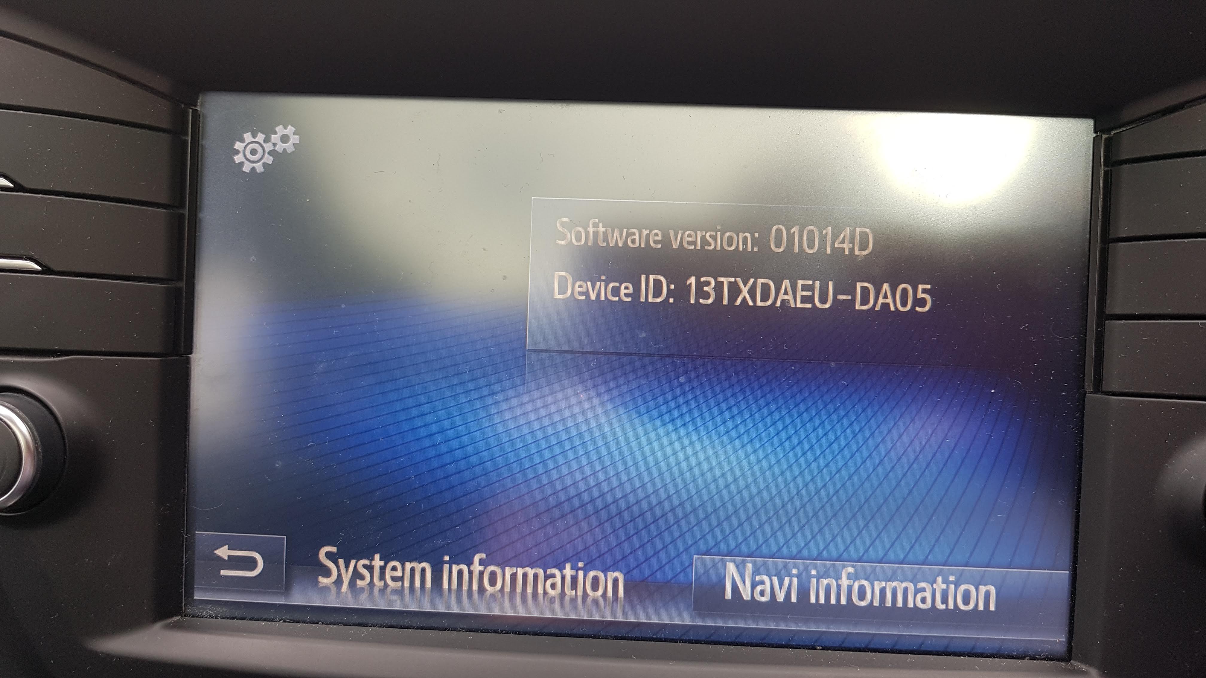

Evening all, my head unit has a few times cut out and restarted. So decided to take a look and is what has led me here, I have a 64 plate D4D. When checking my software version its 000000? But I do have a device ID.
When I go into my Toyota it does not see the software version, which is 4.3.0L and a map id 2014 v2
Not sure what to do, so if you have a min TIA
