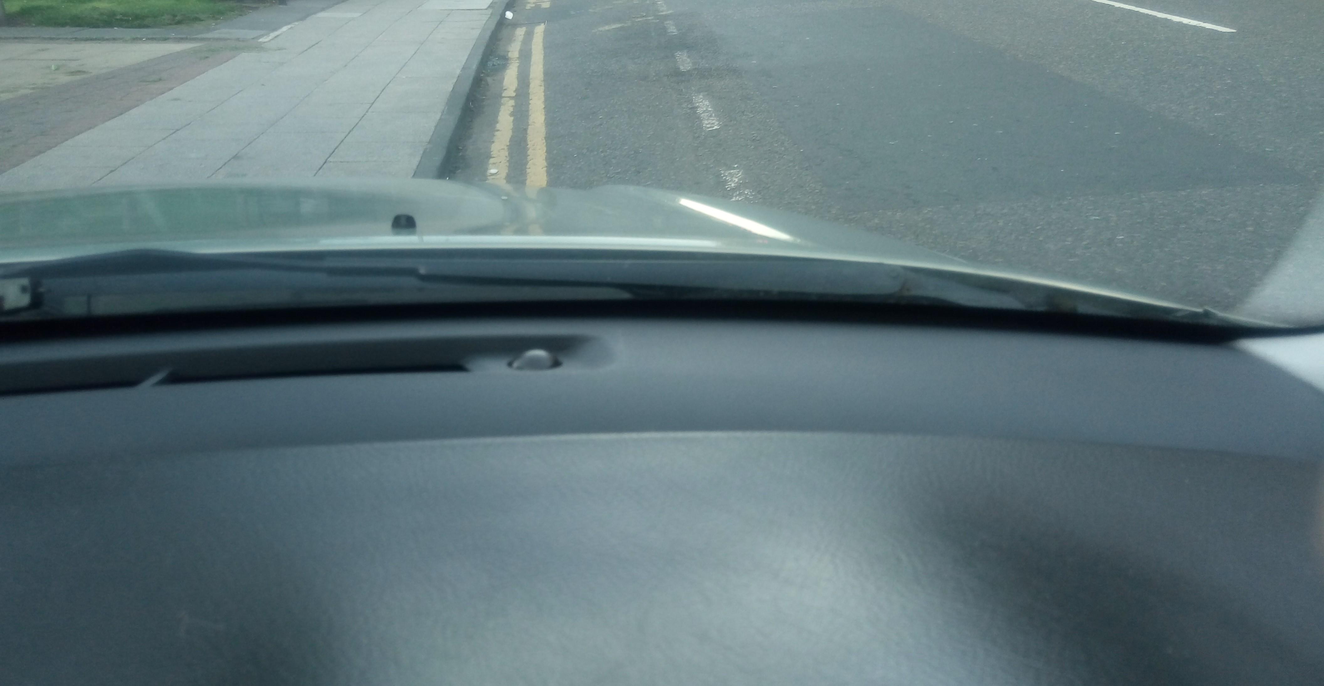

I believe it is the little round lump slightly left of centre here on my 2007 T25.
Thanks!! Will have look again on my 2012 D4D
think that it is on the left of the equivalent vent on T27

Yes thanks been located now thanks v much!! At least have got normal wipers now!!
