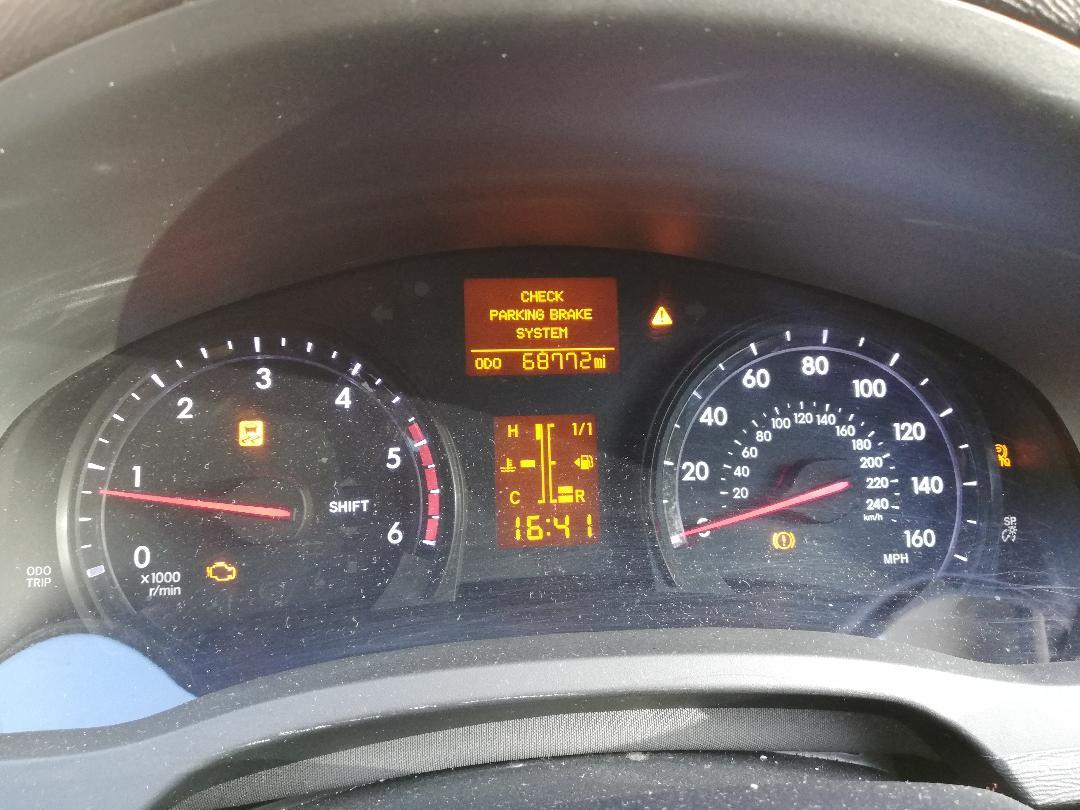

Hello Guys,
I know this is a recurring problem and i've seen all the other topics regarding the same issue here.
My question is regarding my 2014 Diesel 2 litre with auto EPB option.
My EPB is actually working fine manually when the errors are displayed in the pic attached.It won't come out of this error display and also the cruise control won't work. I think I know it's more of an issue with both of my rear calipers, as after driving I can see that there is still rustiness showing on the rear discs on both sides.I recently got the rear pads done and I'm bringing it back to the mechanic to have a look at.
My other issue is has anyone with the same problem experienced a lag in acceleration also while they had these issues?.It is definitely struggling in second gear between 1500 - 2000 rpm range and overall there's a general feeling of a lack of power in any gear from 1st to 6th.If the rear calipers are not working and the EPB sounds and works manually (even with all the warning and error lights displayed in pic) ,I'm not understanding how there could be a connection between the braking system and the lack of power???
Btw all these lights displayed a week or two ago for a few days and then one day when I started it they had all gone and car was back to running perfectly.Now the problem is back again in the last two days.
All seems very strange to me - can't join the dots on this problem, it's a weird one for sure!!
Any ideas anyone?
Thanks all in advance - Great Forum.
Hi Sean, welcome to TOC 🙂
There are a no. of things that can bring on the combination of engine master caution, VSC & brake warning. You really need to get it code read.
With that combination of warnings  the car will usually drop into limp mode hence imo your perceived lack of power.

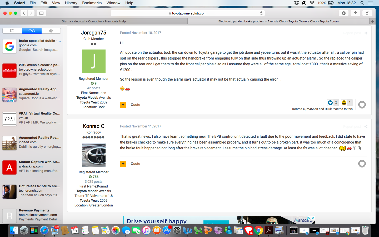

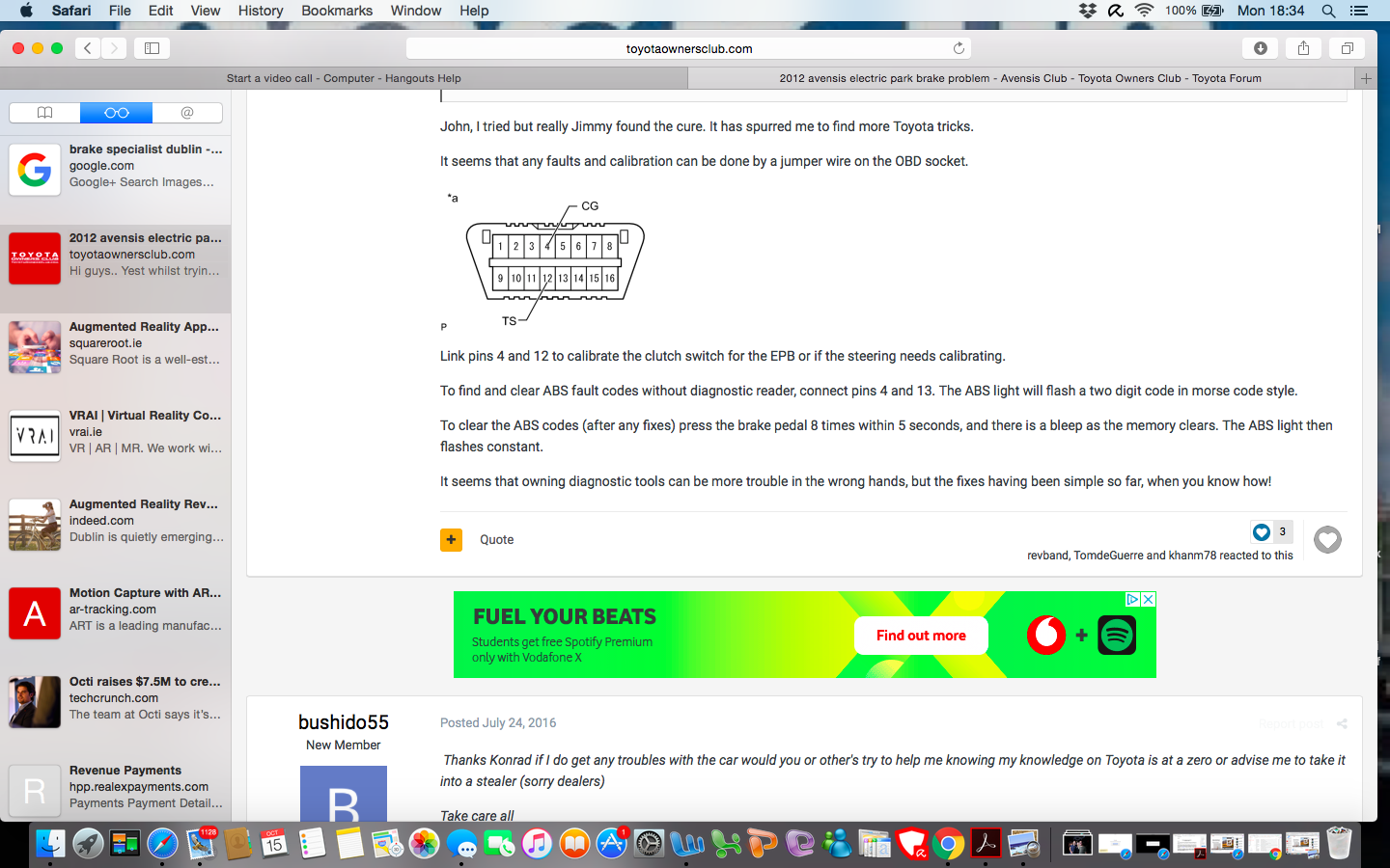

I know I should get a diagnostic on it but reading other topics here relating to the same problem I get the impression that it will just read that is the actuator (I think that's what it's called) ,which is big money,but often it isn't that.I'm not bringing it to a Toyota dealer as they'll just tell me that and charge me a LOT of money.The EPB is working and sounding fine when I engage it manually but it won't work automatically.
And I see from comments like the one attached that it can often be the wrong diagnostic software/tool in the wrong hands that can lead to an unnecessary whole new EPB.I'm thinking it's just an issue with the calipers but I'm wondering if you,or anyone else here, can recommend the right piece of diagnostic kit that I can tell my mechanic to use and then hopefully he can fix the rear calipers and clear the faults showing.
The (small) lack of power thing is still a mystery to me though - hopefully the right diagnostic kit will display that issue also.
 I'm praying it's a caliper issue rather than an actual EPB issue - can't afford that!!!

Konrad knows more about working with the EPB than most non-Toyota staff (e.g. Devon Aygo) so hopefully 1 or both of those will see this thread.
Contrary to Scott's post about me, I only know some of the things about the EBP system. I have experienced a couple of different issues - when the EPB seems to not disengage, so have to switch the car off and restart (very rare). Secondly and after I had the clutch replaced, the mechanic did not secure a gear position sensor connection properly. The following link details the fix:-
It could be a connection issue like corroded terminals.
One thing you should do, is raise the rear wheels and see if they spin freely when the EPB is off. It could be possible that one of the cables or callipers has seized.
Here is a link to a fix that partially worked because the connector was still attached:-
Look at this post too:-
An auto electrician with good diagnostics like Toyota techstream should be able to confirm the fault. My friend (auto electrician) used diagnostics (not techstream) that showed a diagram of the gear position sensor and location.
Other issues could be wiring, and pedal sensors. Diagnostics will hopefully find the actual fault.
I like to learn and know all I can about the EBP, so hopefully this will help.
