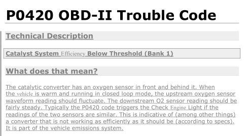

Have some error codes with my reader but cannot post the full details as they are overwritten with copyright markers.
However the key info is below.

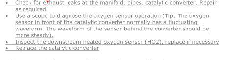

Other causes quoted, in additions to sensors and cat etc   - Leaking exhaust manifold or leak anywhere else on the exhaust system,  Coolant temperature sensor
