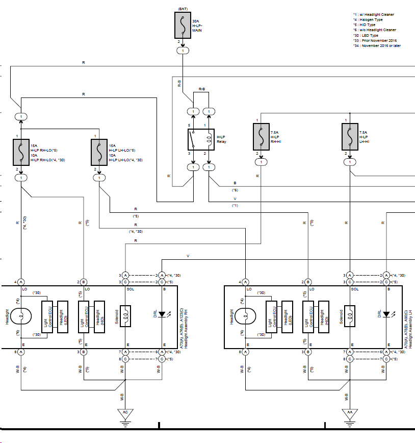

Today then after work i noticed and either of the front low or high beams are not working, only thing working is DLR's and dimmed DLR's to be park lights. Went and took a look front light wiring diagrams what i previously got from toyota-tech.eu. There is master 30A fuse and after that there is smaller 15A fuses to both front lights separatly. Common GND point to all lights. Then went and measured that 30A fuse.. emh it was OK. then measured all of them in engine bay.Everything OK! So it has to be GND point then somehow i thought, but again opened (same right) light back coved and wiggled the connector little bit and here im standing again with working right light unit, did same wiggling to left light unit and it started also working right awat. What the f..?

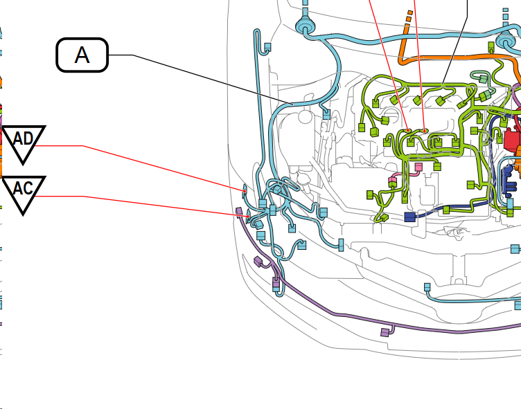

This is the wiring diagram. Both connectors somehow seem to have poor GND pin on the connector maybe or something strange is going on 🤔
EDIT: connectors are not same ones as in the first post on this thread.

I haven't studied your wiring diagram, but I think you'll find the high beam/low beam is done by just one bulb. A solenoid operated mask cuts off some of the beam for dip operation.  If you listen carefully you can hear it 'clunk' when you operate high beam.
So a designed-in single point of failure. Wow.
Worth keeping a spare in the car!
Oh my, i thought that there is old school H4, but it seems to be HIR2 halogen. Googled the bulp type and it has 90 degree connector and that was just the thing i was wiggling. I wonder if replacing both bulps would fix this easily, but hard to believe this is because of them, i kind suspect the connector still.
Our (replacement Toyota Optibrite HIR2) bulbs failed nearly together after 15,000 miles use.  I had to go and rescue the car (no lights) when it happened, as the spare bulbs were not in the car.  I was amazed.  I'd go for the bulbs as the failing items!
I started thinking same, better buy new bulps. Maybe its not at all the connector what made those working again, it was bulp itself what was wiggled along with the connector.
Tomorrow i go buy new ones and see how weekend will then go.
Yup, any time a lamp is out, check the bulb first.
I worked in an electrical specialist garage years ago, this guy dropped off his car with no headlights working and went shopping. Tried to kick off when he was charged half an hour's labour for changing two bulbs! The guys did check the whole circuit, but found both bulbs blown first of all.
Possibly he learnt from that..
Yeah gotta maybe believe that both bulps would be maybe failing same time. First time for me then in 20y of driving 🙂 Very easy to start diagnosing this too deeply.
