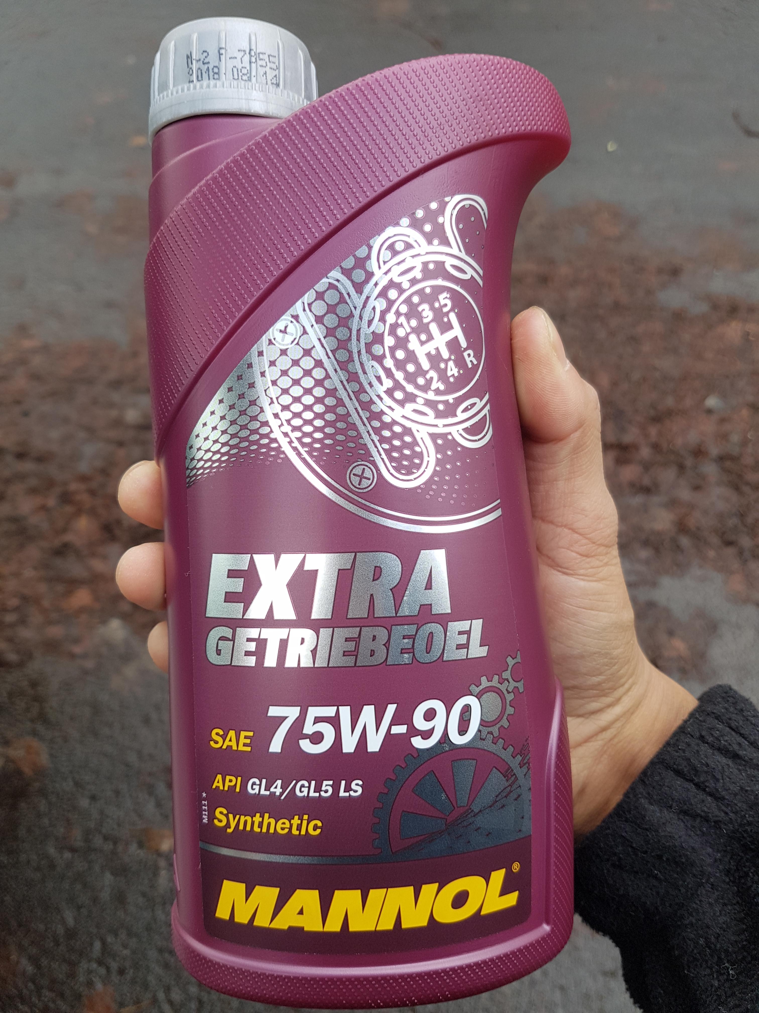

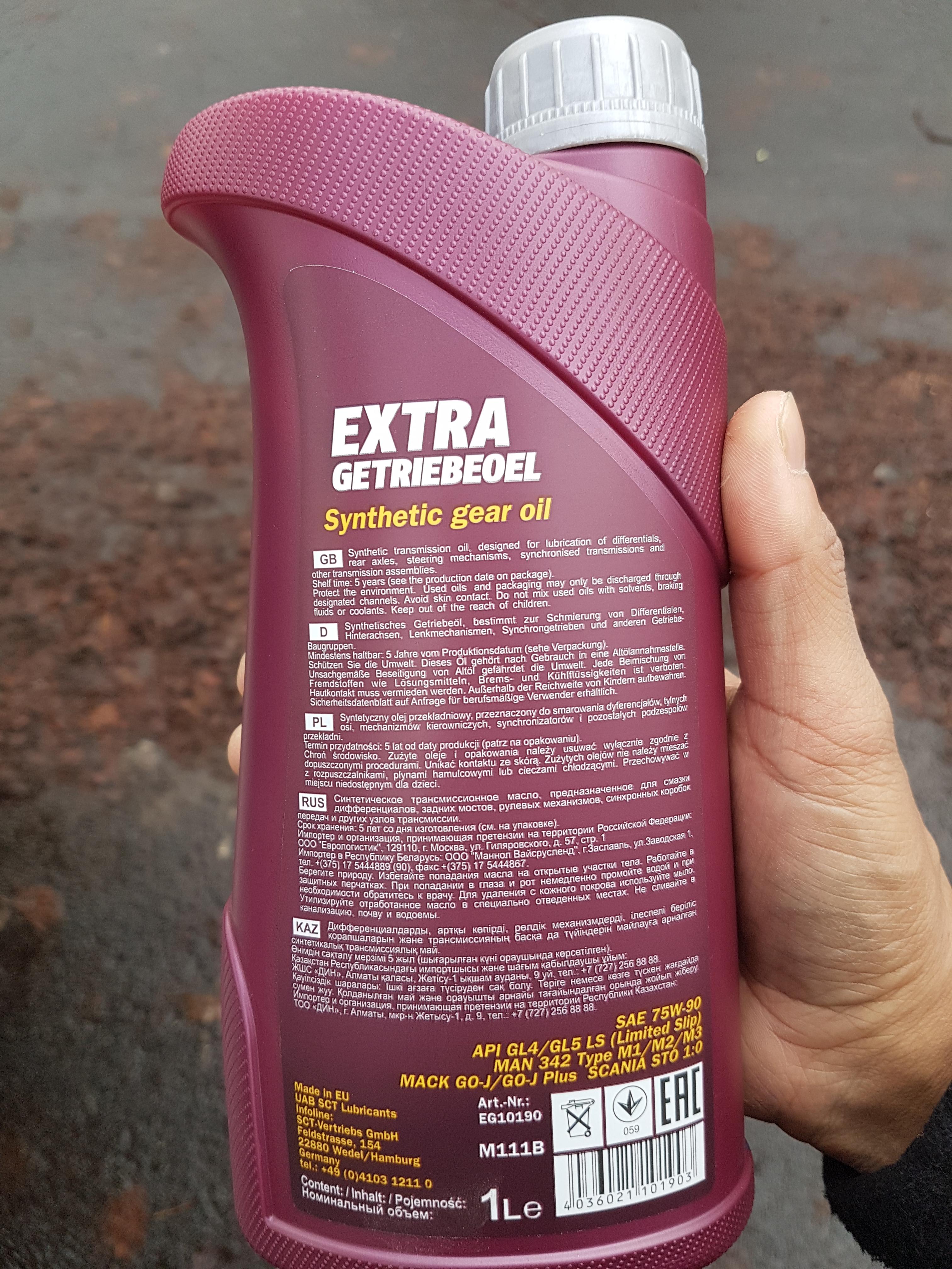

I will get it replaced by the weekend at latest. I have been recommended to change the transmission oil as well. I have not touched the Gear oil in the past 3.5 years of ownership. Wanted some advice if it would be good to do so? Also have brought some transmission oil from my local car shop (image below). Can someone please tell me if this is okay to use for my Corolla? Thanks

The transmission and gearbox are one and the same, you will need 2 of those bottles as it takes 1.9ltr , the 75W / 90  gl4 /5 is the correct grade though no knowledge of Mannols quality.
The gear oil has a service life like anything else, 40k miles or 4 year, whichever first.
You have to drain  the gear oil before you take out the driveshaft or have an oil  shower !
You want to get the Haynes Manual Corolla 2002-6 which covers general servicing and driveshaft replacement etc, well worth the cost.
Mannol is supposed to be good Oil. If you change it, make sure you put in the correct amount of oil when cold to the hole level and on a flat surface else you'll have problems engaging gears!
