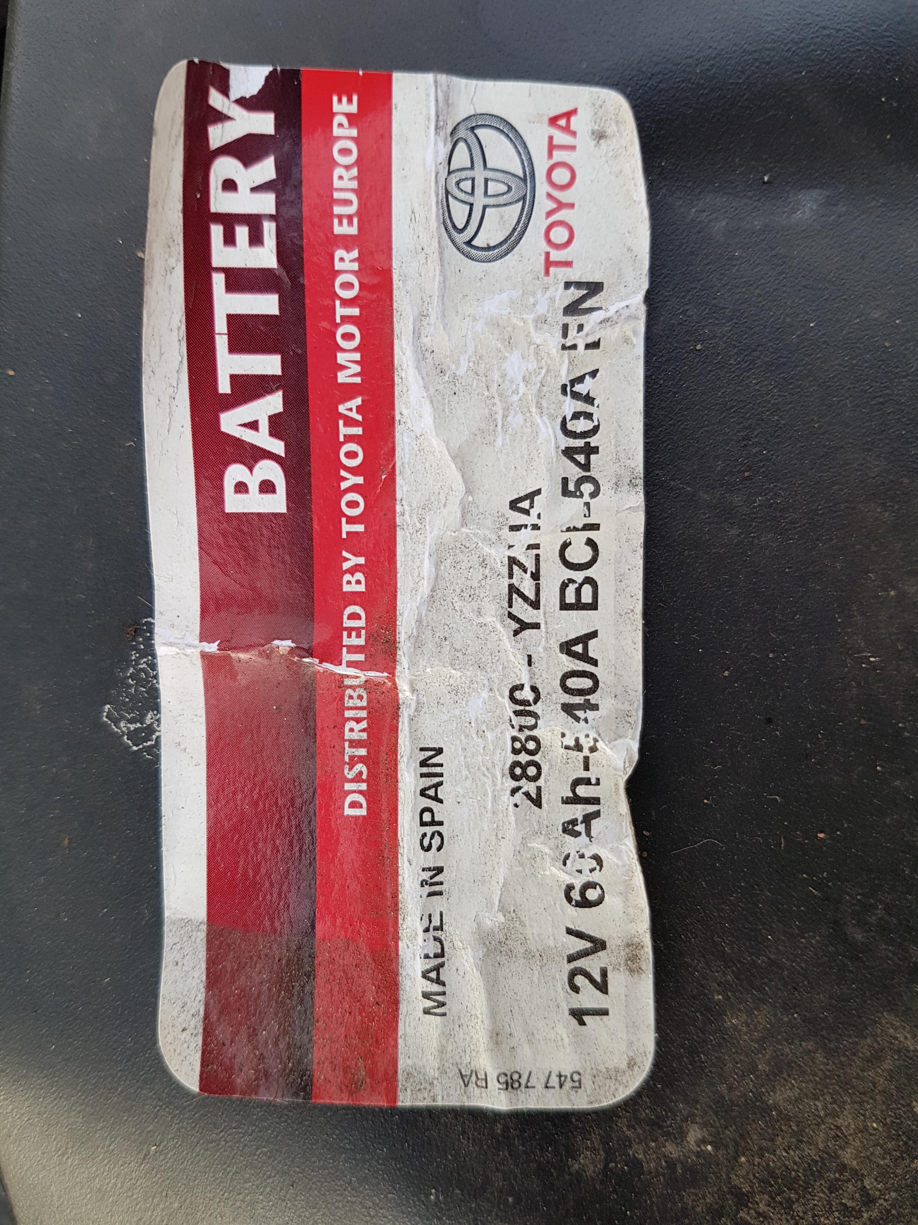

Below i have attached the sticker from my current one. It says 60ah thats why im asking if a 50ah would be okay? Thanks

I would go for the correct rating for the car whatever that is.If we get a really cold spell you could be in trouble if you buy an under rated one. You may also be in trouble with the warranty in the unlikely event that it fails.
You can go on line to a number of Battery suppliers and type in your registration number and they should come up with a number of options. It look like prices have gone up  a bit since my last purchase but you should get something for £50 - £60. If the dealer says 50 AH is ok then go for it.

For starting the engine it is the CCA  (cold cranking amps) and CA  (cranking amps) are the figures that matter most. This is a measure of the current that can be drawn without the terminal voltage dropping below 7.2 volts at the specified test temperatures. The Ah capacity is a measure of the total stored energy available over a long term discharge such as leaving your headlights on or the alternator packing up. A 60Ah Battery would run an 11amp load (typical for a pair of headlights and tail lights) for around 5.4 hours, the 50Ah would be around 4.5 hours.
