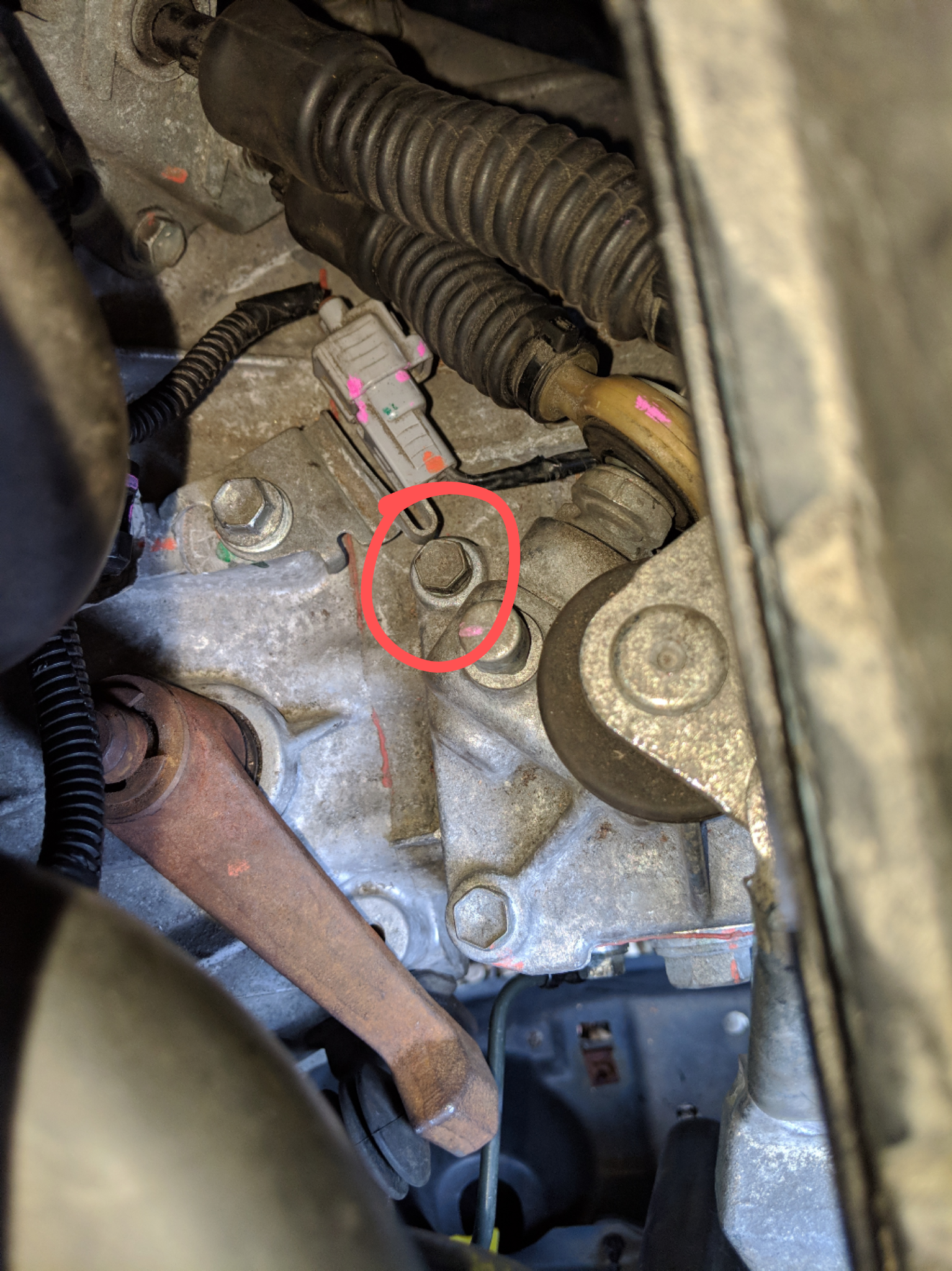

hi, new on hear, i have a 2010 manual 1.0 yaris, have just replaced the clutch. when removing the gearbox i accidentally removed this bolt in the picture, releasing some gas or pressure and now it is stuck in 3rd and 4th all other gears seem to be jammed car is undrivable any help would be much appreciated cheers
Strip down job. Probably you released a ball bearing holding a shaft in a fixed orientation.
