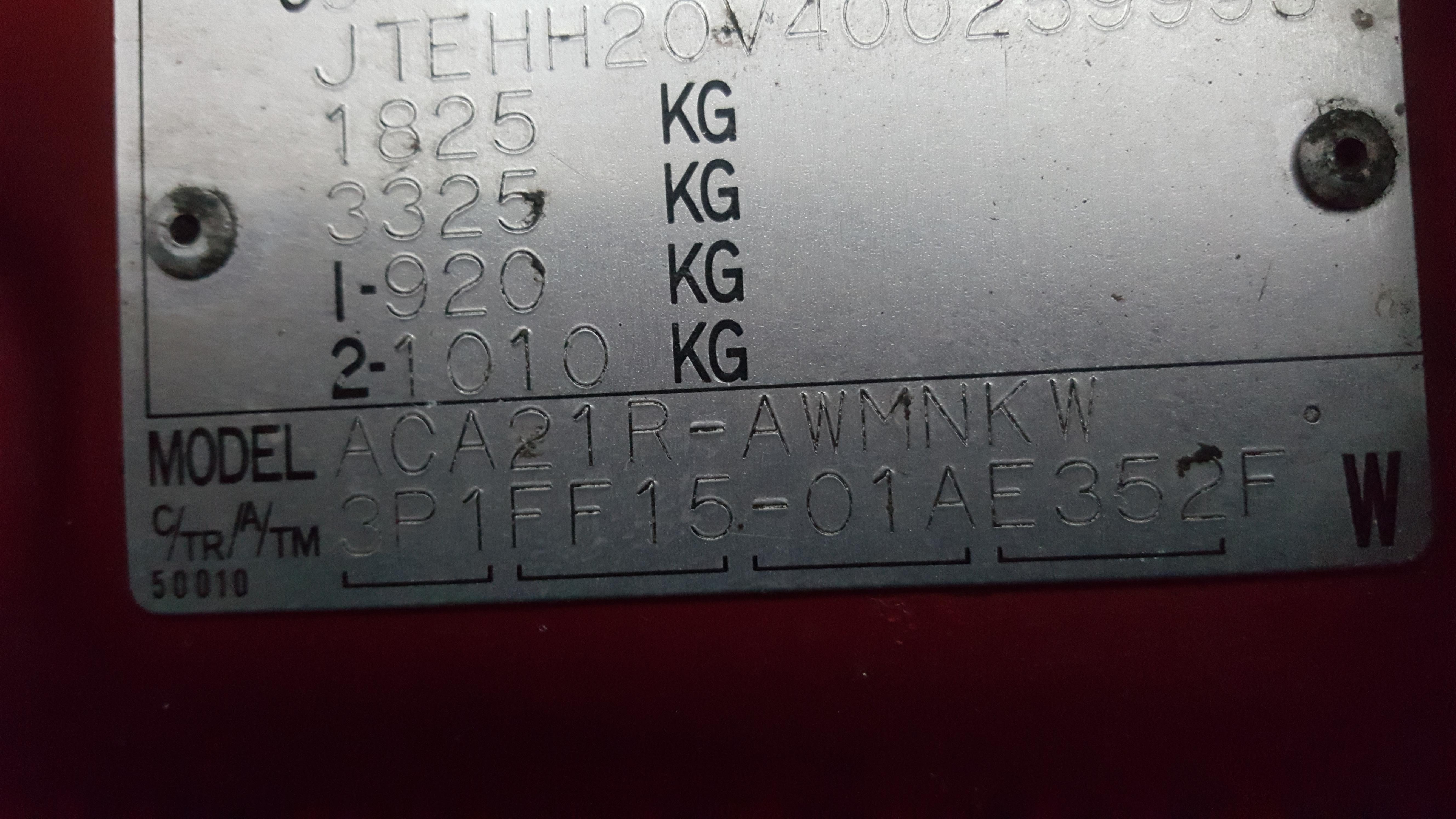

The paint has two paint codes
3Q3 Is the Red metallic
196 Is the Grey cladding
Both are available as either touch up pen or Aerosol from Toyota or local Automotive paint suppliers
Ok bit of a weird one then, your main (red) code is 3P1 however on Toyota list they show Rav in 3P1 as only being a single tone finish e.g red with black plastic unpainted trims and 3Q3 as being the two tone finish.
Thankfully Toyota only did the two tone option in 3 finishes:
1D4 Silver met
056 White ( USA only )
196 Grey met
