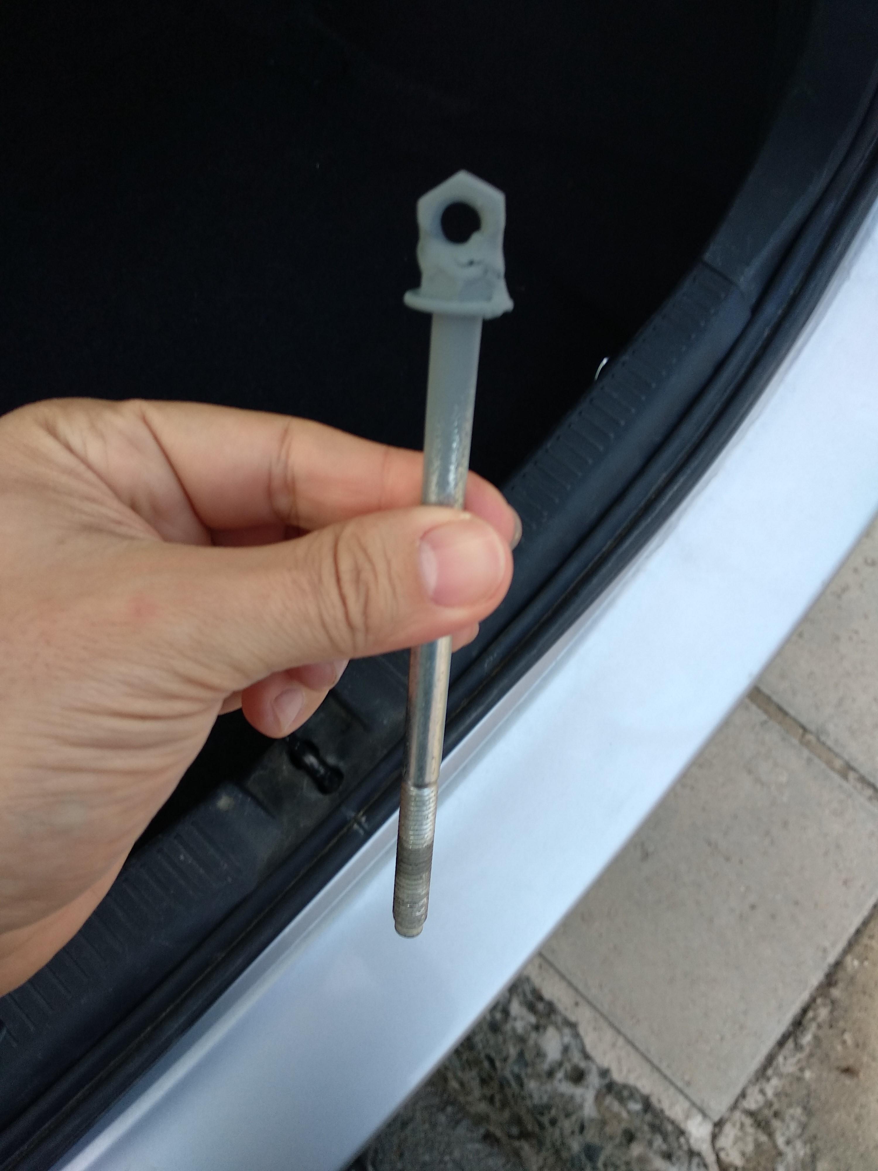

  2. Broken SPARE WHEEL SCREW HOLDER, plastic simply cracked/snapped and metal screw no longer is held by the plastic bit. Tried to drill it through but screw is too short that way. Attempted a DIY fix by using the original screw and some 0.25cm thickness metal plate - cut to size, should hold, I hand tigthened the screw but I don't know if I'll be able to unscrew it if I need to change the tyre and I'm away from the house/without a wrench, but more worried about safety (a friend got hit in the head by a loose spare tyre in an accident - spent a month in COMA and 3 months recovering)..

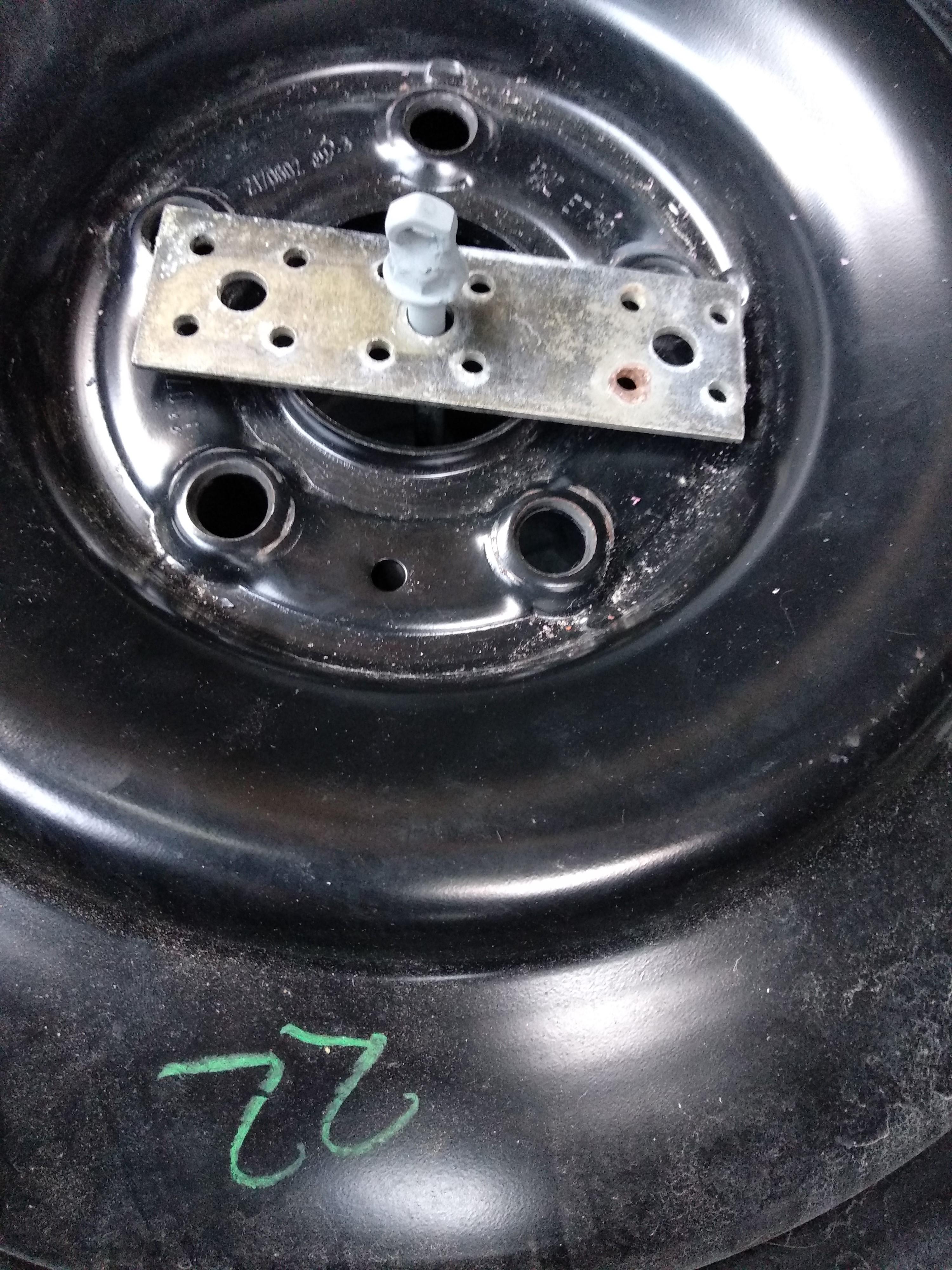

update on fixing that spare wheel holder.
30 Euro for a new one from Toyota? No Thanks. See here a 50 cent solution that works equally well.
1) Welded a hex bolt on top of the original screw (remember, plastic disintegrated)
2) Cut a metal joiner bar thingy to size (bought from a hardware store).
