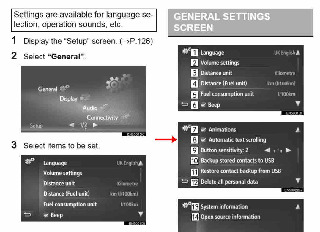

I've got a 68 Auris hybrid with nav but it's a question about the dab display. Often the show name and track disappear off the right of the screen.
Is there any way view the text missing off the right of the screen? I've tried everything I can think of and it's driving me nuts. TIA
On the centre MFD, look for these options:
PeteB thanks for the reply. I'll try this in the morning as its snowing heavily at the moment and I know if I go outside and play with menus I'll be out there a while tinkering
Thanks to all who replied. PeteB was spot on with his solution. Text now scrolling across screen
