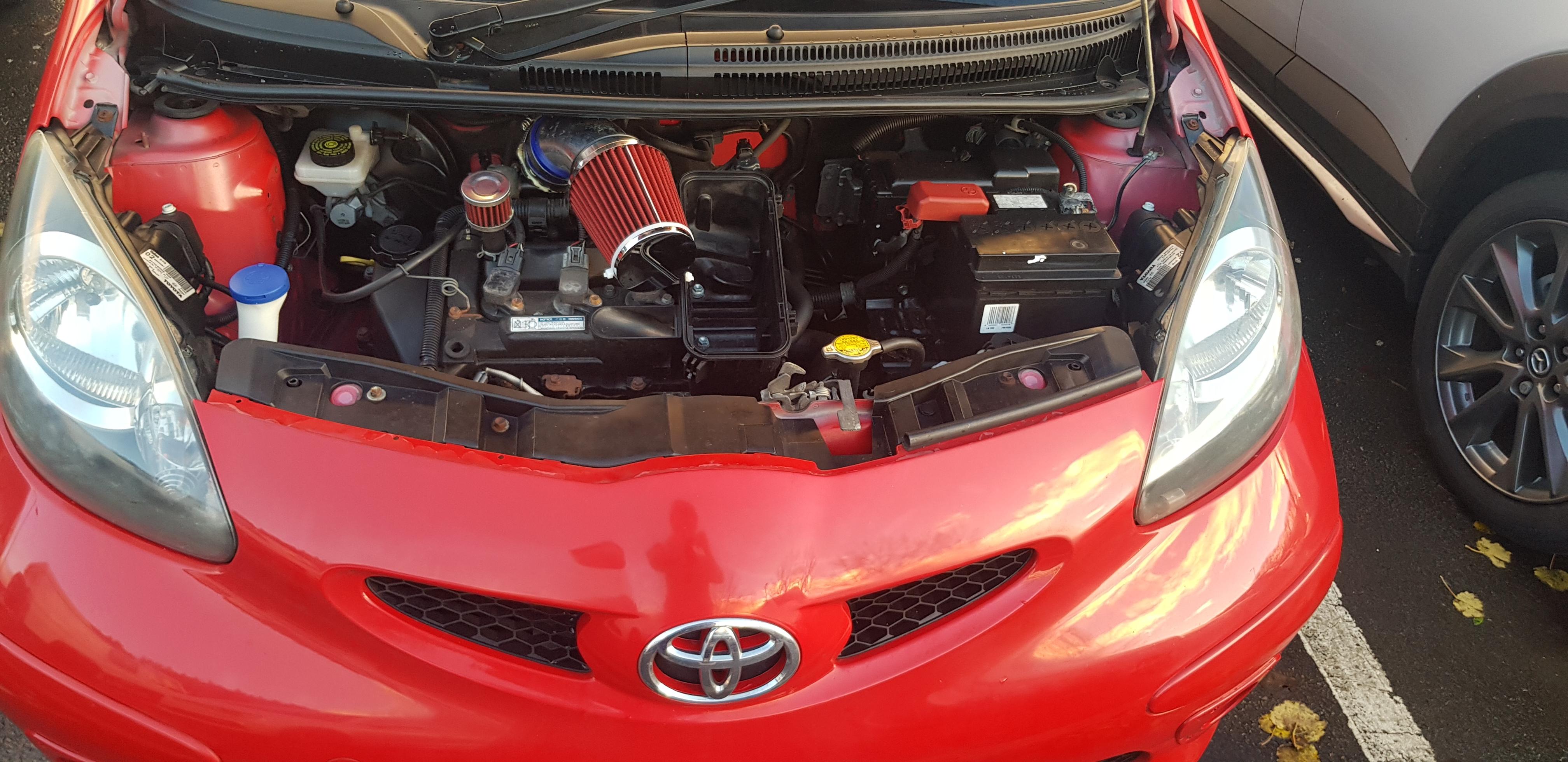

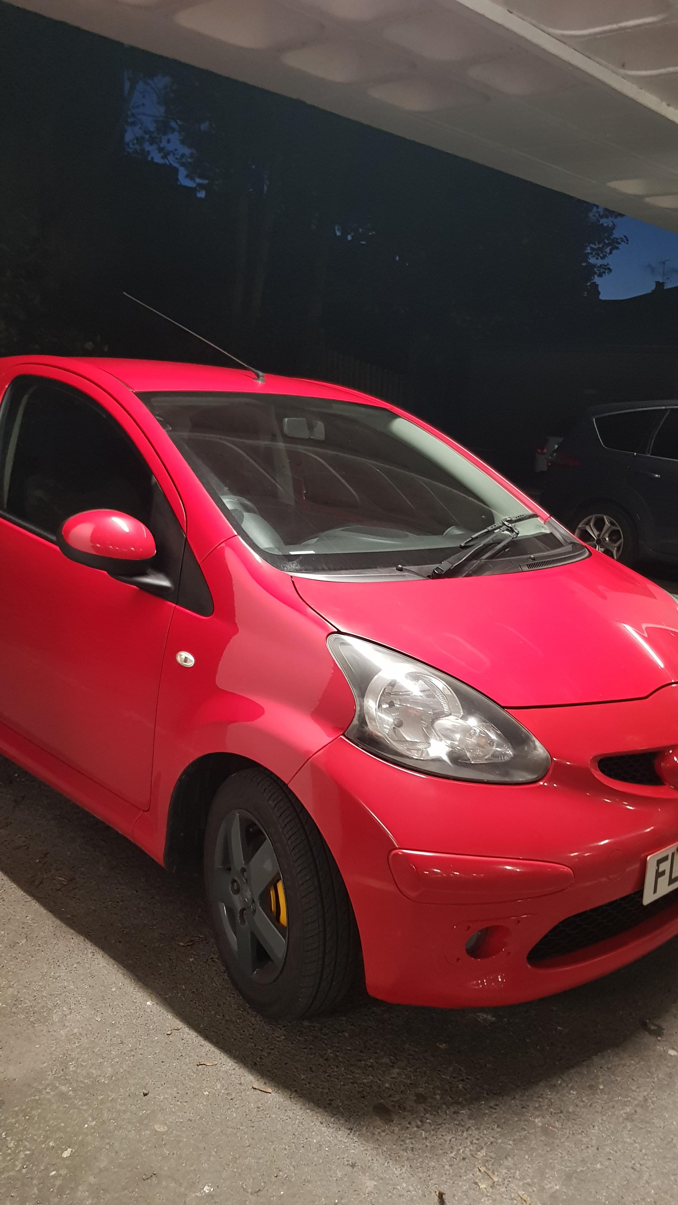

Recently bought a 2005 Aygo Sport. Currently it has just clocked over 90,000 miles and still runs a dream. Fitted a cold air induction kit onto it and re-sprayed the alloys an anthracite grey and calipers yellow, just to make it feel a bit more "sporty".
I hope you like it as much as I do! It's my first car and first owners club experience!

Term 'cold air induction', here, is a misnomer.... FACTORY standard inlet piping is cold feed = you now eat fried air/under hood fumes.
Looks 'cool' tho...

Yeah, agree with you on that.
Callum, you need some ducting from the front bumper area of the car to feed that induction cone with cold air. Otherwise your fuel economy may suffer.

I was planning to take one of the vents out of the front and piping it up from there. But my fuel economy has increased I feel. Thanks for the advice though! 🙂

Best can hope for is a toy model 911 Porsche on my birthday lol, always loved the design. Good colour combo on your Aygo 👍 and great fun factor bang for buck.
Welcome in to the club Callum, the modifications look great so far, and I bet the induction system makes a lovely sound 😄
