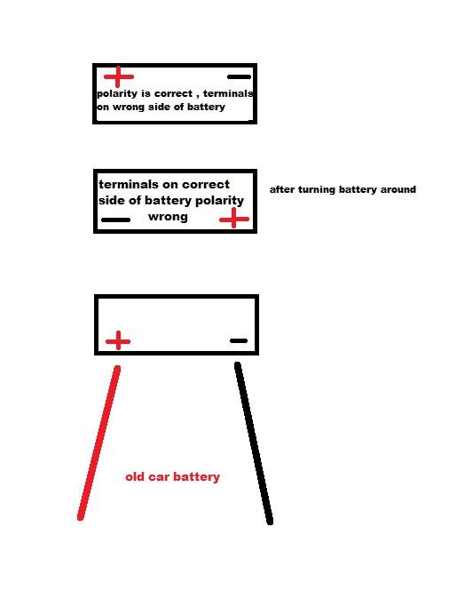

dont just go by the dimensions of the Battery
always make sure the terminals are the correct way round before you buy
3 hours ago, eygo said:
dont just go by the dimensions of the battery
How true. There is a guy in another car forum that bought a car Battery and connected it the wrong way around and fried his car electronics and now the car is dead. Watch your polarity.
quick sketch to illustrate how easy it is to get the wrong Battery even though dimensionally it fits.
Thanks for the heads up 👍 I thought of this beforehand 🙂
