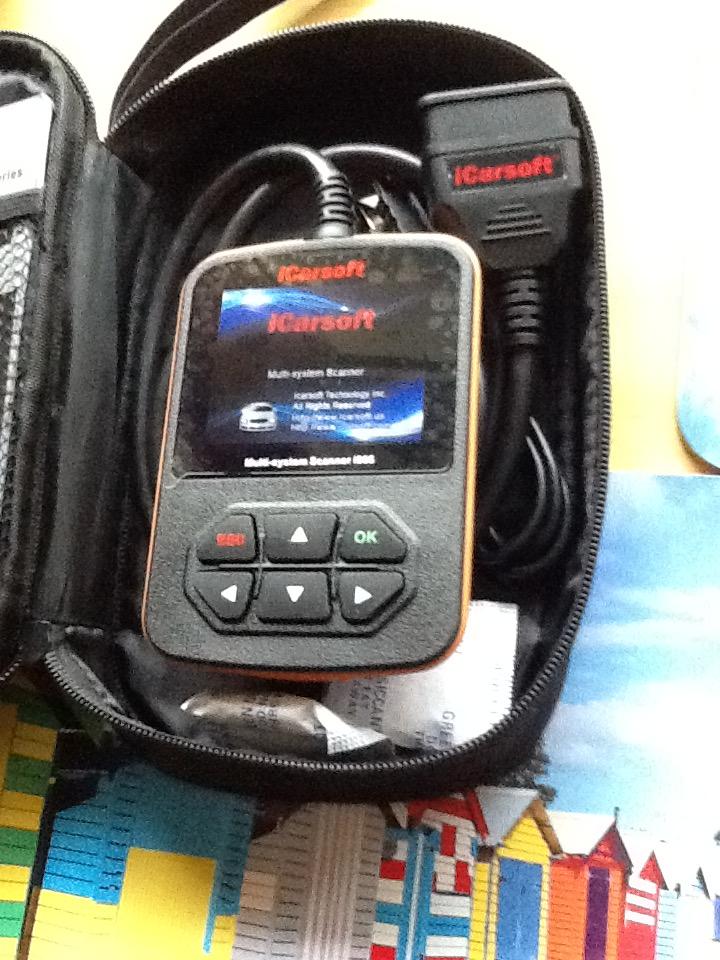

Went out the other morning, I started the car and the EML light stayed illuminated drove to my local garage but their code reader couldn't get into the cars computer. So looking on the web and the old TEOC web site I came across a code reader from Diagnostic world called the iCarsoft i1905. I emailed the company and they assured me it is compatible with the Estima to diagnose problems and reset the computer so I ordered one and waiting for delivery. For £99 I am hoping it will do as it says on the tin. I will relay any results as and when I take delivery of it. Here's hoping. It's strange as the EML light sometimes  goes out after driving a couple of miles  then might come on intermittently or not. Will see what happens.

Update to this thread, I ordered the i1905 on Friday and received it this morning two garages equipment could not read any code. After reading the instructions went down to my local garage plugged the device into car and going then choose Toyota also covers Lexus  then choose Diagnose  and got the reading up o2 sensor bank one. Well pleased with the code reader very good quality. Sensor on order.  I think the service from diagnostic-world.com is really good.
