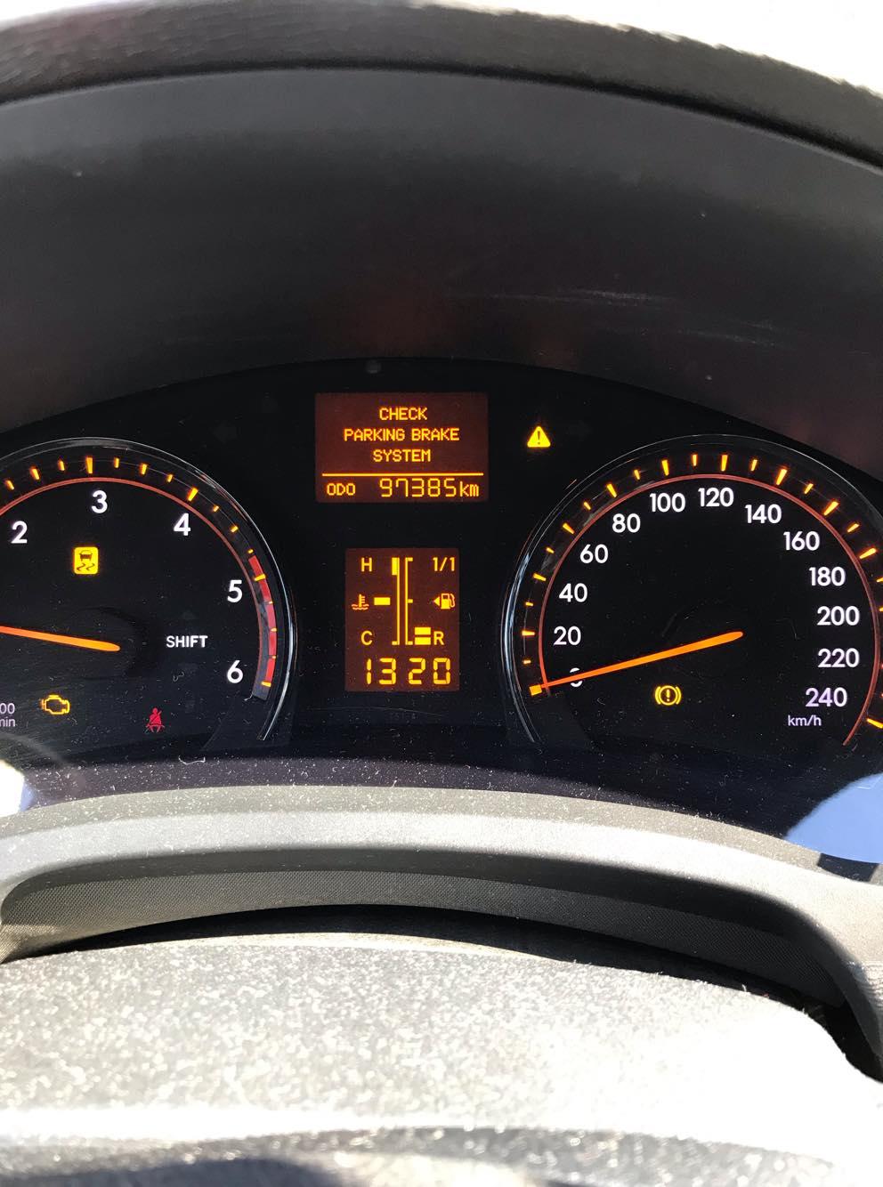

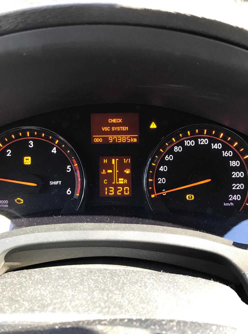

I guess this is already famous question and failure that people are facing with Avensis...but for me something is unclear, this happened all of a sudden, was driving like 80-100 km/h when suddenly got those warning signals, and car couldnt reach 30 km/h with full gas.. so I was driving like that for some time to home...
My Toyota is from 2010, now is like 94k something km, bought it used so not primarily owner...  Funniest thing, the guys did Diagnostics, and couldnt actually said what is it exactly...parking break is OK and they just suspected that can be "malfunction" somewhere but nothing tragic - so got a reset of warning signals with Notice: if something again pops up, then you should leave your car for examination and so on...
What do you think this may cause?? Happened for second time, but first time was because of Battery I assume, couldnt start my car at all, so from Toyota did change of Battery and "solved" through diagnostics errors...but after like 3 weeks I got it now again....
Looking forward for some good thoughts!!! Thank you very much!
p.s I am writing from Germany, because I am considering your Forum better and useful (understandable) for myself!
What do you think this may cause?? Happened for second time, but first time was because of Battery I assume, couldnt start my car at all, so from Toyota did change of battery and "solved" through diagnostics errors...but after like 3 weeks I got it now again....

As I said to Douglas there are so many sensors interlinked on modern cars that warning lights can be triggered by something that you wouldn't directly link. If you are confident that your Battery/charging system is OK then really you need to get it code read again - ideally by a dealer or someone with a system that can read Toyota's manufacturer specific codes.
