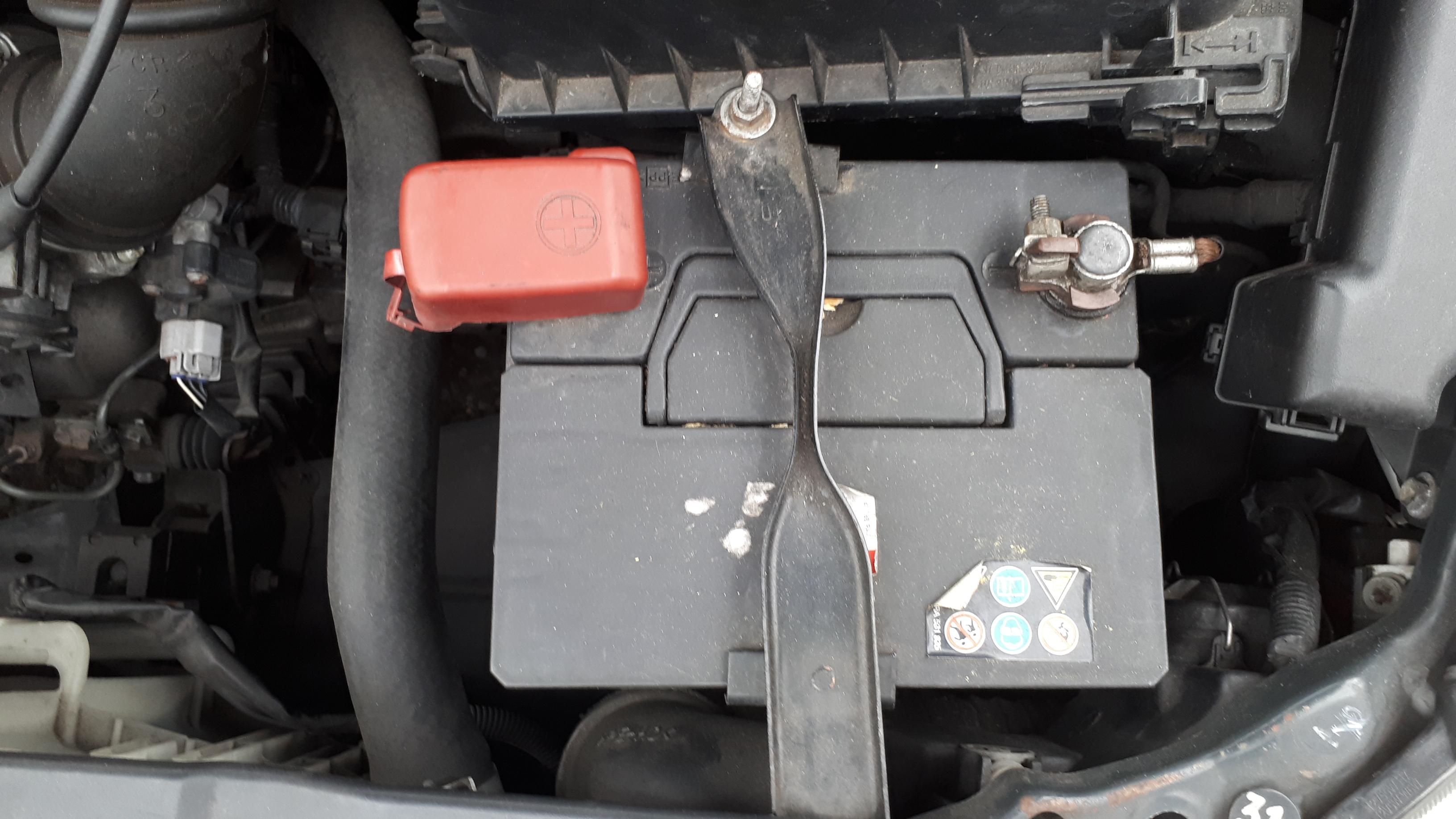

Thank you for all the replies. My current battery 45Ah and 400 CCA HB012 but I was afraid of putting more capacity Battery on as I have heard that alternator might struggle keeping it charged and decrease its lifespan. I shall however contact my local Toyota Dealer and ask about replacing the Battery as they will know best. Too be honest i thought that my Battery was bit small (not physically just capacity) as some website recommended much higher Ah and CCA.
11 hours ago, JohnnyMug said:
Thank you for all the replies. My current battery 45Ah and 400 CCA HB012 but I was afraid of putting more capacity battery on as I have heard that alternator might struggle keeping it charged and decrease its lifespan. I shall however contact my local Toyota Dealer and ask about replacing the battery as they will know best. Too be honest i thought that my battery was bit small (not physically just capacity) as some website recommended much higher Ah and CCA.
My original Battery was a small one like yours, which failed after 5 years,  I then replaced it with the 60ah Bosch one which lasted about 7 years and replaced with the above Varta 60ah brand last year
Never had any alternator or electrical  problems and starting even in the coldest weather is easy, so that dismisses your above possible charging problems, which would only happen if you increased the Battery capacity by an excessive amount.

Not aware of any difference in the Battery housing/tray/lead between any models 2002-2006 so a bigger and more powerful 037 type should work ok, as mentioned above

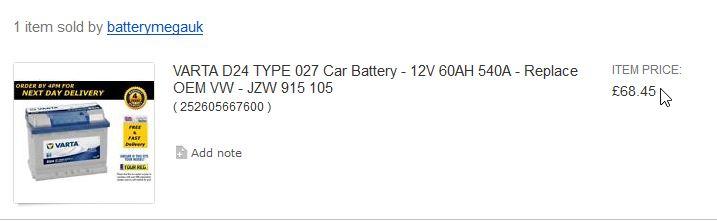

Unless you want to collect the new Battery yourself for convenience, I've seen good reports of Tayna in Abergele, with competitive prices, even with P & P.  That's a crazy Eurocarparts price, unless you can get a very good discount.  I've noticed in recent times that ECP Battery prices are way OTT.

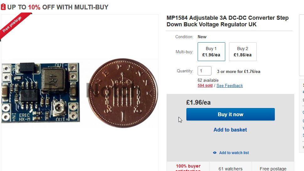

If you have a soldering iron then you can use one of these little modern regulators which use a lot less power than some of the cheap adapters.
Thanks OC, I think I may have one of these, I think I was lazy with it.

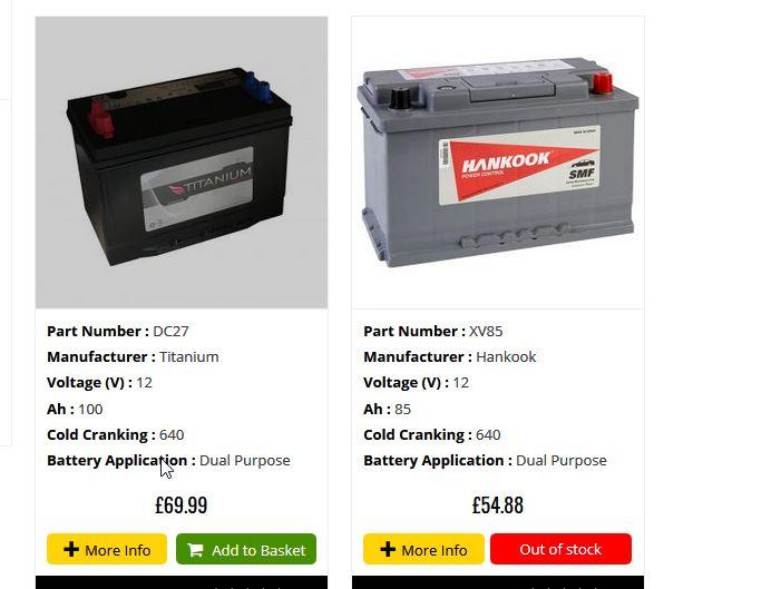

These batteries seem a good price, dual type as well. Obviously their lifetime is unknown at present but they do seem a good buy.
Mike.
I've found them but they are very long, I dont think they will fit in my car but I am going to take some measurements this weekend.

Hmmmm....might just be able to squeeze in the Exide 242mm length otherwise it will hit the radiator pipe.
Ones I looked at are 175mm high, I'll have to prop it up with a thicker 25mm plank of wood to raise it so that its clamps down tight.

Remembered why I did use it, its the cut off feature, the adapter has a cut off point of 11.75v and it does seem to do the job.
