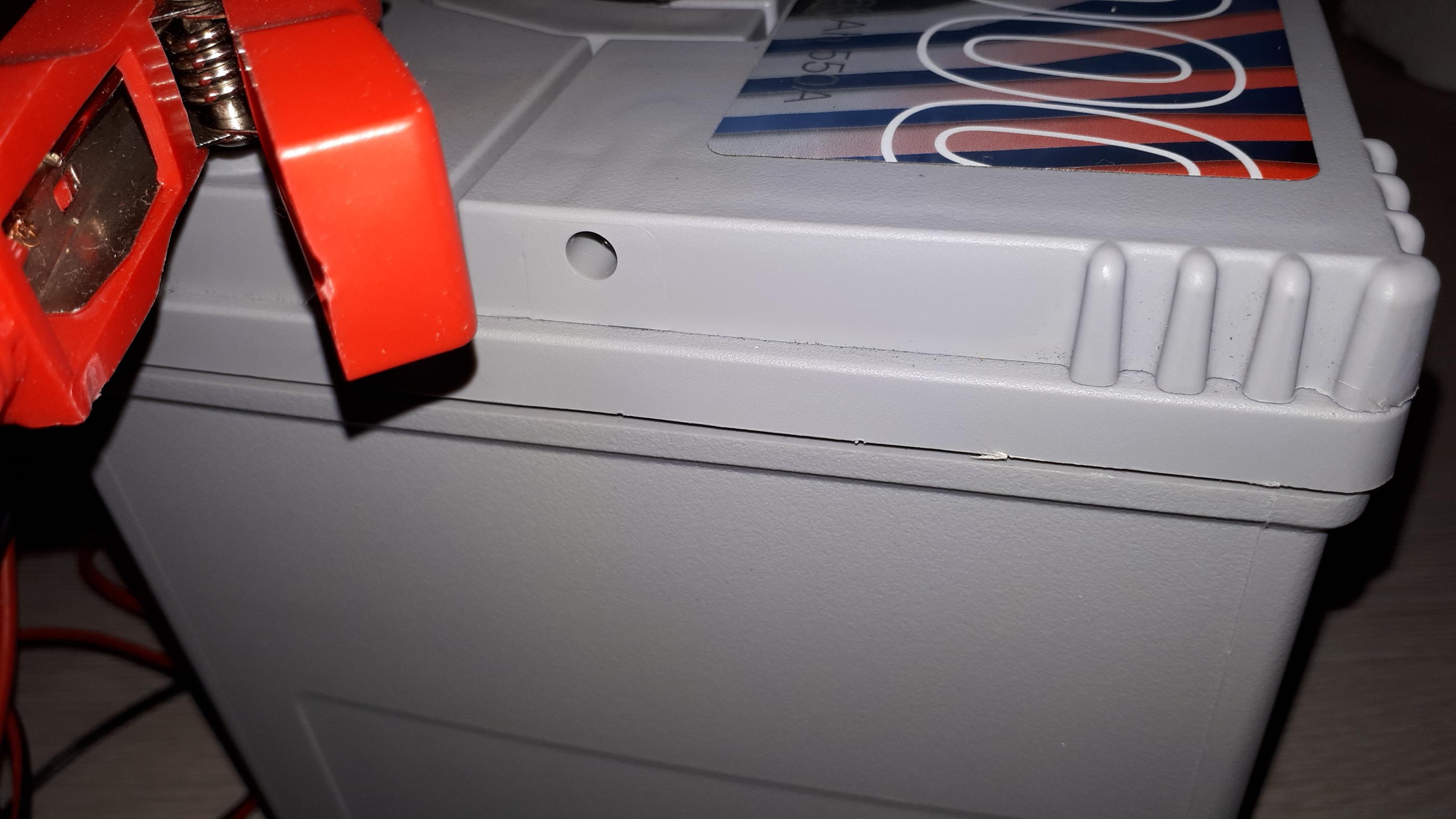

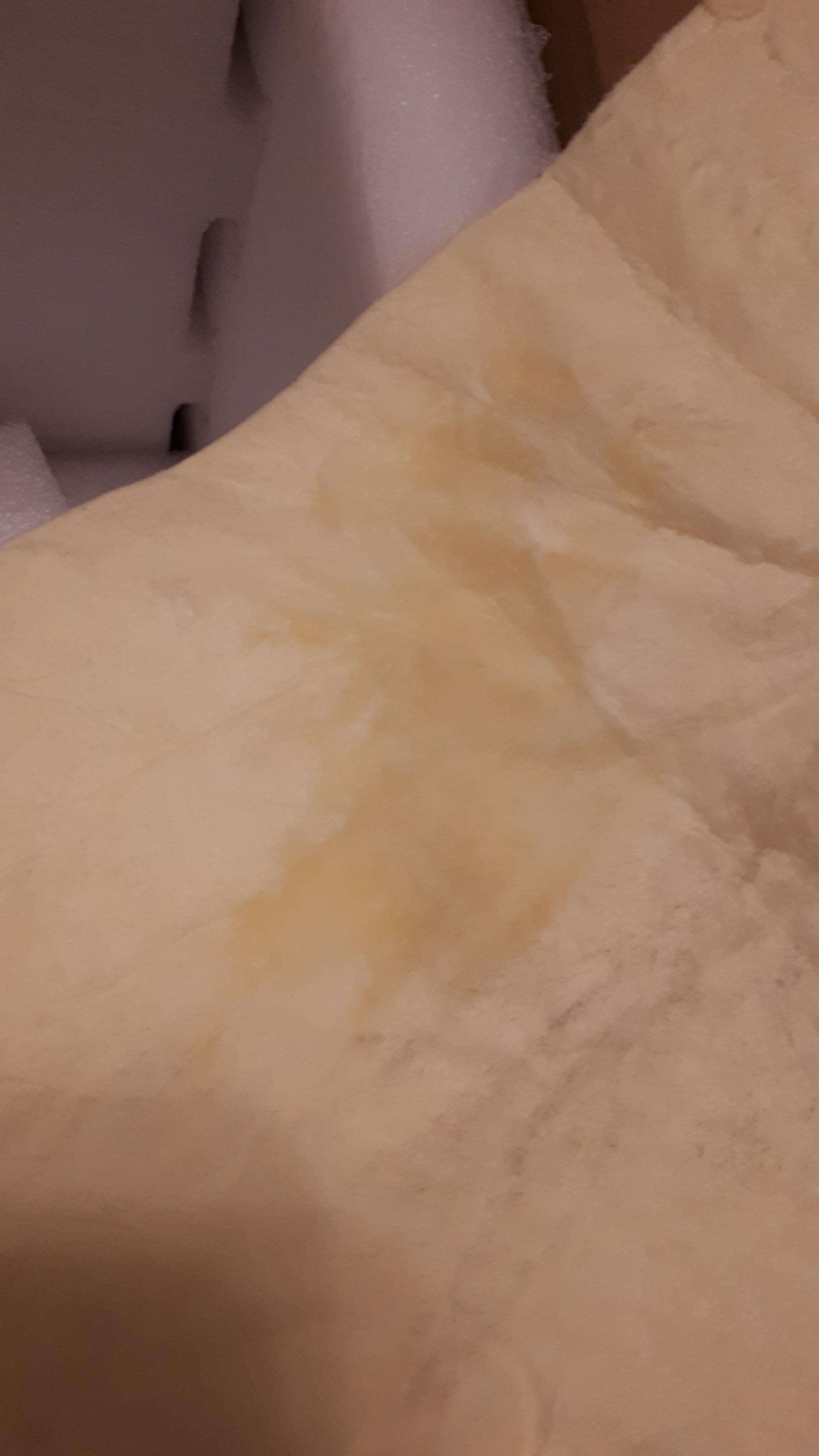

The rag had a wet patch, then noticed there are two holes on either side of the lid/top, and one side had some water. The case doesnt appear to be damaged.
Should I be concerned, or could that liquid have escaped in transport?

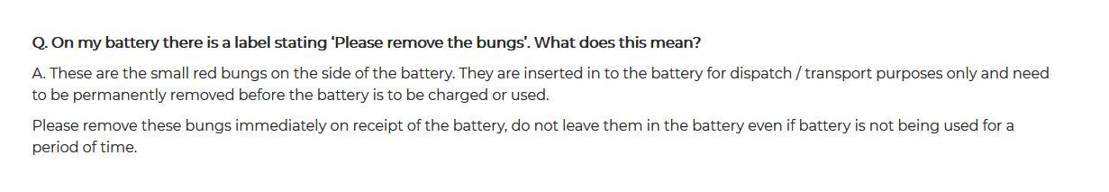

Those holes are vents which normally have a bung in for use during transport to prevent such spills.  - see the quote below.
Assume your Battery does not have any fill up screw tops to it;  most batteries are sealed for life these days.
If only a few ml has come out, don't think i would be too bothered, however if that rag/towell or the cardboard box was soaking wet indicating a big loss then I would contact Amazon for a replacement as it will not last that long if the internal plates are not covered by the fluid.

Thanks guys, I will call Yuasa. There were no bung or anything.
I think it may only be a few ml, it was just a patch on the towel that wet, not sure if its clear in the picture.

Makes me wonder if any more fluid was lost before it was shipped to you ?
Was it a direct Amazon supply or via some market place shop; just that the  'rag/towel'  does not sound like normal packaging so someone packing it may have already had some fluid coming out and put the towel in to try and prevent/contain any more ?
Think a call to Yuasa would be prudent.

I called Yuasa, didnt fill me with confidence, I asked if all Yuasa batteries leave with a bung, guy gave me an hesitant 'Yes'.
Asked about the leakage, first said I need to talk to Amazon if I was concerned, then asked if the indicator was green, which is, so then he says 'it should be fine'.
I weighed the Battery and its 15.75kg, spec says 15.7kg, taking into account the tolorance of the weighing machine 0.2kg, that 15.55kg.
So I think the Battery is OK. Or I could ask Amazon to replace it but then there is no gurantee the replacement will have a bung.
