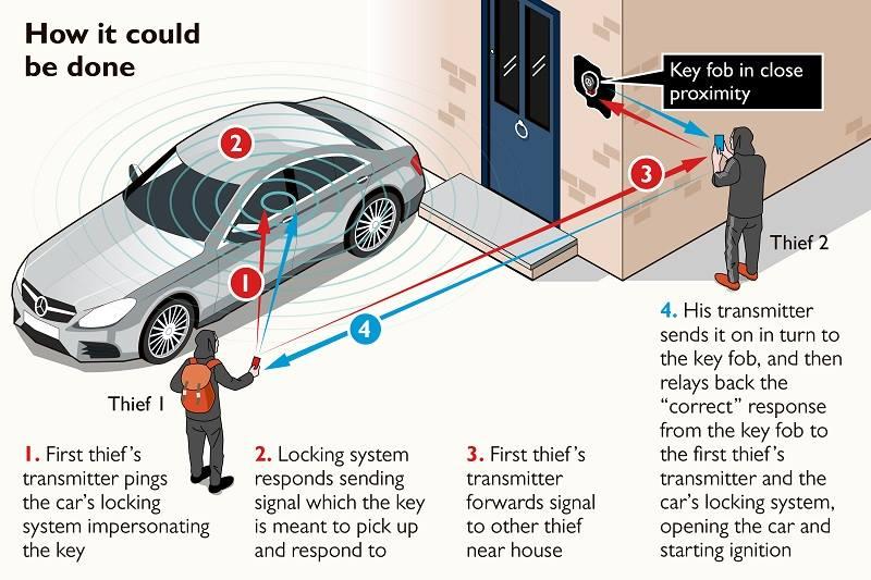

Can I ask if this kind of car / keyless fob system is susceptible to key fob theft?
As attached.
The majority of cars with keyless entry are susceptible to both the relay type and OBD port theft.
Protect the keys when in the house using a Faraday key bag and/or invest in a good quality, approved steering wheel lock.
I think that on your car you may be able to disable the fob sending a signal by a series of button presses. This would prevent a relay attack as there would be no signal to relay.
However, pretty much all modern cars [unless fitted with additional protective device(s)] can be attacked through the OBD port via a laptop although that may entail them smashing a window to gain entry to access that.
