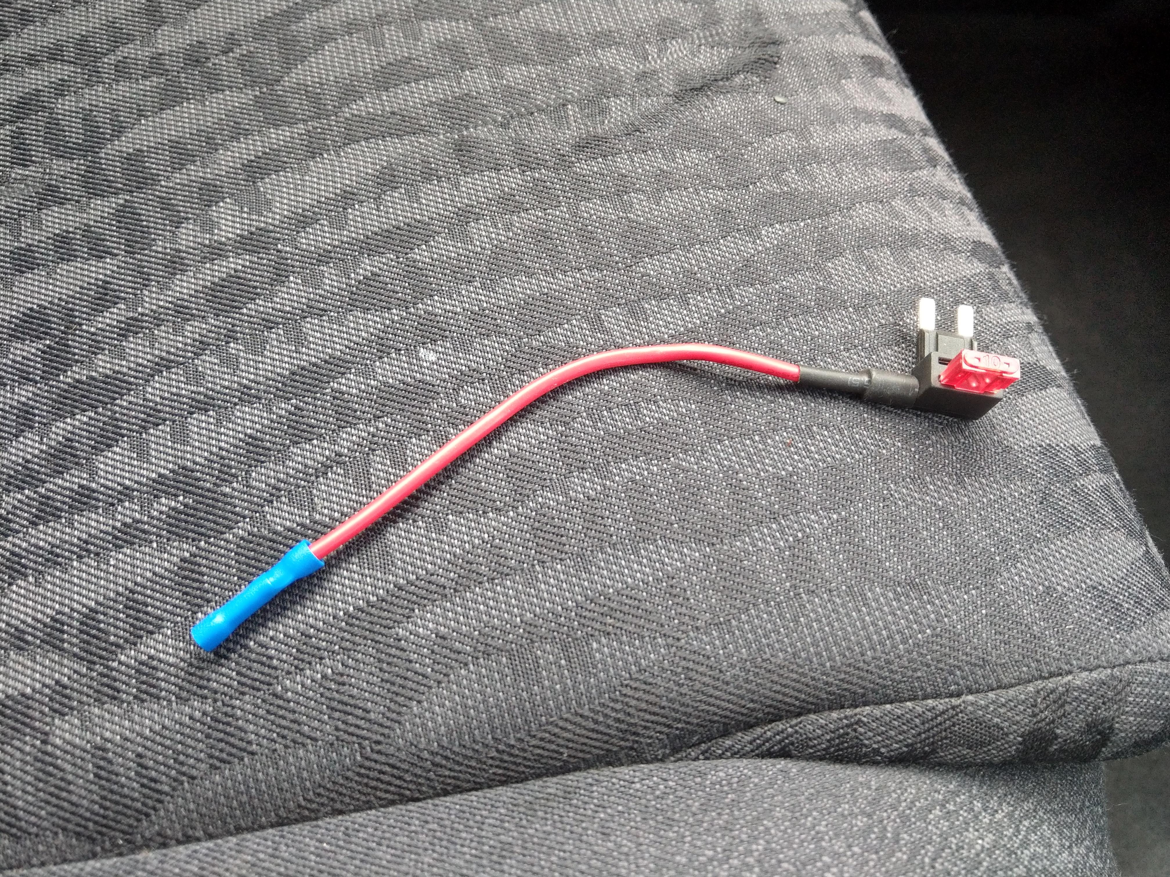

You should have some fuses on the left side of the car, next to the lever used to open the bonnet. You can use the piggyback fuse to get the power needed from there.

You can get to the fuse box from behind the glove box, pop the damper off the left side of the glove box and wiggle it out and fuse box should be right in front of you. My Dashcam is piggy backed off a fuse as you described. Take a look at the diagram in the owners manual to find something with the same amperage that powers on with ignition and use that one.

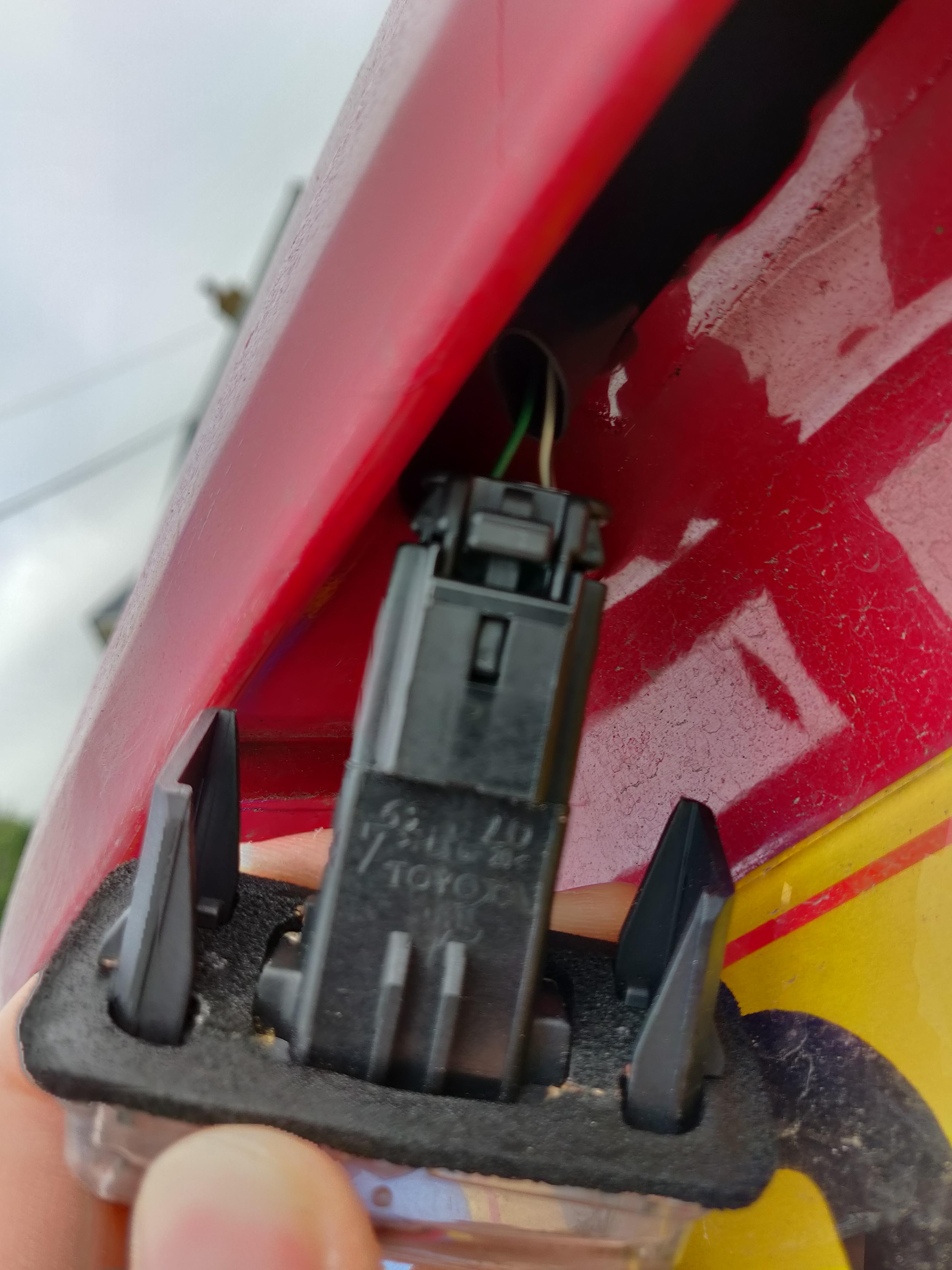

Pop the light out first then unplug it, like this.
Ahhh do you have to squeeze from the inside on those two outer prongs?
Yeah squeeze gently and wiggle
Sorted 👌 will give it a go in a bit.

I used a piggy back fuse for footwell lights but put the negative into the switch on the b pillar that controls interior lights so they turn on when you open the door and turn off when you close it

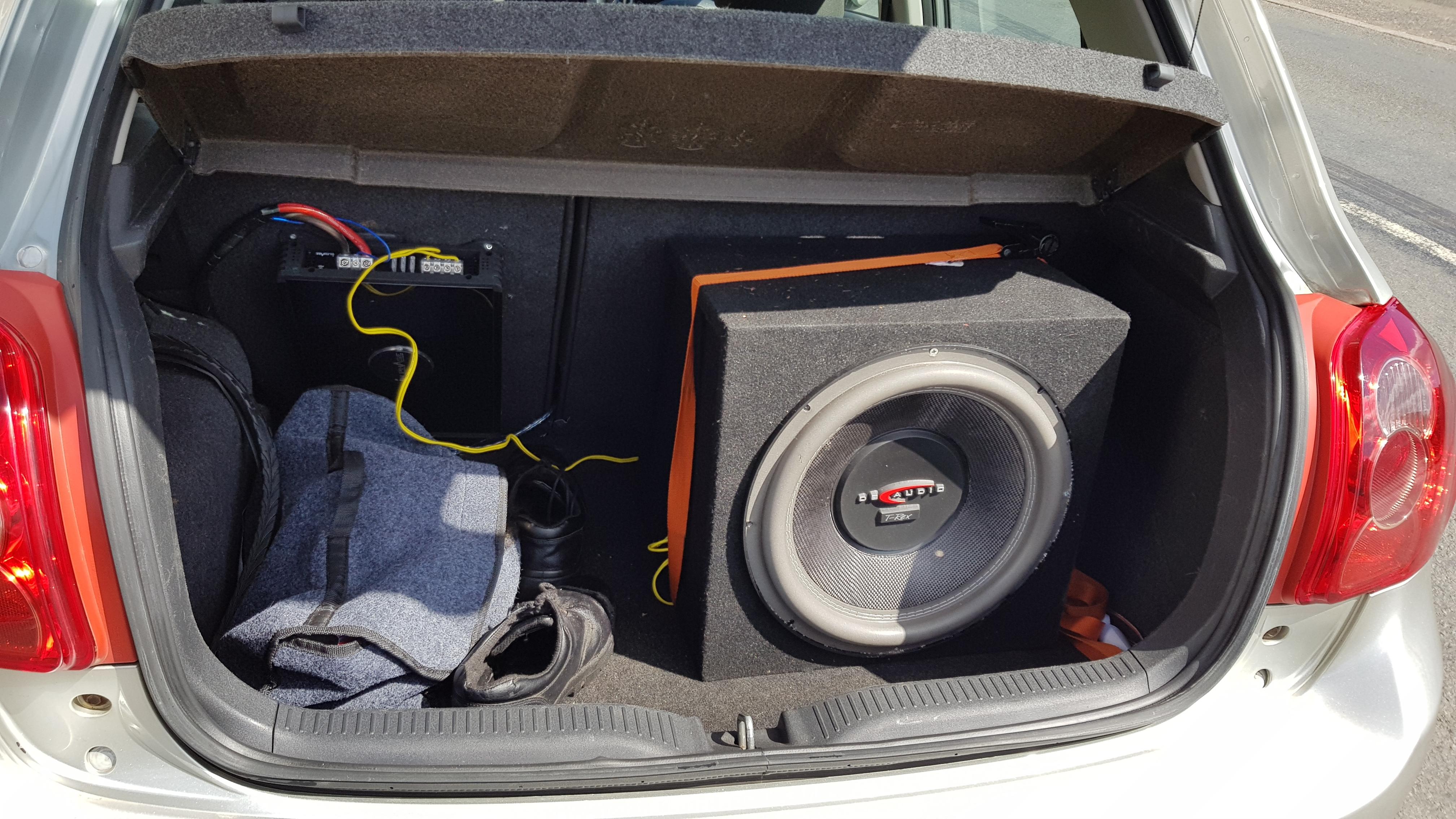

So sub is now fitted new stereo led lights and interior lights with neo chrome gear stick. Also dash cam hard wired up and led footwell  lights are next on my to do list

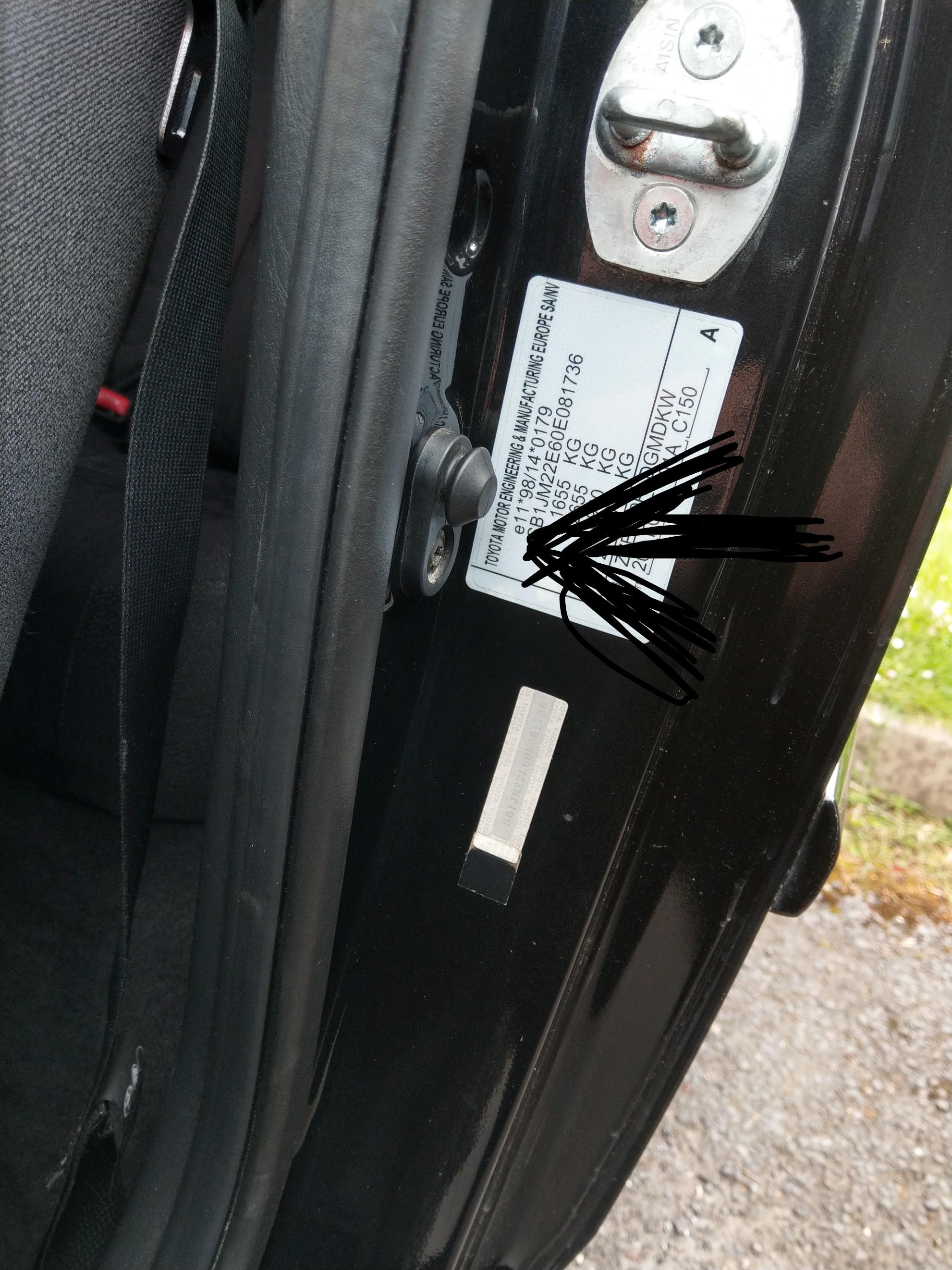

Have any photos of this wiring you've done ?
Positive went into a fuse tap and negative went into the b pillar connected to the back of the black thing you see with arrow pointing to it
Hope that helps
