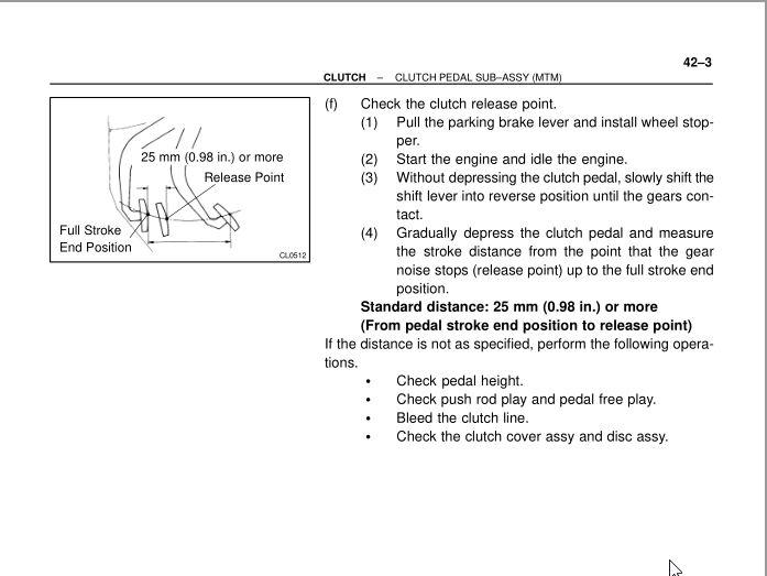

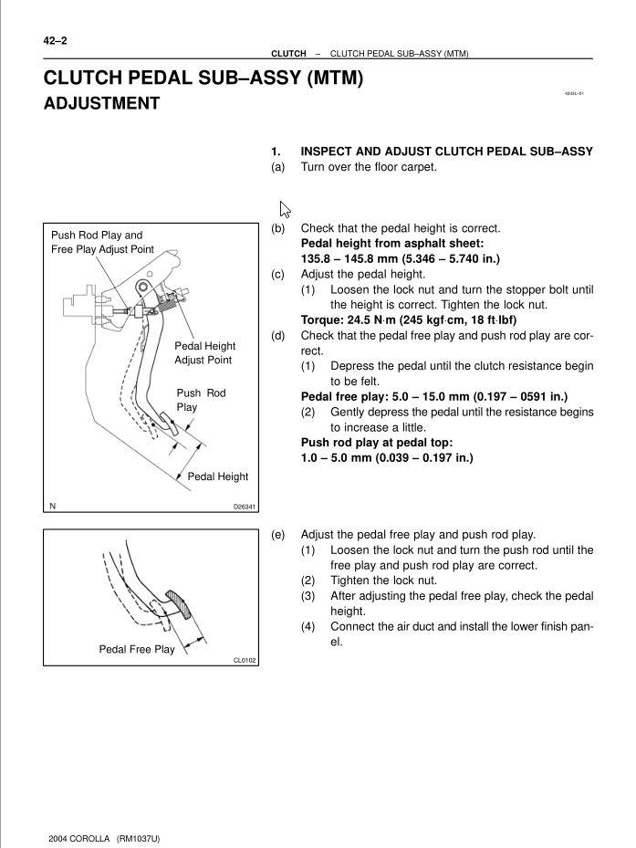

Never adjusted the pedal or heard about any one needing to do it, but the pages below from a US corolla manual might help, would think the routines the same, the measurement seem to agree with the UK Haynes manual.
Removing the cardboard lower cover helps along with a visit to a back and neck physio afterwards :laugh:

If all dry, then its probable there's air in the system. You pump the pedal few times, compress the air, and clutch works, kinda.
Do not adjust the clutch pedal until you bleed the clutch and make sure there is no air in the system. A bit of transparent pvc tubing pointed upwards is of great help, as it ensures that no air enters the system that way, since there will be oil in there stopping it.
You can adjust the clutch as you wish, but remember this, there always must be a bit of freeplay in the clutch pedal, say 3 mm or more. If there is no freeplay, it means the clutch is always a big engaged, which causes extra wear on all the components involved.
