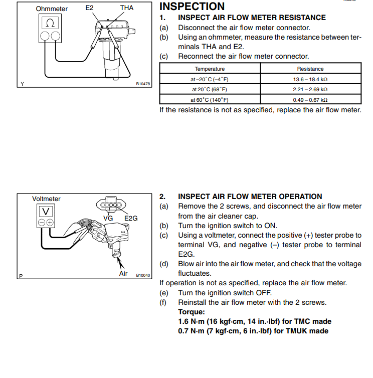

Before playing 'parts darts' you'd be best to get some diagnostic software and a lead to get some diagnostic data off the car - either a cheap OBDII reader or a version of Toyota Techstream (check out ebay).  There are literally 1001 things that could throw out your emissions..
As mrfixer says your car will run without a MAF connected, when disconnected the car runs on a "base" map ignoring the missing data.
Toyotas diagnostic:
