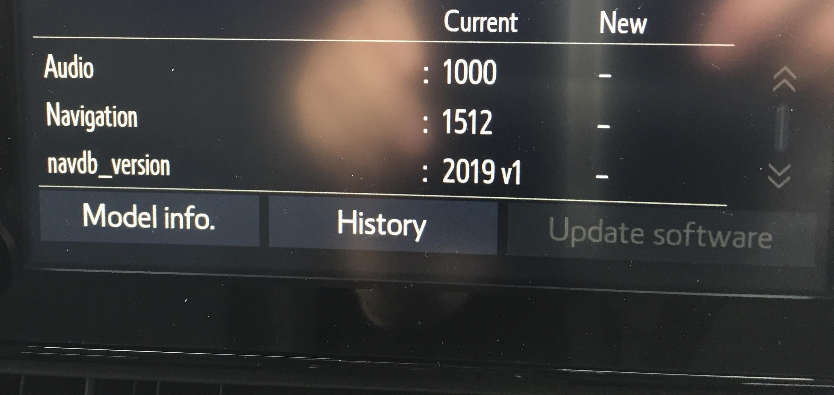

Screenshot from my RAV4 Dynamic delivered 10th May.
Not done any updates myself so assuming it came delivered with these versions
