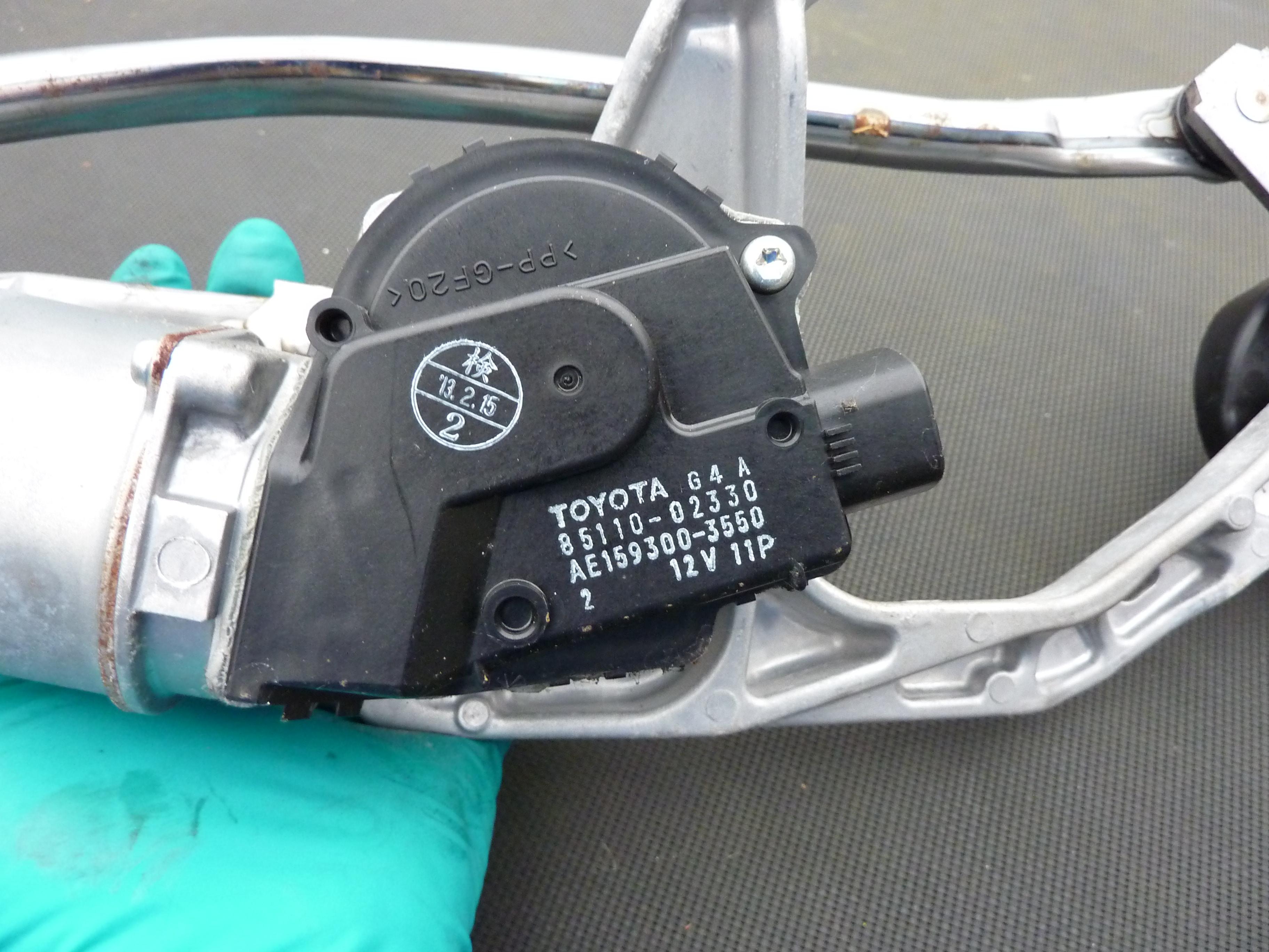

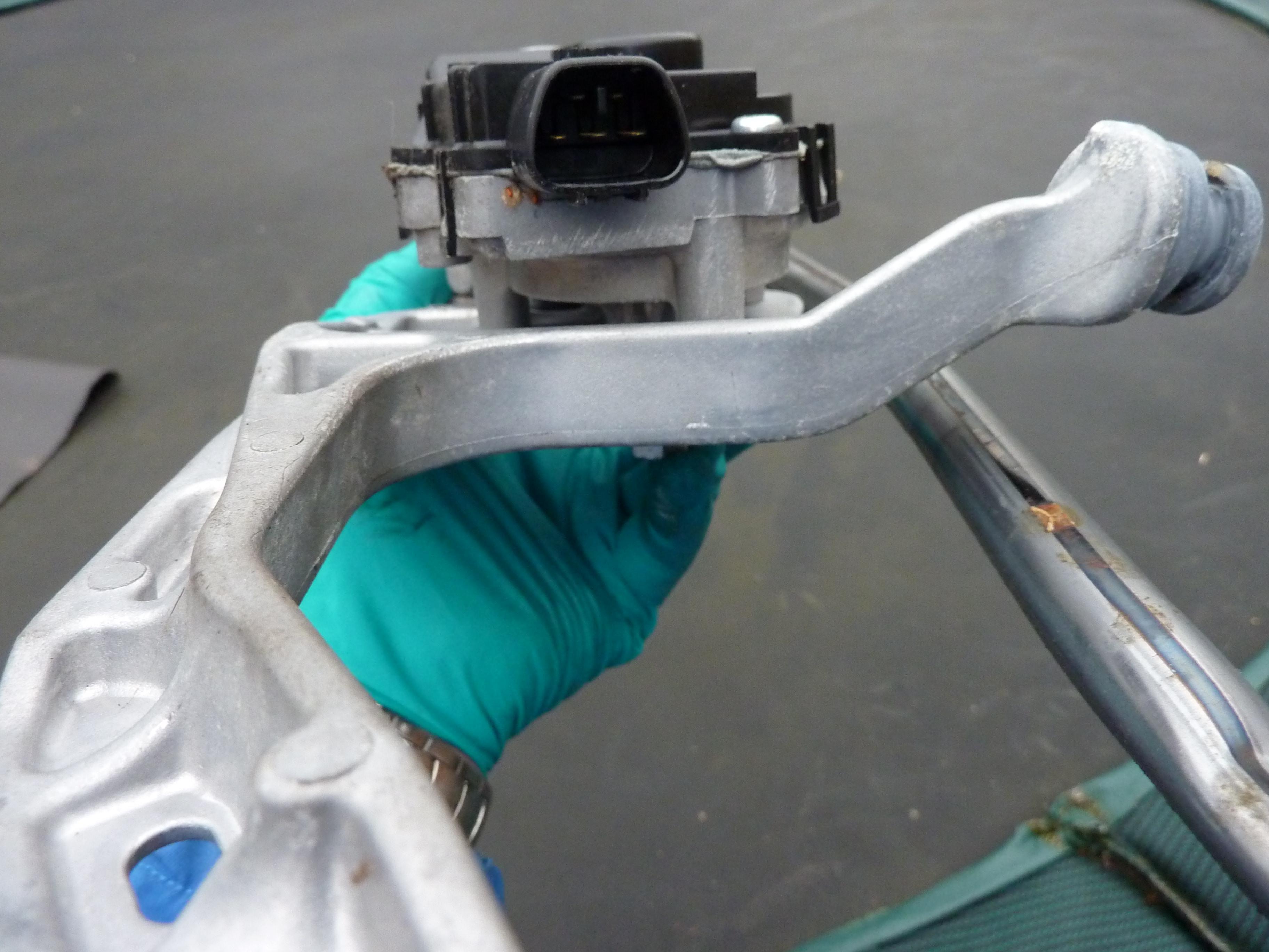

If your wiper motor is similar to the 2012 -2018 Auris, then it will look like these pictures.
P1150724.thumb.JPG.59f03bcb2c52421459252ddffa74e7f6.JPGP1150725.thumb.JPG.f269424f4573cfb91aec96df5fcf1fe6.JPG
If you zoom in on the second picture, you can see that it has some sealant on its top cover,  But also a screw and some built-in clips.
If you were keen then you might get the cover off without damaging it.
This link might give some extra insight:
https://www.popularmechanics.com/cars/how-to/a6226/how-to-fix-your-windshield-wiper-motors/
I don't think you'll find a separate switch that you can replace on its own.  It'll be more likely needing a clean up and grease, if the wiping contact hasn't worn away.
