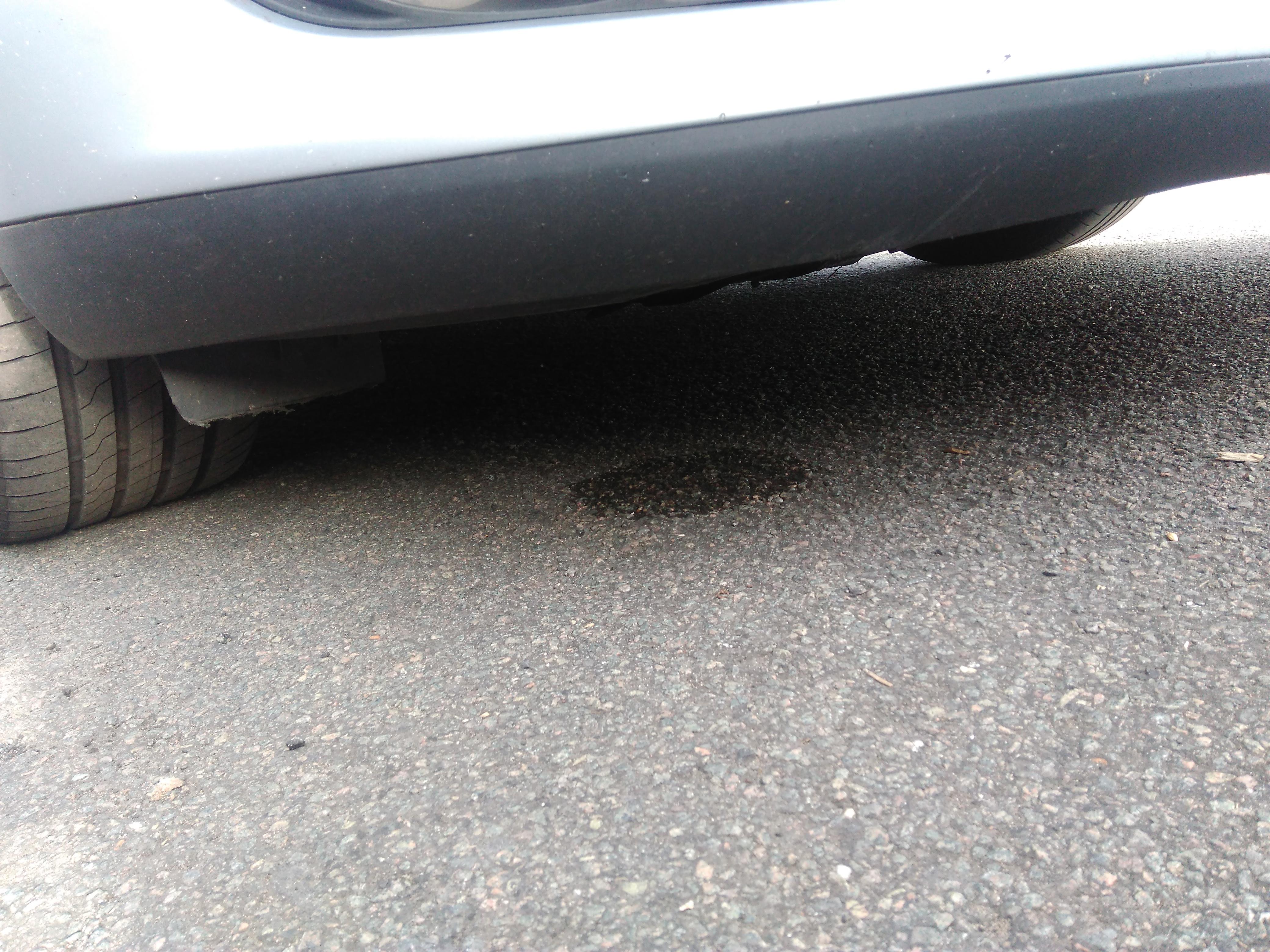

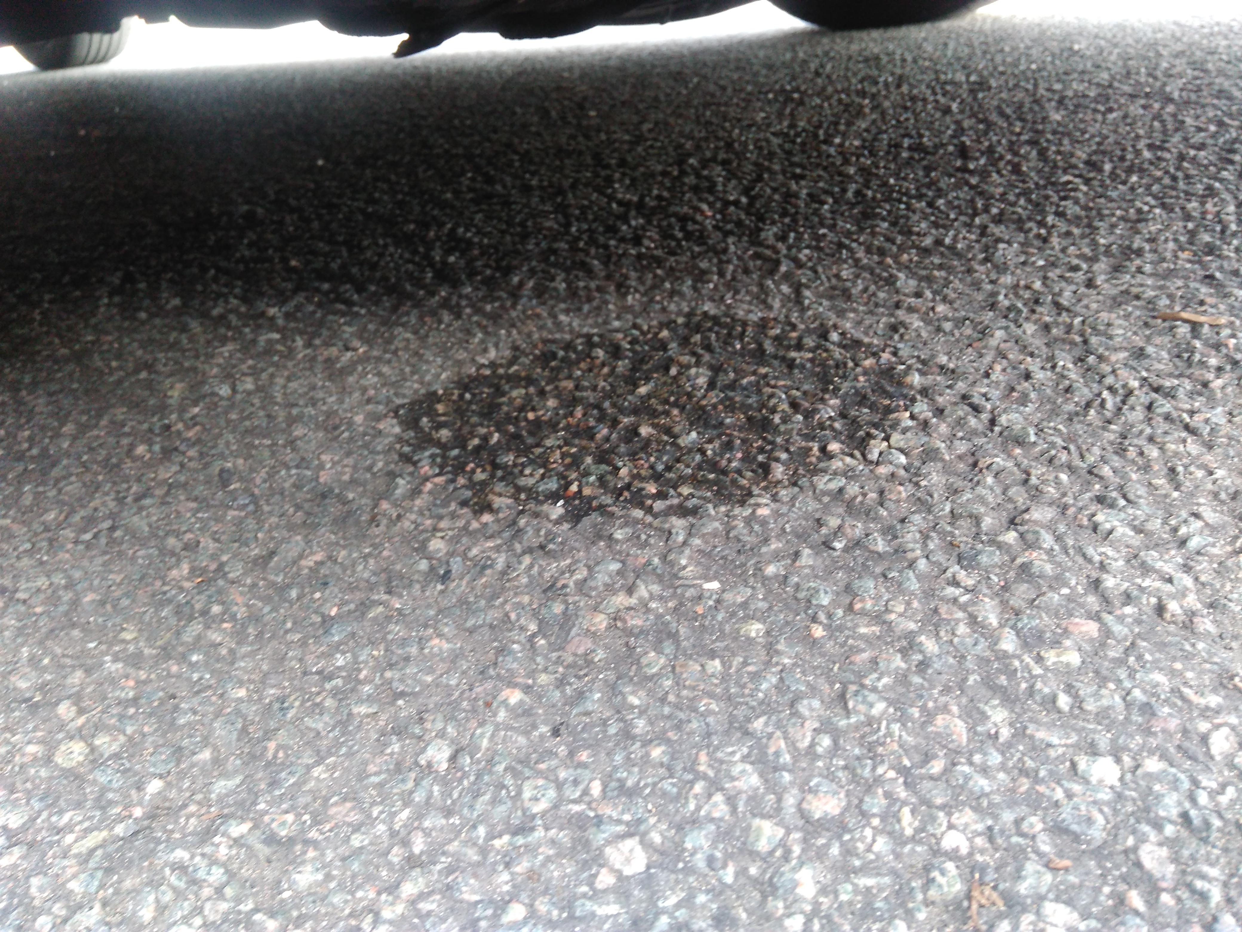

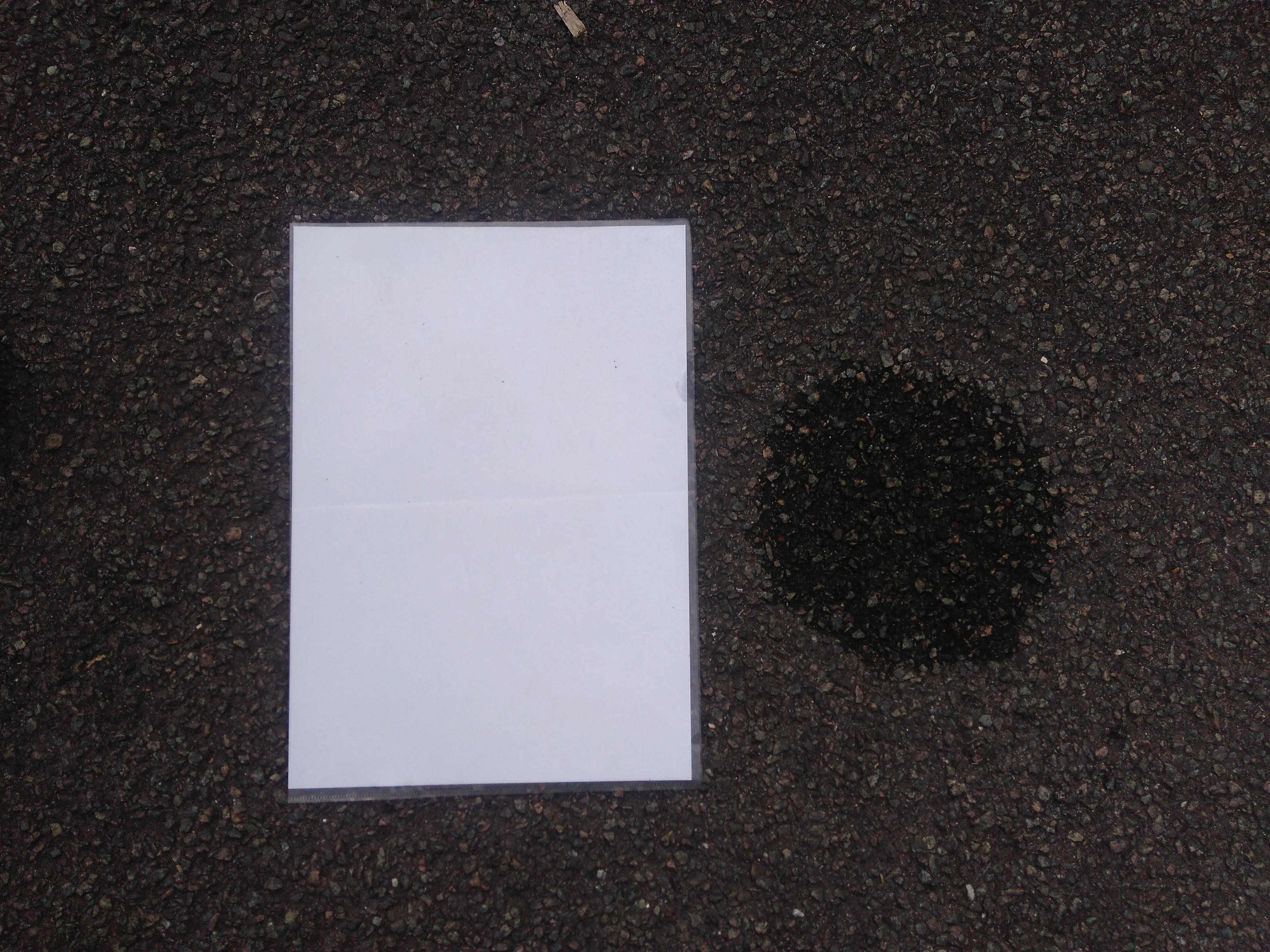

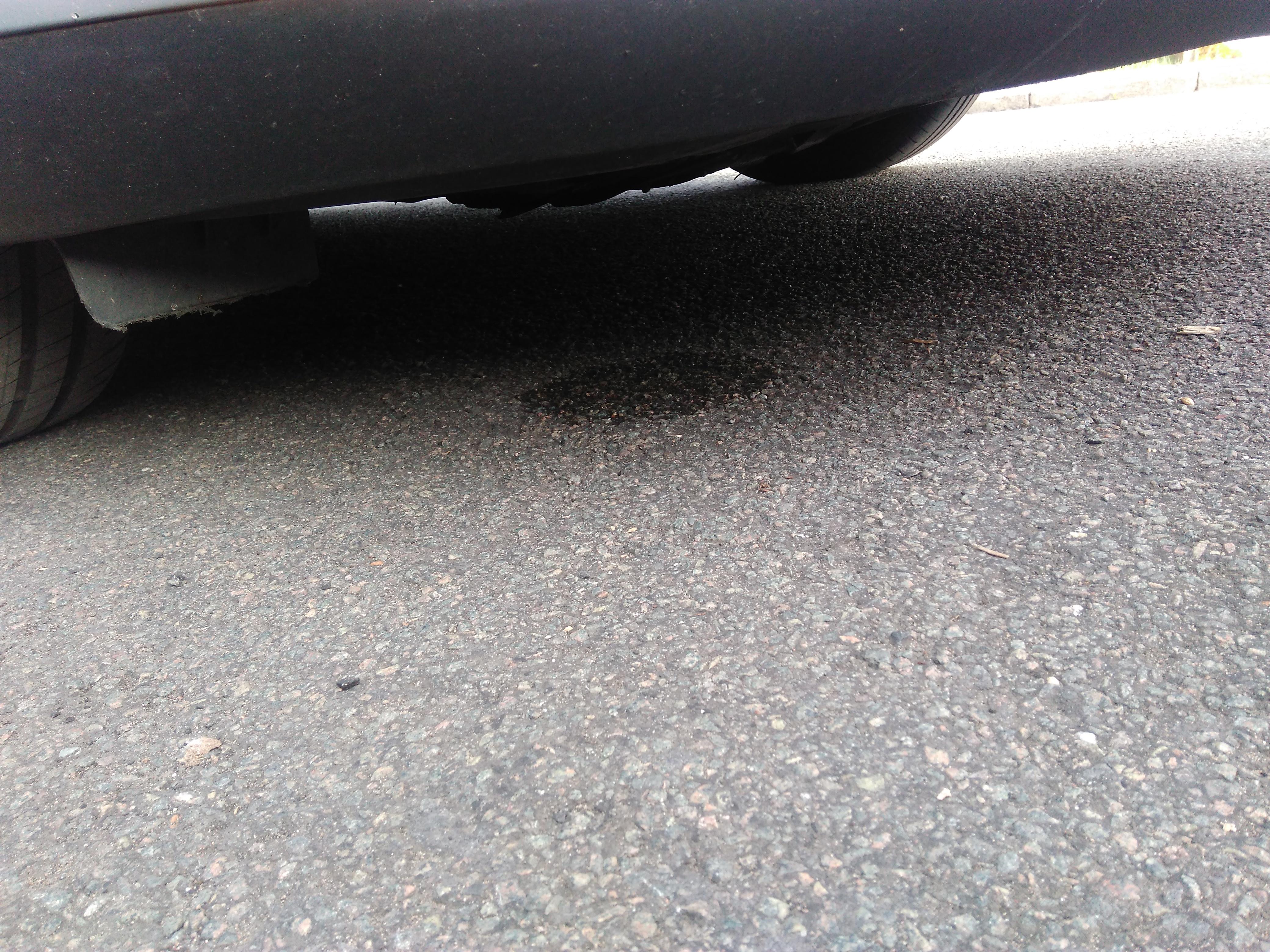

A couple of pictures of the wet patch....it's location.....and it's size (that's a piece of A4 paper)
That's too far away from the engine to be the water pump, more probably a lose or cracked hose, or maybe a radiator leak in a corner.
Nice one 🙂 - It's probably going to be the radiator then.....the more expensive option!!
Just had a look at GSF Car Parts and a radiator is about £135 and Water Pump is £45.....This gives me a guide for parts and add a couple of hours labour and I have a rough price to prepare my wallet for 🙂
It could also be just a faulty hose that's connected to the expansion tank, the pipes from it are the closes in location to what you posted.
If it was the radiator, the car would be loosing more fluid since the system gets pressurized once the car is running, there is some plastic underneath the radiator that could be diverting the water that way.
Putting some cardboard underneath the hoses, and some underneath the radiator should help identify the culprit.

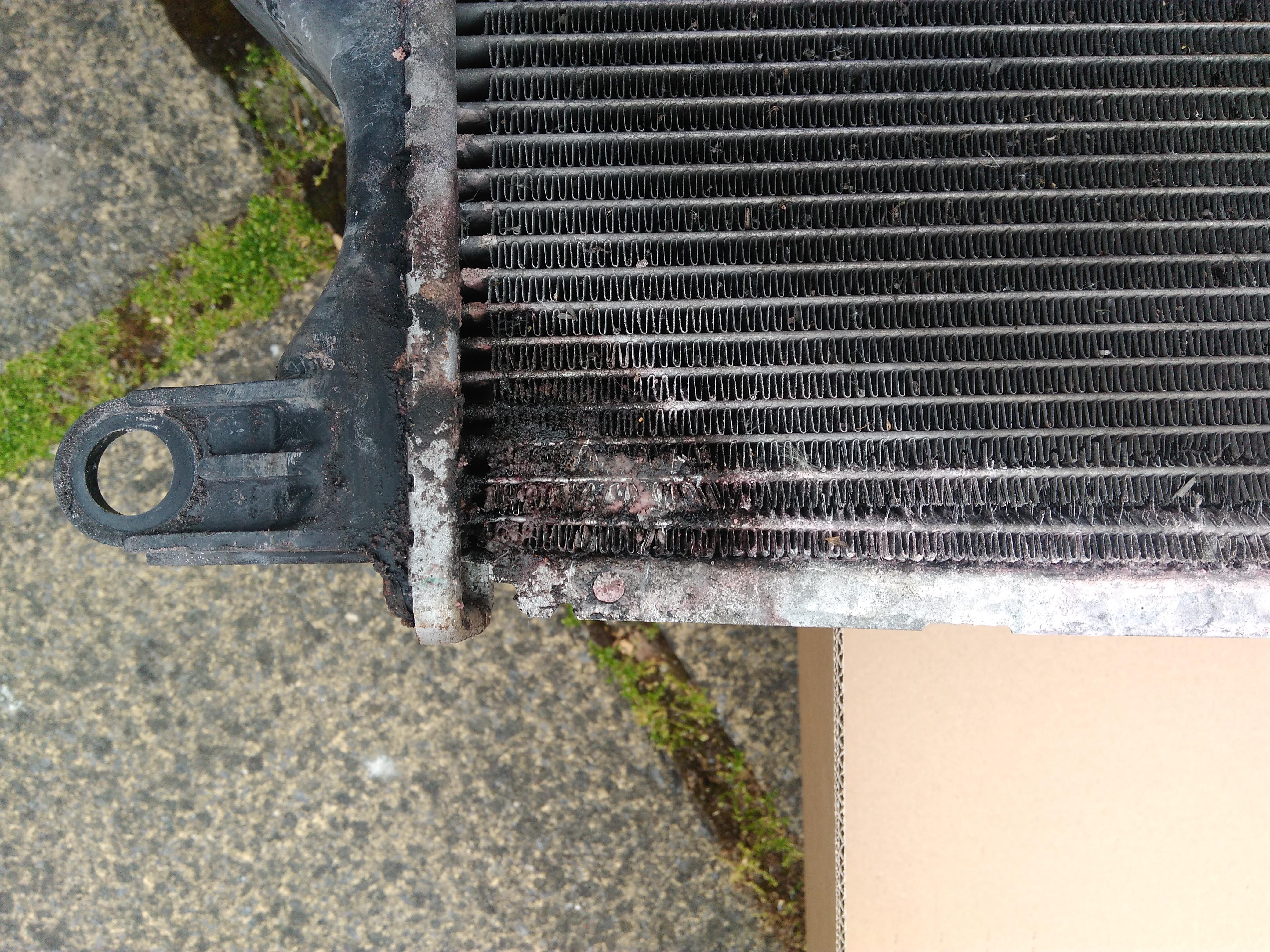

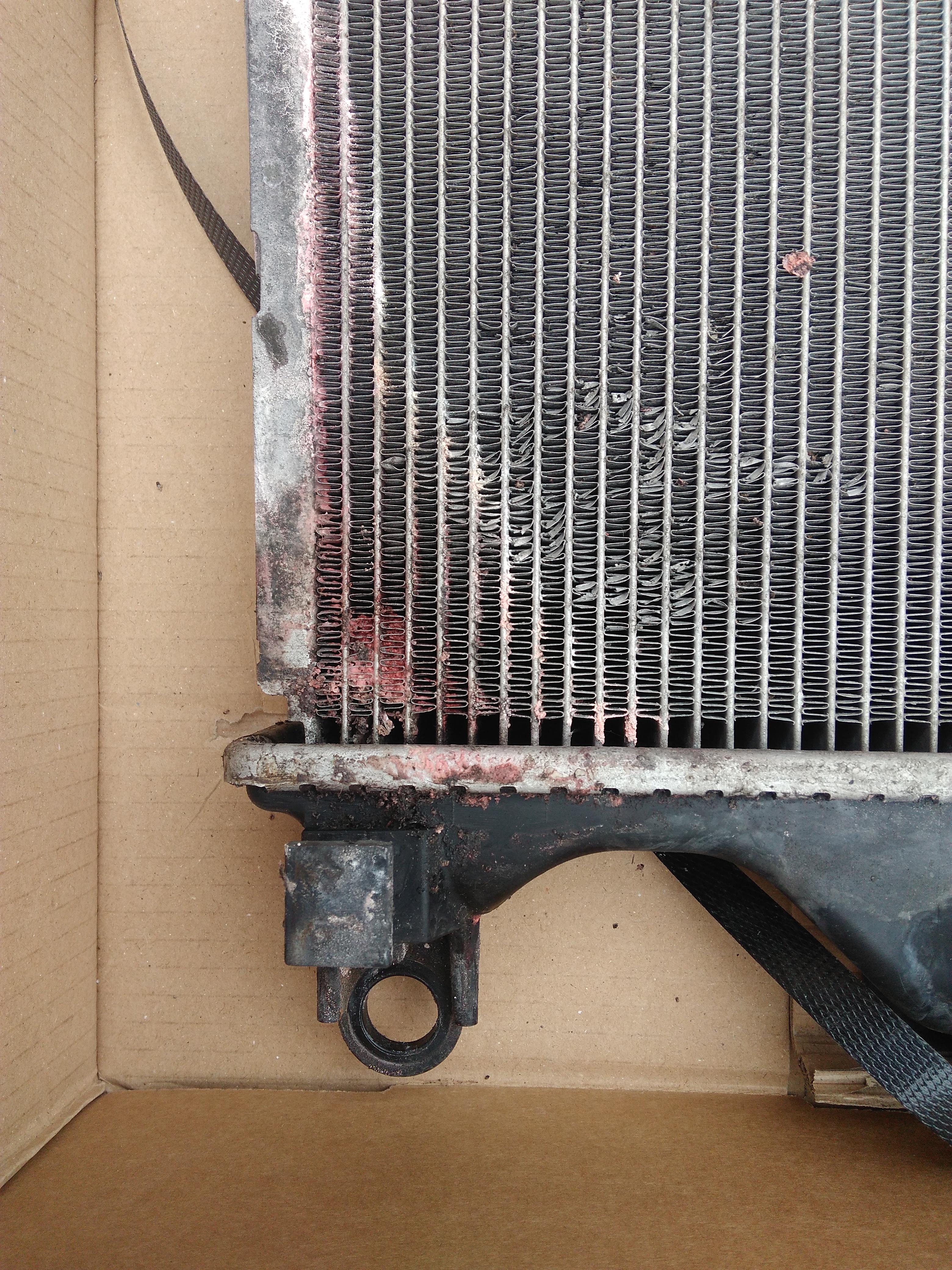

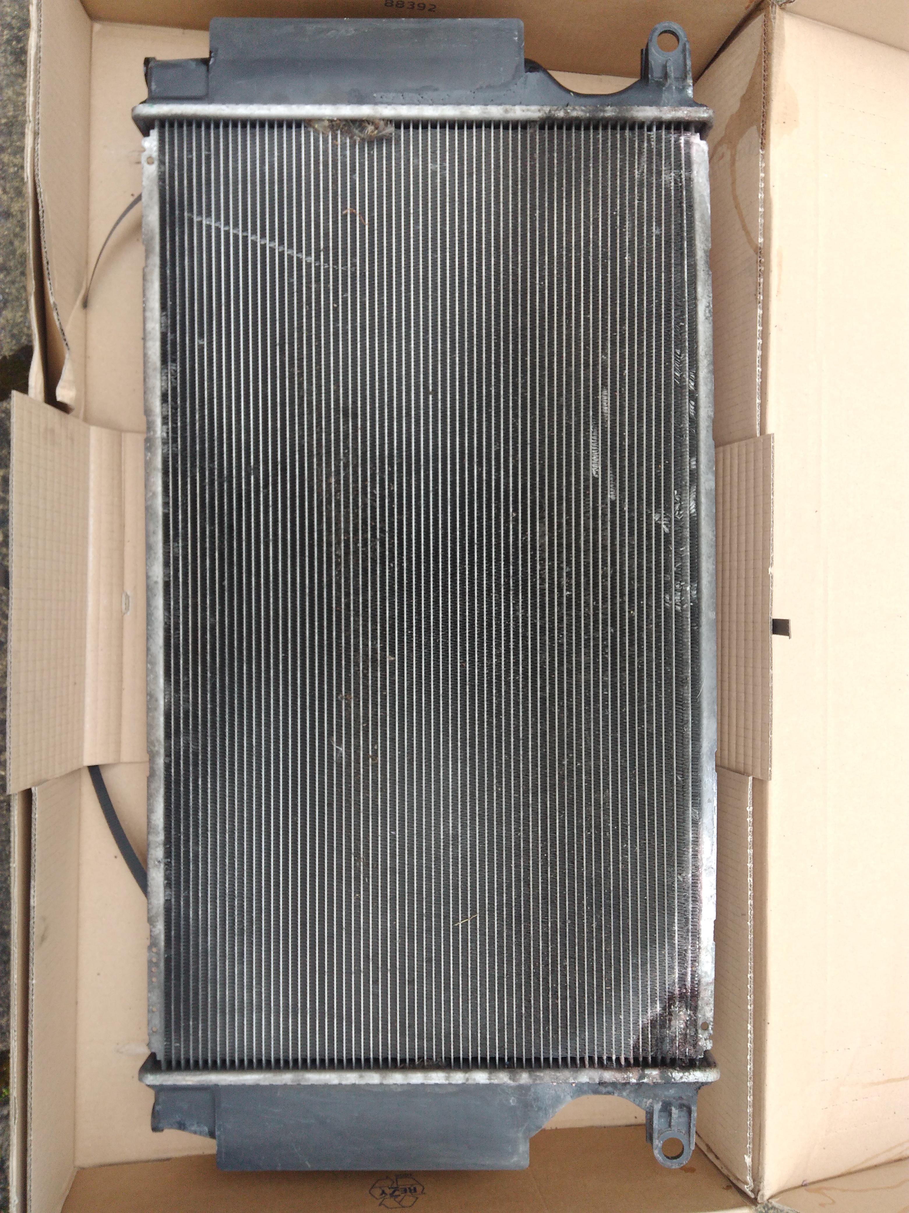

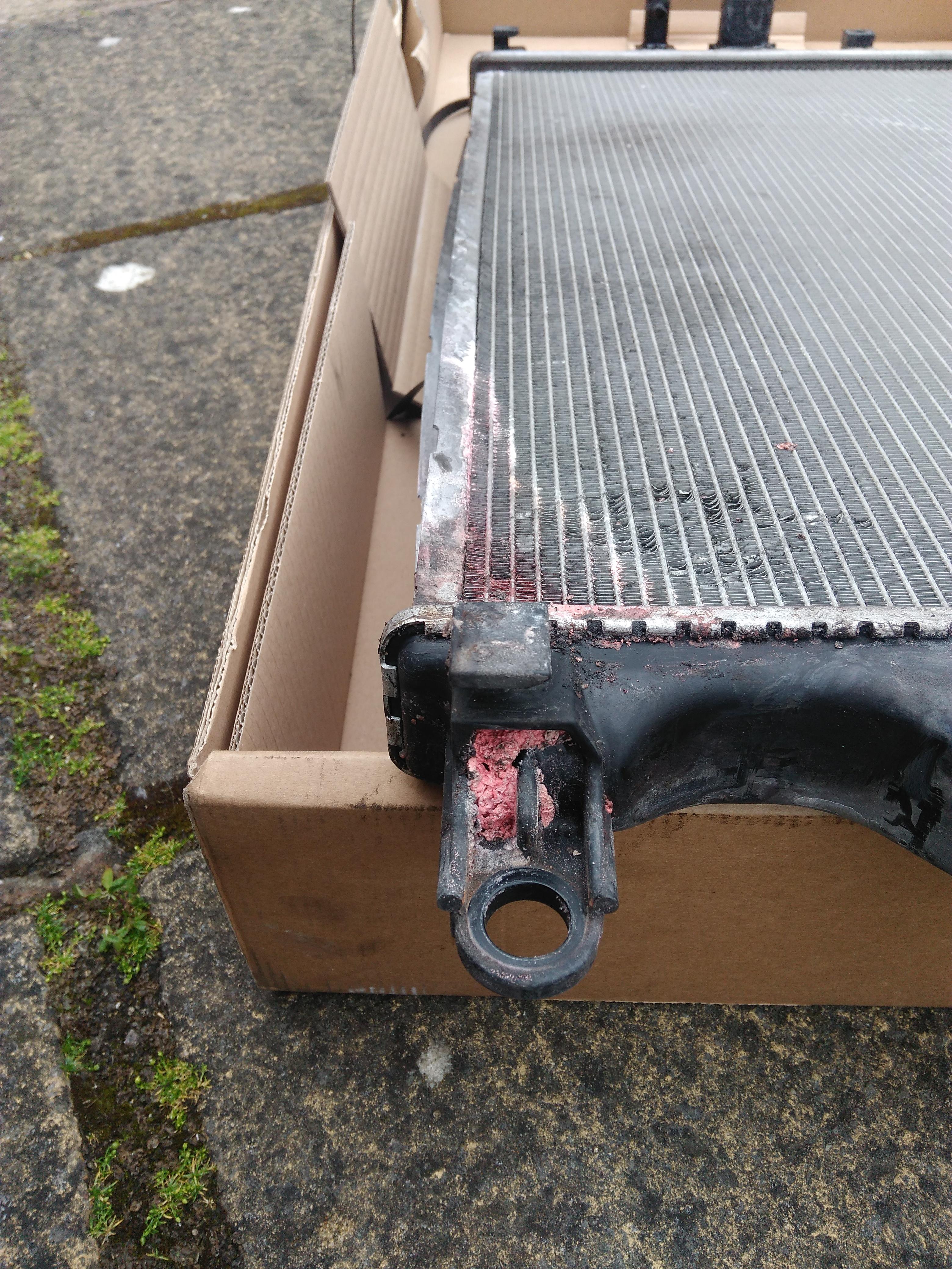

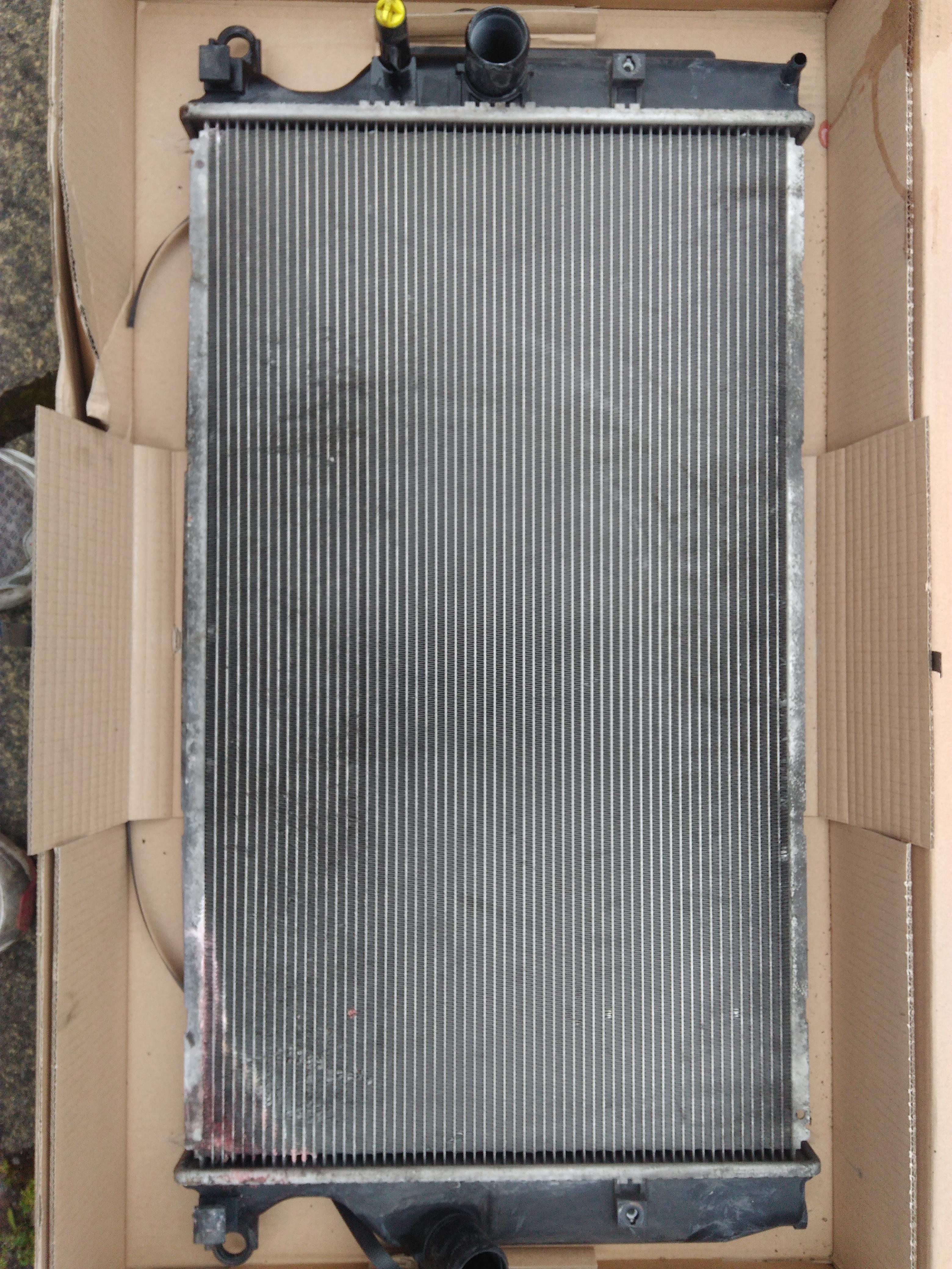

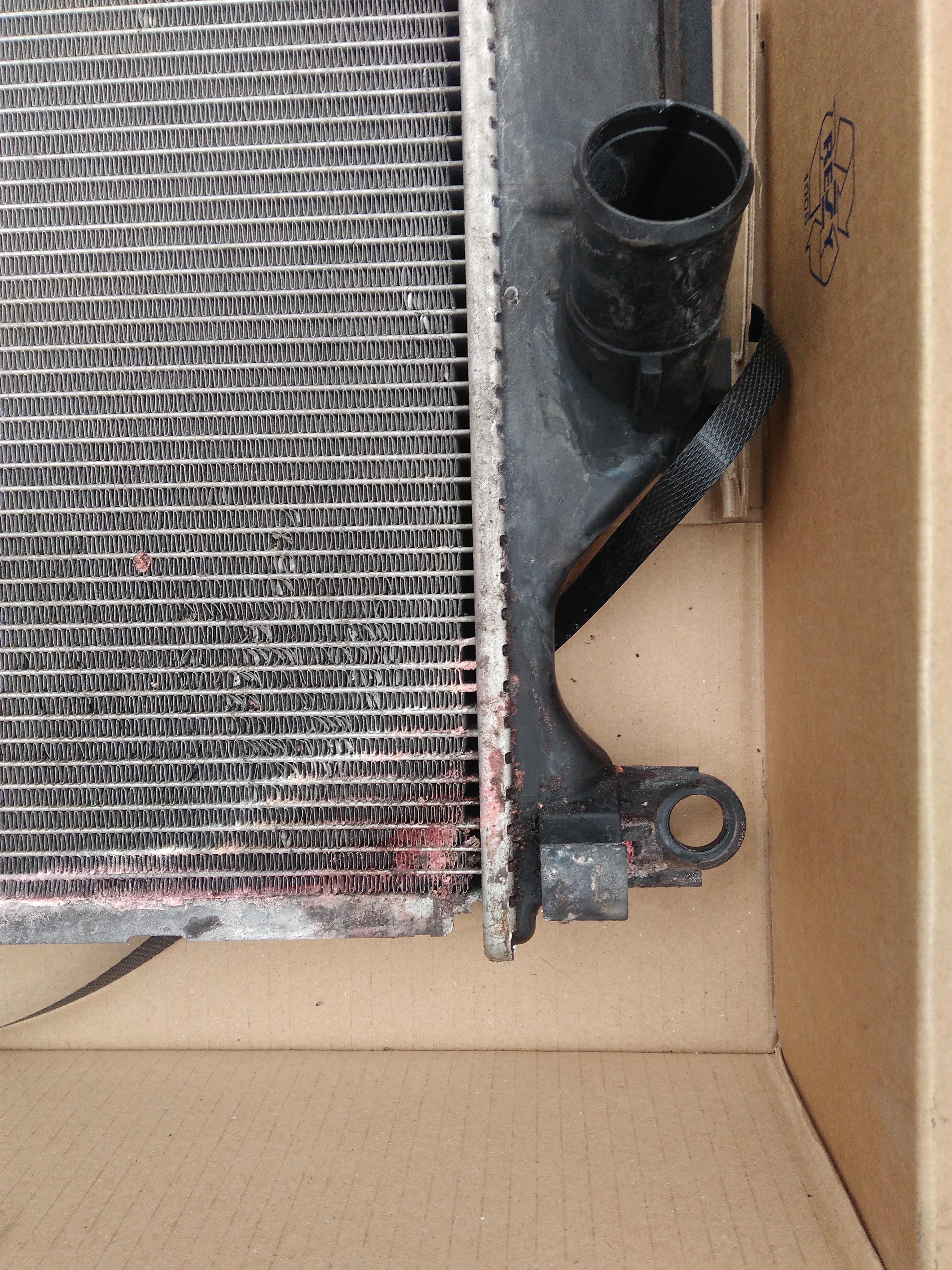

So, it appears that it is the radiator - There is a small crack in the bottom corner......... Garage has one on order and it's being done next Thursday. Just got ensure the coolant is topped up until then.
My grease monkey does say it's a bit of a phaff on the Auris as quite a lot of stuff has to come off to get the radiator in.
Has anyone out there is Toyotaland that has ever replaced their rad..... how painful was it?
Hi All
Just closing the loop on this issue. It was the radiator and it had gone in the corner. It's been replaced and I think I got a bit of a deal as the front end has to come off the car and quite a lot of stuff nuts unbolting to get the rad out. It came in at £220 (Radiator / Labour / Anti-Freeze). The pictures are the old rad that was taken out
