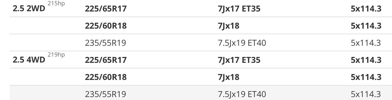

Yes, I tried that site but the offset figure is missing for 18” wheels. 17” is ET35 and 19” is ET40

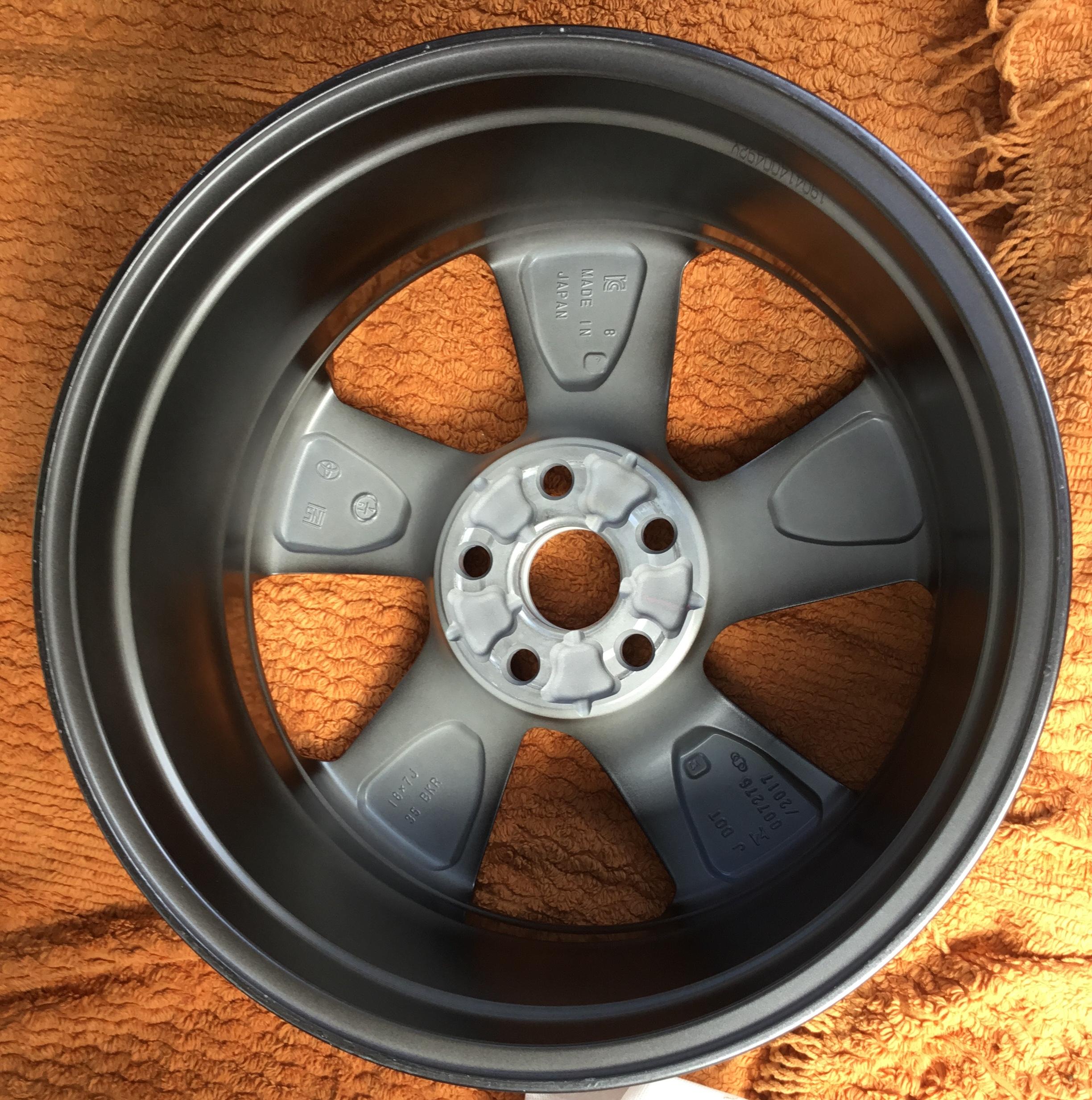

Does anyone have a full size spare wheel as the offset may be stamped inside the rim. I want to buy a full size spare but maybe not a Toyota wheel as it’s only the spare. I want to ensure I buy the same offset as the road wheels.
I looked at my new alloy wheel for my 2019 RAV4 and stamped inside the rim on the back of a spoke is 35 BKR so I guess the offset is 35.
