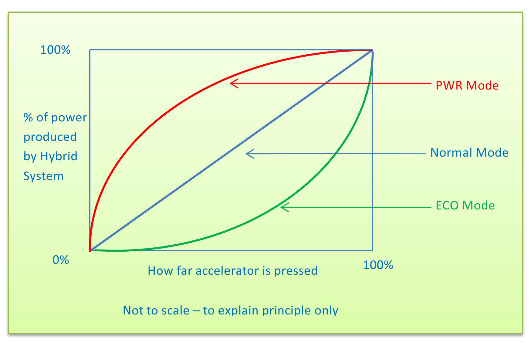

All three modes will give full power if the pedal is floored.  The attached diagram shows roughly what going on depending on how far the accelerator is pressed.
