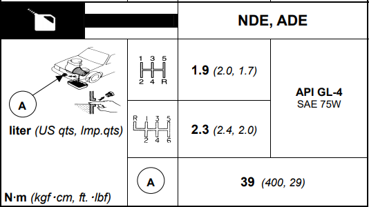

a 75w85 will be too thick when warm/hot Toyota specify a mono grade LV 75 Gear oil
That's the right gear oil tho
That's the correct gear oil according to the hand book
Sorry all I have used 75w 90 comma oil semi synthetic
Not sure why Toyota Ireland would specify anything different, Toyota have used a mono grade 75w since around 2005/2006 and the attachment was snipped from Toyota's service data sheet 5 minutes ago.
I have used 75w 90 grade oil.. If found the bottle.. sorry about that I was guessing what I used
Now knowing  the oil is too that thick, I assume you will be getting it replaced with the correct oil. You got a choice of Toyota or the comma 75w-80?

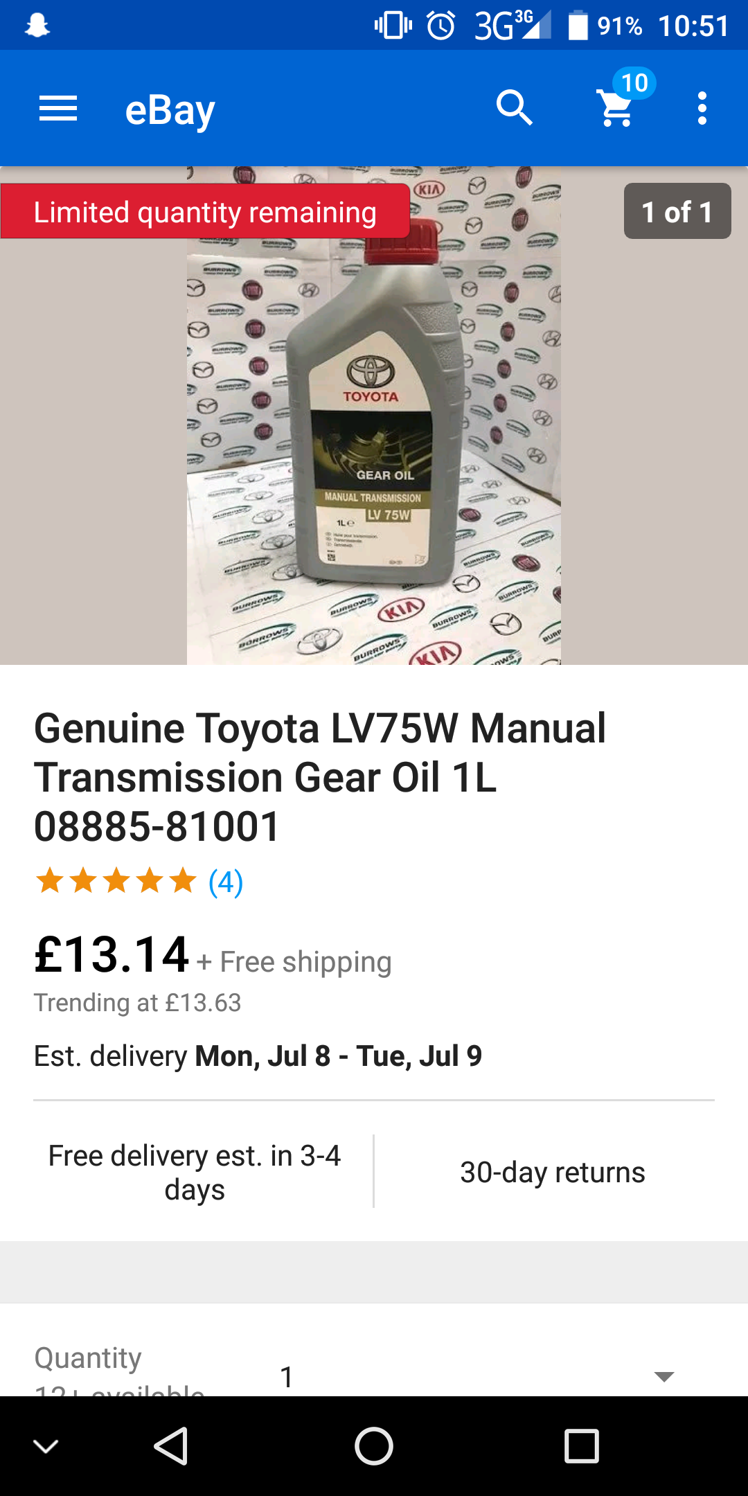

I'm going to try the Toyota own brand.. what do yous think?? Lv75w??
Yes I would go for that and try it better than the comma.
