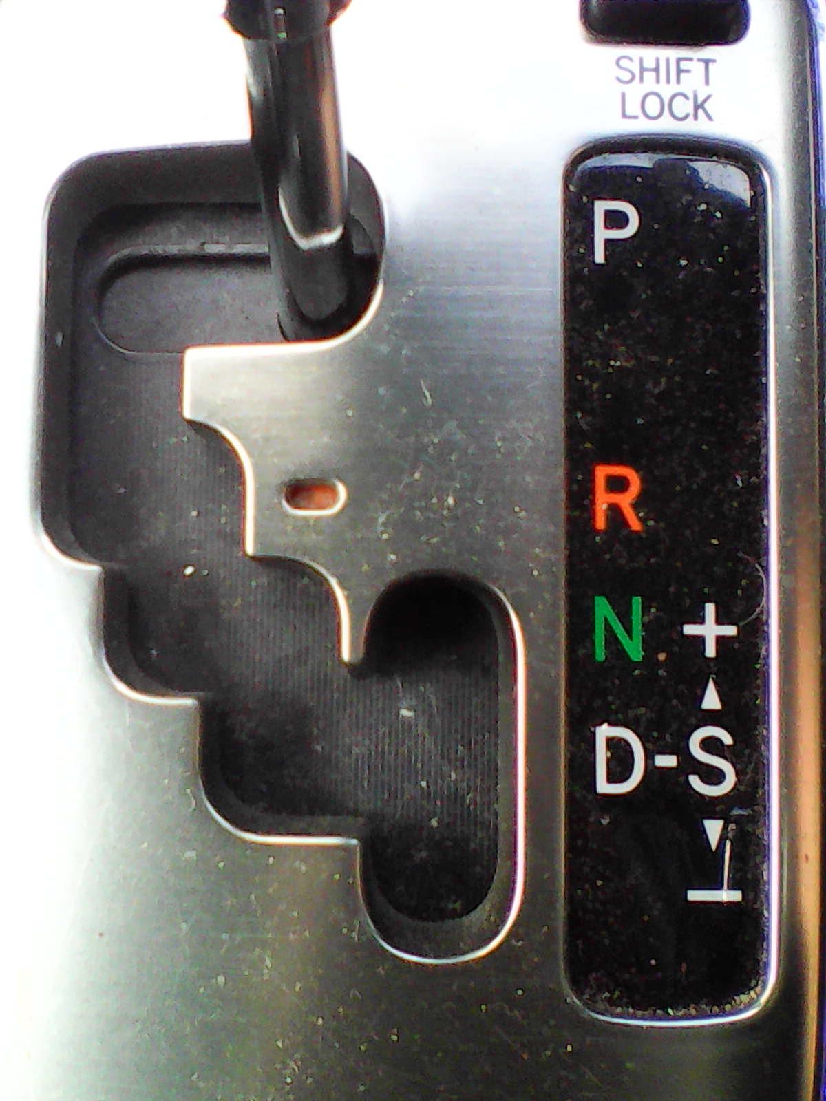

A picture. Much as I dislike the thought of the EPB on the T27 it still looks a better bet than fixing a MMT fault!
As far as I can tell the MMT does not have a P park position and the + is at the bottom so I think mine is a Tiptronic transmission, with a torque convertor and non of the nasty multi clutches of the MMT. So good then-that the T25 is not MMT- have I got that right?

A 1.8 Auto T25 Avensis uses the U341E Auto transmission see Here

Got it-strange it seems to be fully automatic with hydraulic "clutches" but still refers to it as Multimode Automatic Transmission in the opening description. Thank you very much for finding the link!

This is NOT an MMT 'box.  Its an Aisin U341E electronically-controlled four-speed automatic transmission with lock-up torque converter.  The gearbox has a feature whereby you can manually shift the gears up and down using the +/- positions - a kind of 'Tiptronic' mode.
These transmissions have been used in many Toyotas (and some other brands) and are an extremely reliable transmission if you keep them filled with clean ATF. Use only Toyota T-IV (also sold as Aisin 3309) ATF.
