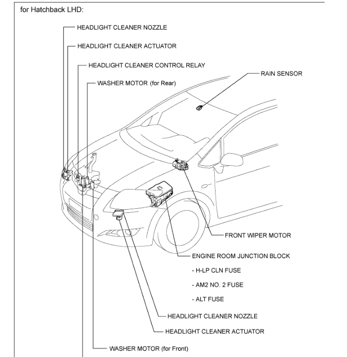

I'm a Auris owner from one week.The car is 2014 hybrid wagon  and I'm generally pretty happy with the condition. Has 161 k km on the clock and everything is working except the washers -both front and back.
I've found the owners manual and checked the fuses and they are OK. seems like the relay is not working. Do you know where I can find the relay location or service manual(not owners)The pump is only one as far as I can see and I need to remove the front bumper to get to it.
I was unable to find it with the search option.
Thank you in advance,
You can use the service manual from here, but it's payable access https://www.toyota-tech.eu/Aim/Aim.aspx 3 euros for 1 hour, should be enough to get what you need, and you can save/print it.
I presume you have left hand drive model, on first generation it was all together, so maybe you have it the same on 2nd gen.
You can also go to http://japan-parts.eu and if you have the relay part number, see where it's located, or try to find it manually and see.
Thank you for your help! In the end it was the pump that's not working and the previous owner lied about it. I'm searching for a replacement.
Luckily the part is quite cheap, even new, hopefully it wont be too much time ocnsuming, good luck.
