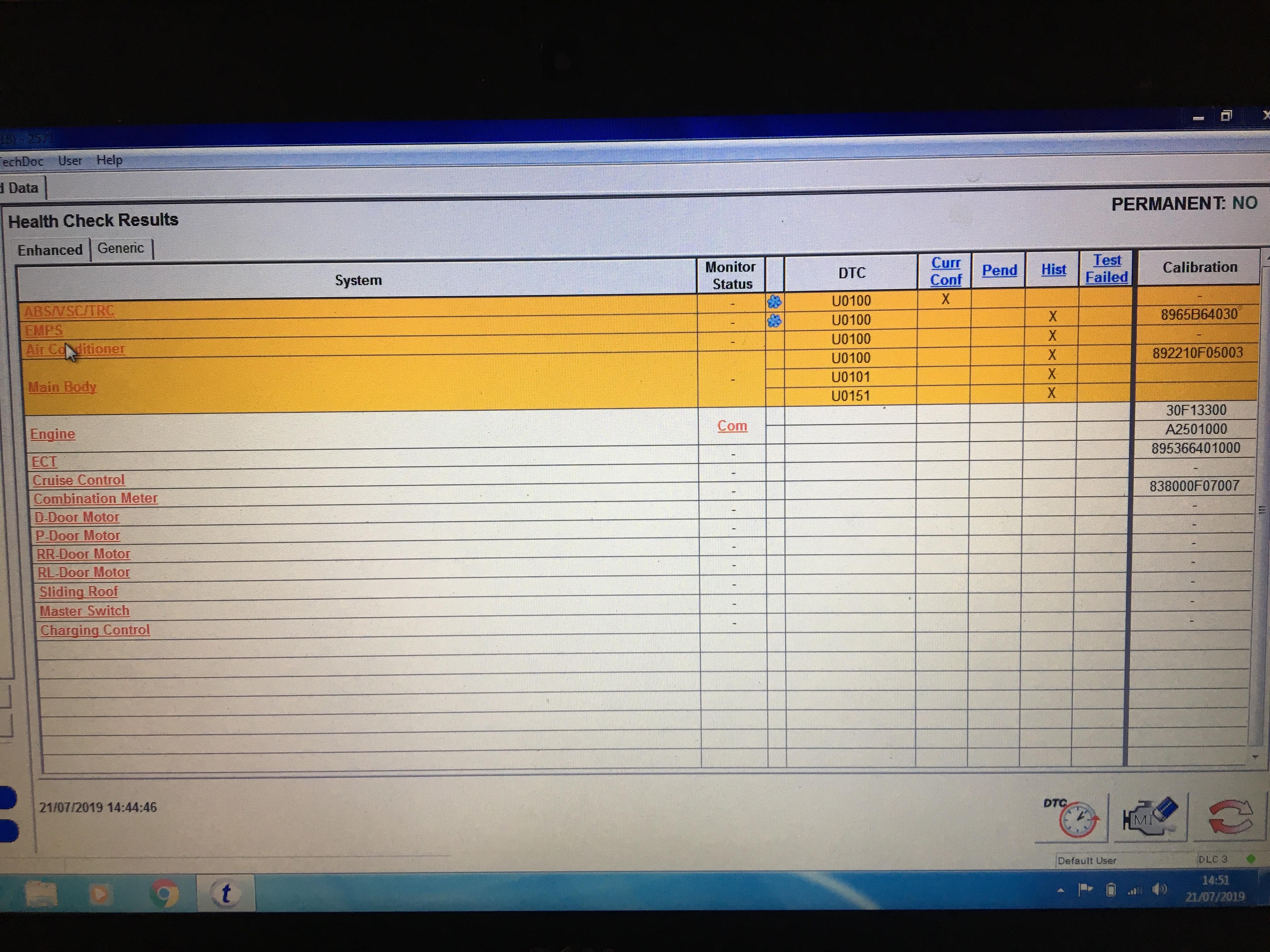

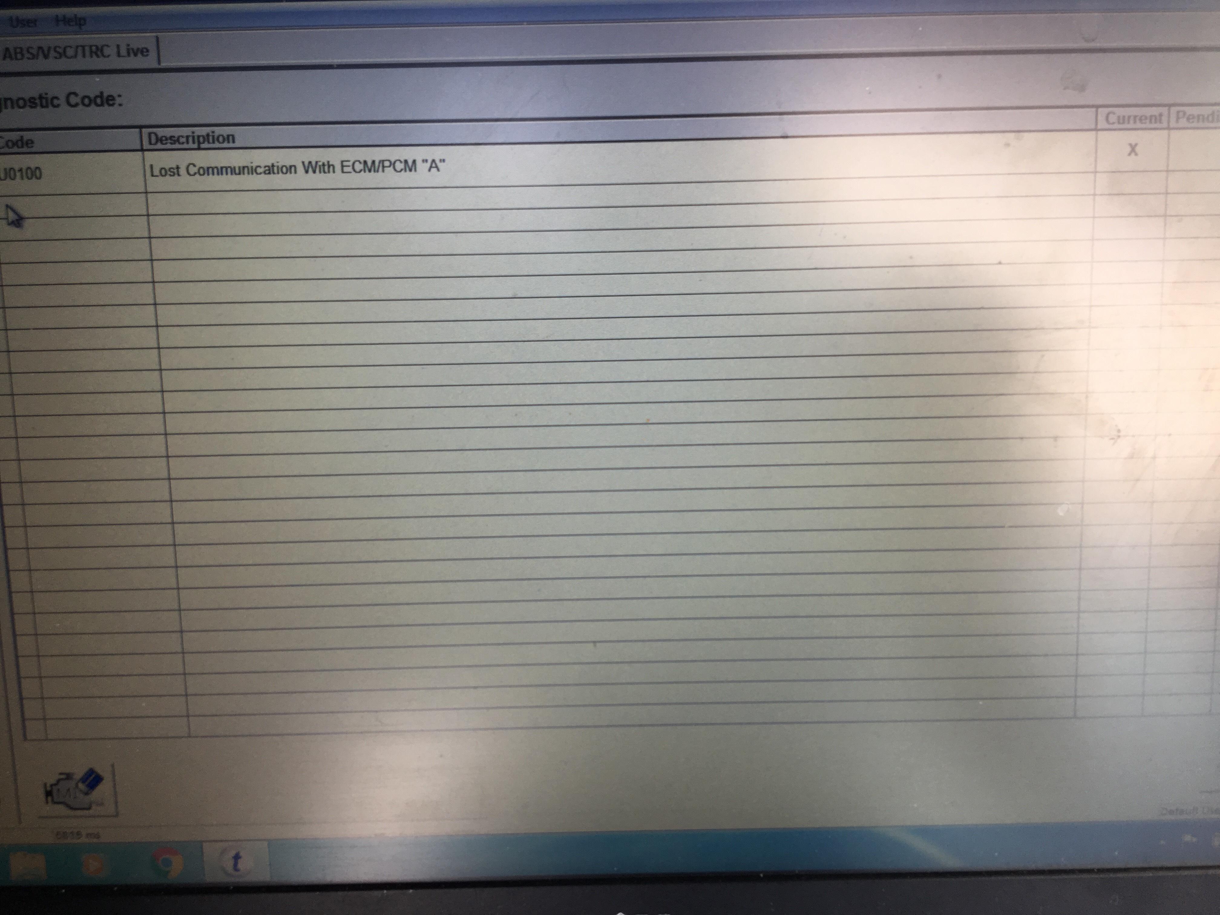

Fault Codes are attached:
Thanks all!
You have fault codes:
U0100 Where the ABS,VSC,TRC,Electric PAS, Air con & Main body ECU cannot communicate with the Engine control unit " Lost Communication with ECM/PCM "A"
U0101 Where the Main body ECU cannot communicate with the TCM ECU ( Transmission ECU ) "Lost Communication with TCM"
U0151 Where the Main body ECU cannot communicate with the Restraints ECU "Lost Communication with Restraints Control Module"
All of these communication issues suggest a wiring issue, but where could be PITA to find
