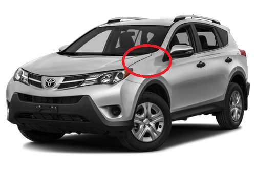

Hi. I've got a really annoying creaking sound from the left side, lower part of the windscreen.  The noise appears when i turn the steering wheel fully to the right, sometimes to the left as well. I've taken apart the dash, and the cover under the windscreen wipers, but i really can't locate the source. I've pin pointed the sound to come frome the area around the bottom corner of the wind screen, or A pillar area. Any ideas?

I've  found that the noise actually comes from the outside, the area is narrowed down to a "triangle" stretching from the left windscreen wiper, a pillar  and the fender. Could it really be that the metal parts are rubbing against each other? Anyone that have had this issue with their RAV4's? This is really testing my nerves. 😛 It's clearly not the steering column, not anything inside the car, because i can hear the sound much better on the outside.
Hmmm, the bonnet hinges are in that area.  They could creak if they were "dry",  No harm in giving them a spray with GT85 or similar.
I would check the top strut bearing
Structural, perhaps body welding, micro cracks or something similar that doesn’t move a lot to be seen but twist when under loads and create that sounds. Many cars are like that, some on the front , some on the rear,  and that’s why more and more manufacturers are talking about better structural rigidity on newer models when introducing them to the public. This may be a problem if it’s bad enough to be a weak point and in case if car is involved in accident.
Years ago I had a creaking noise (in a Nissan), but it was only when going slowly over bumps. After removing a suspension strut and even installing a microphone under the bonnet, it turned out to be the bonnet itself, groaning on its rubber mounts along the edge of the wings as the body slightly flexed.
I doubt your problem is this, but just in case, does it do it if the bonnet is not fully down?
