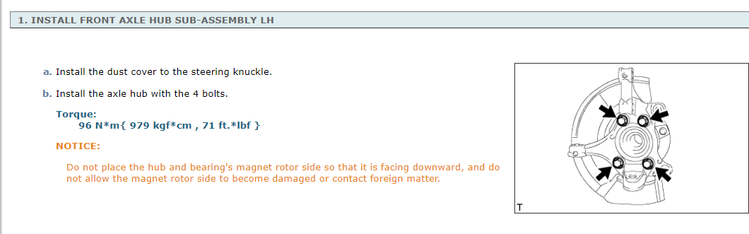

Changing my front auris wheel bearing tomorrow, does anyone know the torque settings for the 4 bolts which hold the bearing in place and the driveshaft nut,

Can't actually see the torque setting for the 4 bolts holding the bearing in place
Thank you so much Dean, much appreciated, great help as always :clapping:
