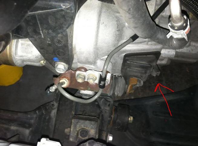

remppainen 0 Posted August 20 I have 07 Corolla E150 ZRE151, that has clutch fork squeak. Can i just spray some WD40 or other lubricant to the fork ball just via that hole in the rubber so that i would not have to remove any parts?? WD40 or what other sprayable lubricant would u suggest? Thanks! Quote Share this post Link to post Share on other sites
Catlover 310 Posted August 20 WD40 is a good lubricant for seized or semo-seized components. It dries out, so not a good long term lubricant IMO. Worth using white lithium grease in a spray like WD40. Quote Share this post Link to post Share on other sites
