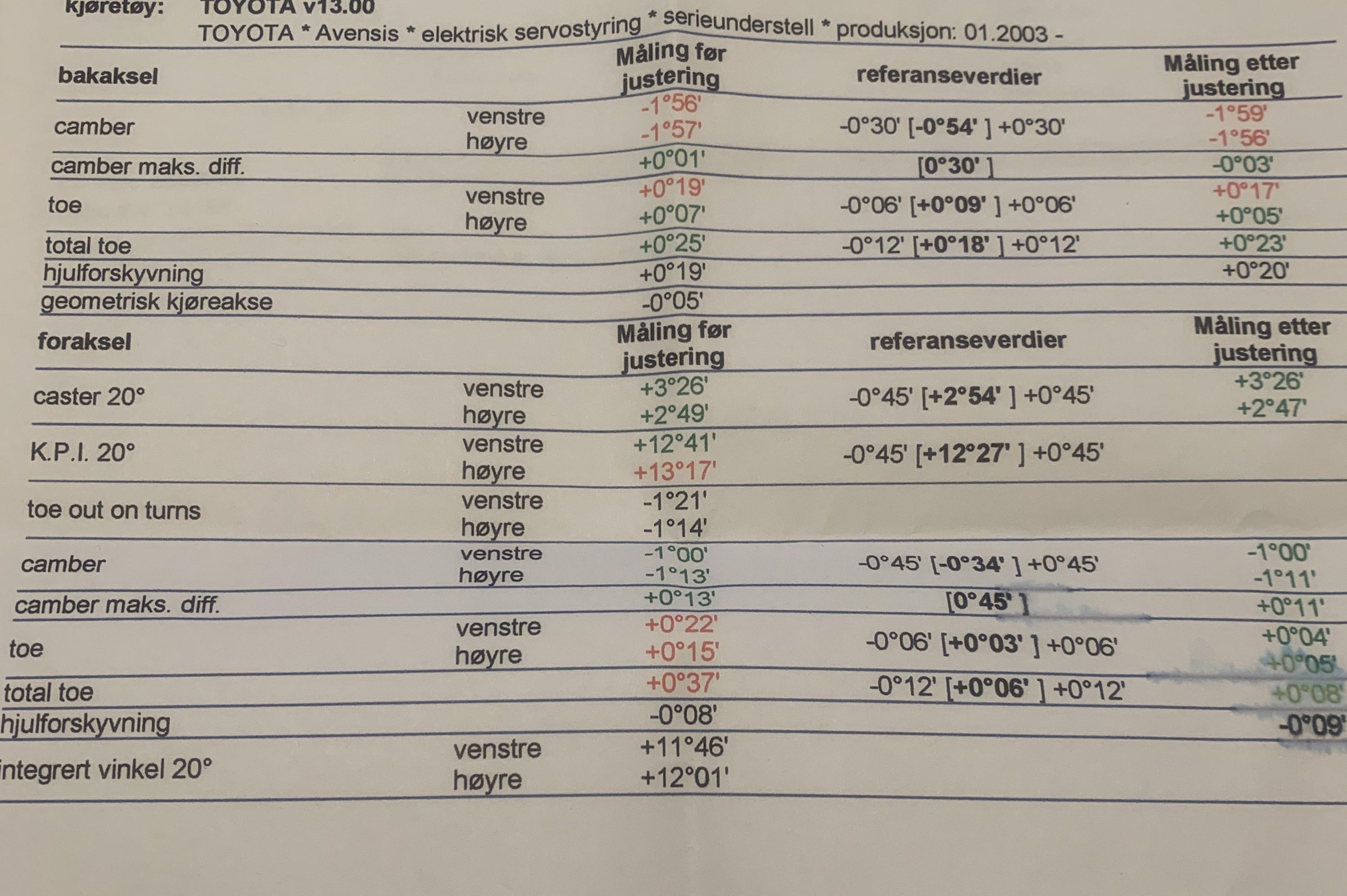

Ok so here are the results. The toe in front was off like suggested 👌 they were not able to fix the rear due to rusted/stuck parts..
So has the front been adjusted, and resolved the problem?
Yes now all is good, the camber is off in the the rear by a bit so i might still get some tire wear in the rear by the looks of it. But the steering is now ok.
