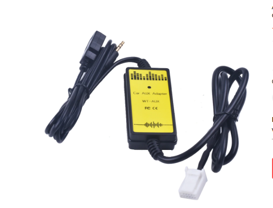

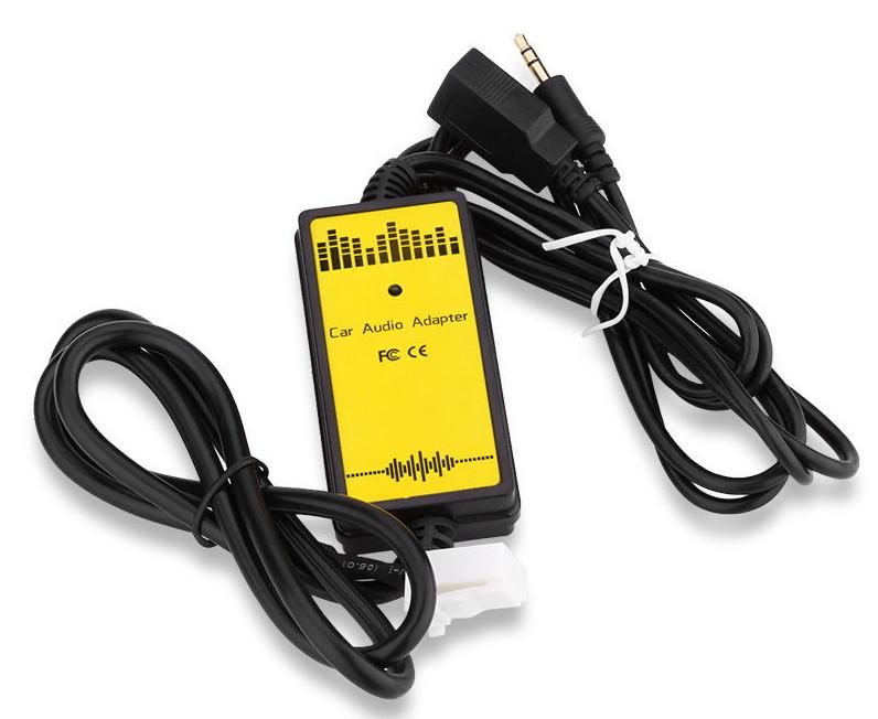

You can buy an adapter online for 20-ish GBP that's plug and play, you get aux input and sd card/usb port with it, they usually send sd card reader adapter as a gift.
It uses CD changer port, installation is pretty easy, you take the glovebox off, and you can just plug it in from there, usually people leave the cables in glovebox.
Just search for Auris mp3 aux adapter (ebay and alike).

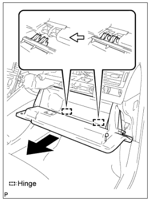

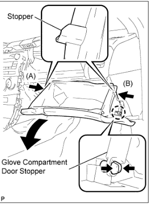

Yeah, it's like 10 second job, you can even find videos on youtube. Basically you open it, then remove the dampener for it, i guess on UK version it's on the side closer to the door.
This will enable you to open it even more, then just pull towars yourself and it's off.
The hinges are actually like clamps, so it comes right off.

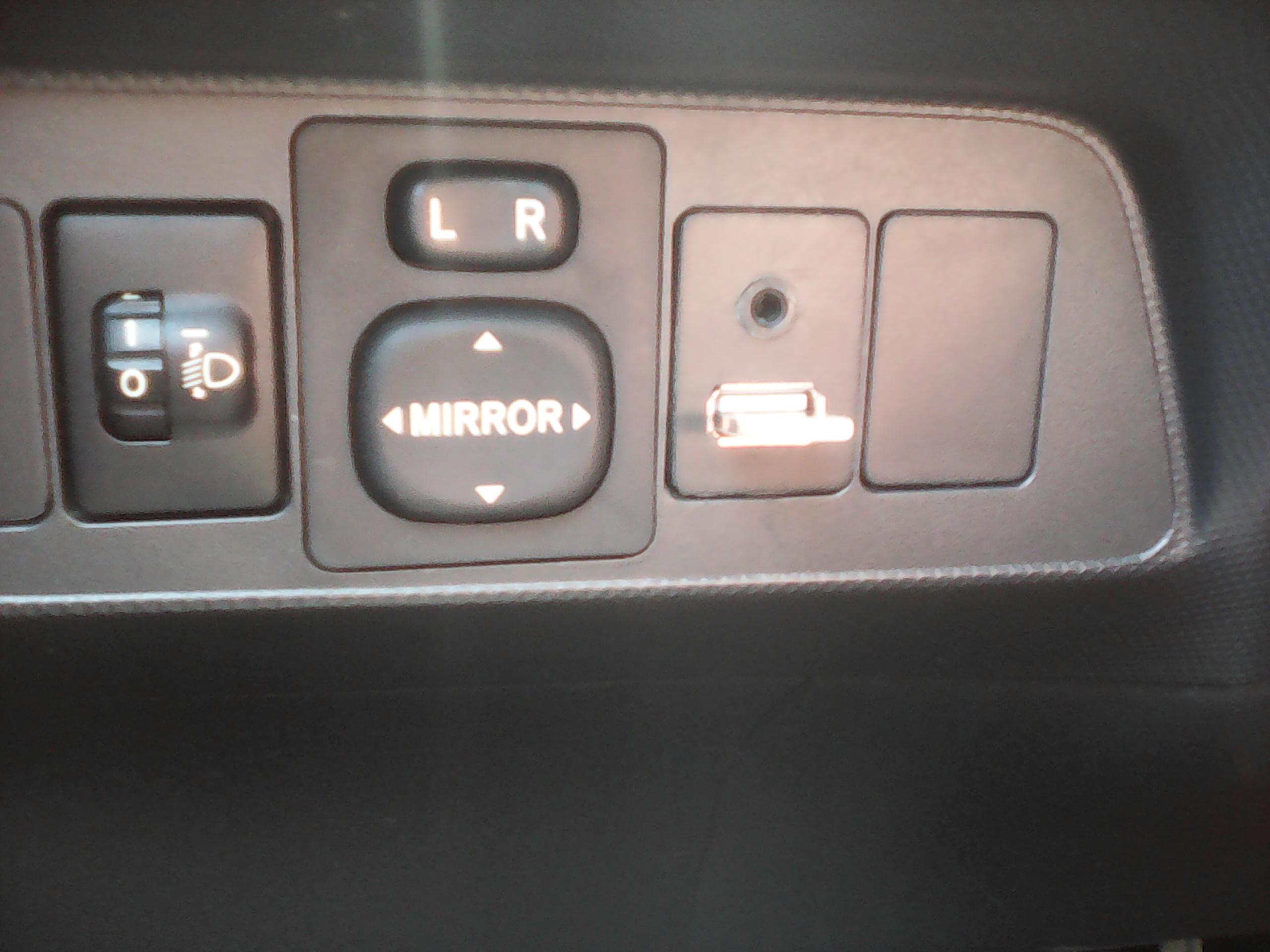

Hi Lee,
this adapter I fitted to my Auris few years ago, it sounds very good, it's 100% compatible with player, working exactly as a CD changer;
I put the box backside of the clocks, USB and aux connectors installed into a false cover button.
For this operation I removed radio, clocks and small switch panel with mirror controls.
It's plug'n play job; clocks and radio are very simple to remove.
A little bit tricky is making holes in the fake button; the easiest way is to put cables with connectors in upper glove compartment.
I'll just do mine I think by getting a sticky pad mounting it in the lower glove box I think, for £20 cheap upgrade isn't it?
Yes, mounting the box with cable in glove compartment is the easiest way, of course.

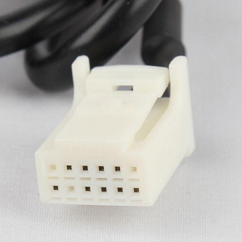

Very easy, the adapter should have a connector with 12 pins (6+6).
