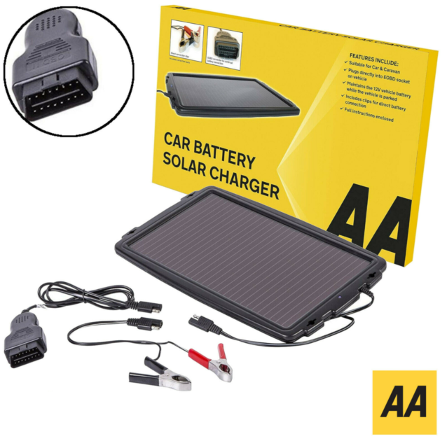

I got one of these. I haven't had the need to use it yet, as I have been driving fairly regularly. But have checked with my local Toyota Dealer (who also sell them) and they have confirmed it is perfectly safe to use.
These solar chargers are great however they only can maintain charge on  a healthy Battery. They can not recharge already drained Battery, weak Battery or they do not work on cloudy days. They are perfect for brand new car and if not used frequently, and of course parking on open space with good amount of sunlight.
