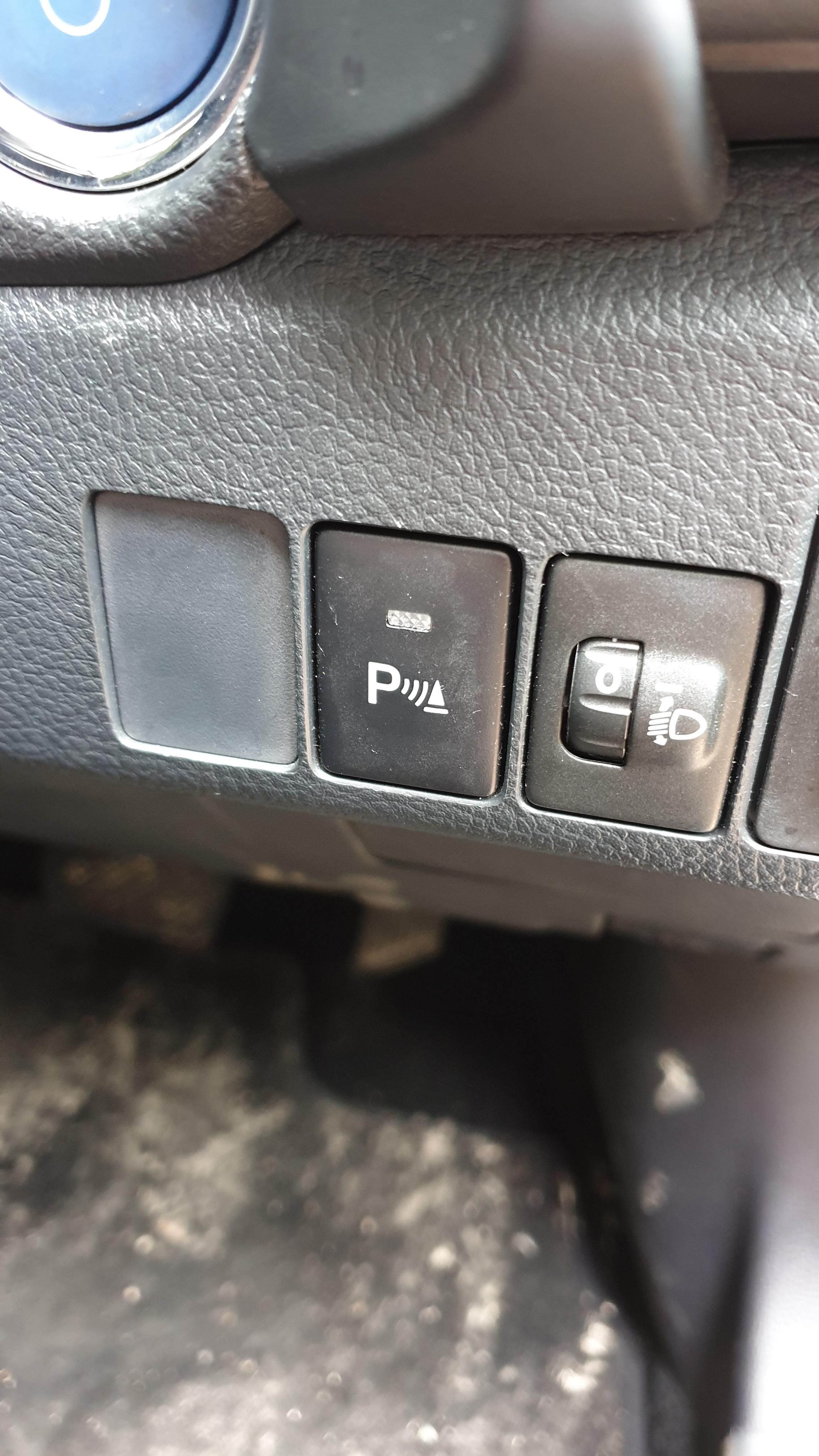

The problem is I don't know how to turn them off. While driving in traffic if something gets close to the car it starts beeping. I take over a cyclist, or pass a bush, even if there is a hump on the road.... BEEEEP! This drive me crazy. Right under the steering wheel on the right hand side I found a quite chunky rectangular button with "P" on it. If I press the the beeping stops for a while but it comes back again if any of the situations mentioned above occur. I couldn't find out which is the ON or OFF position of this button, as the beeping comes back either way. There is a little yellowish led light on the top of this button too. When the beeping starts it lights up until I press it. Then it goes out and the beeping stops...for a while...

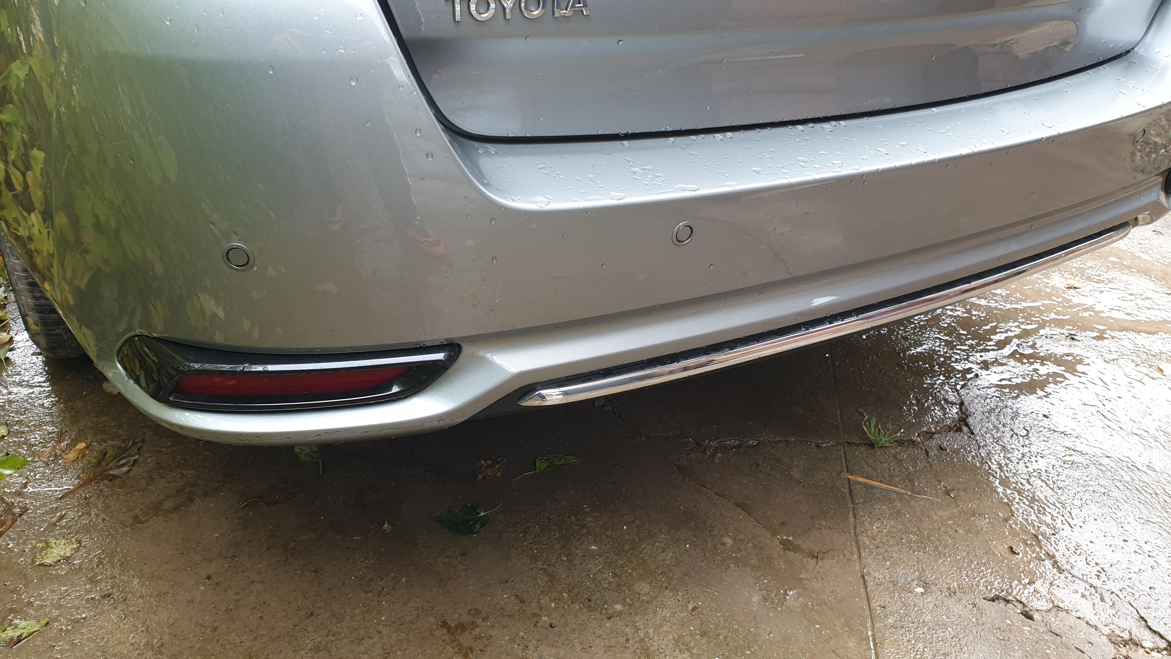

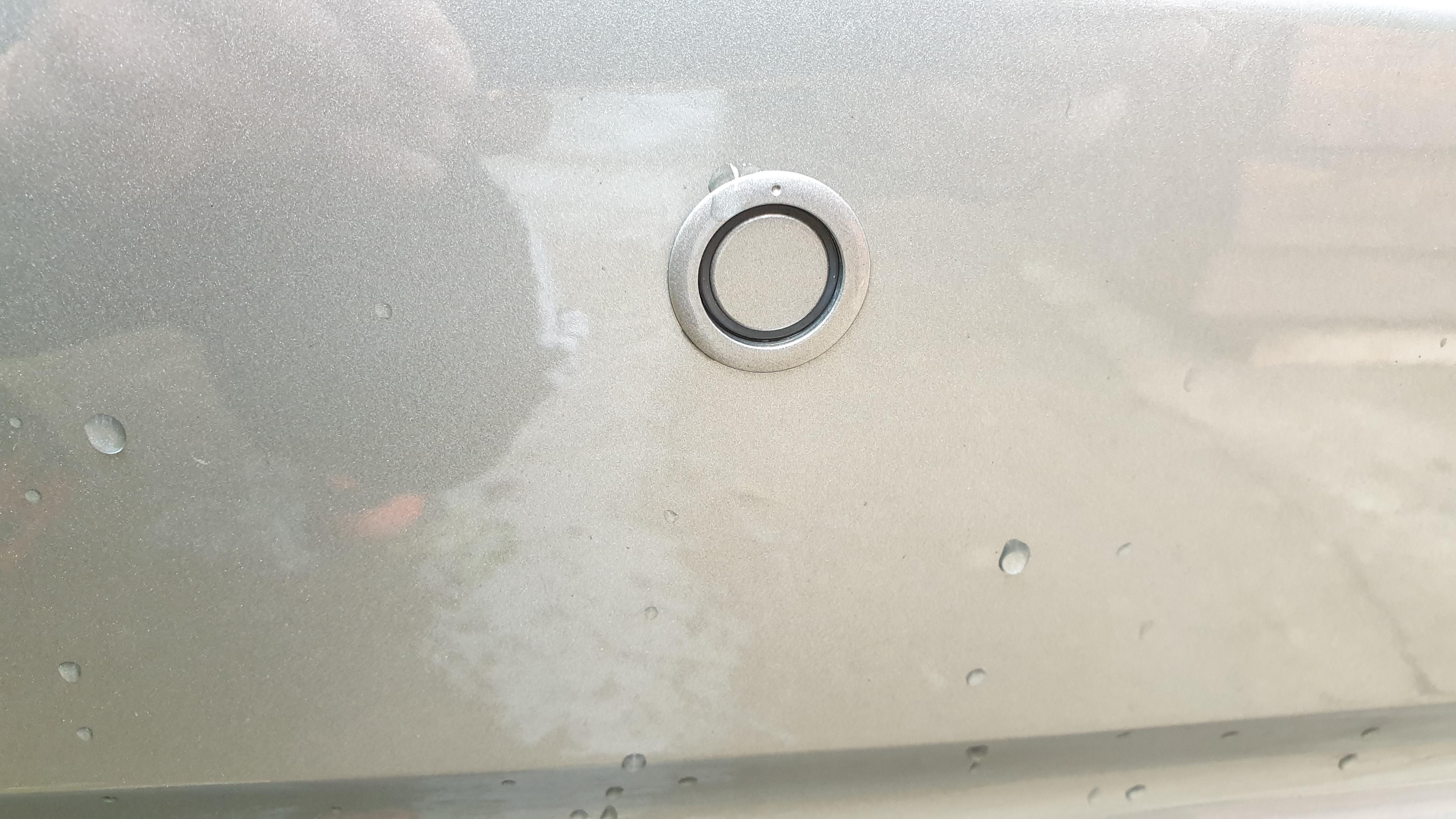

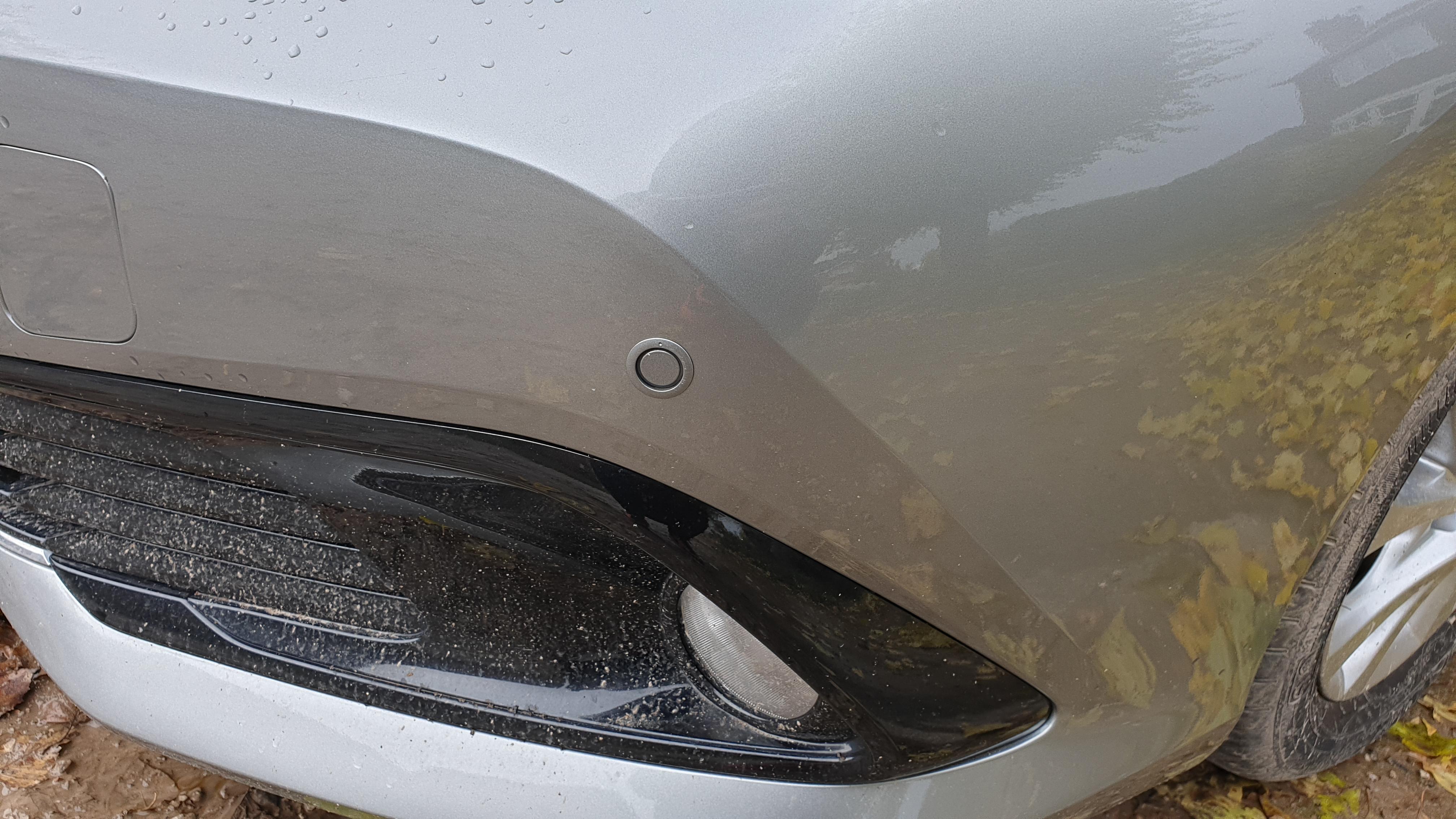

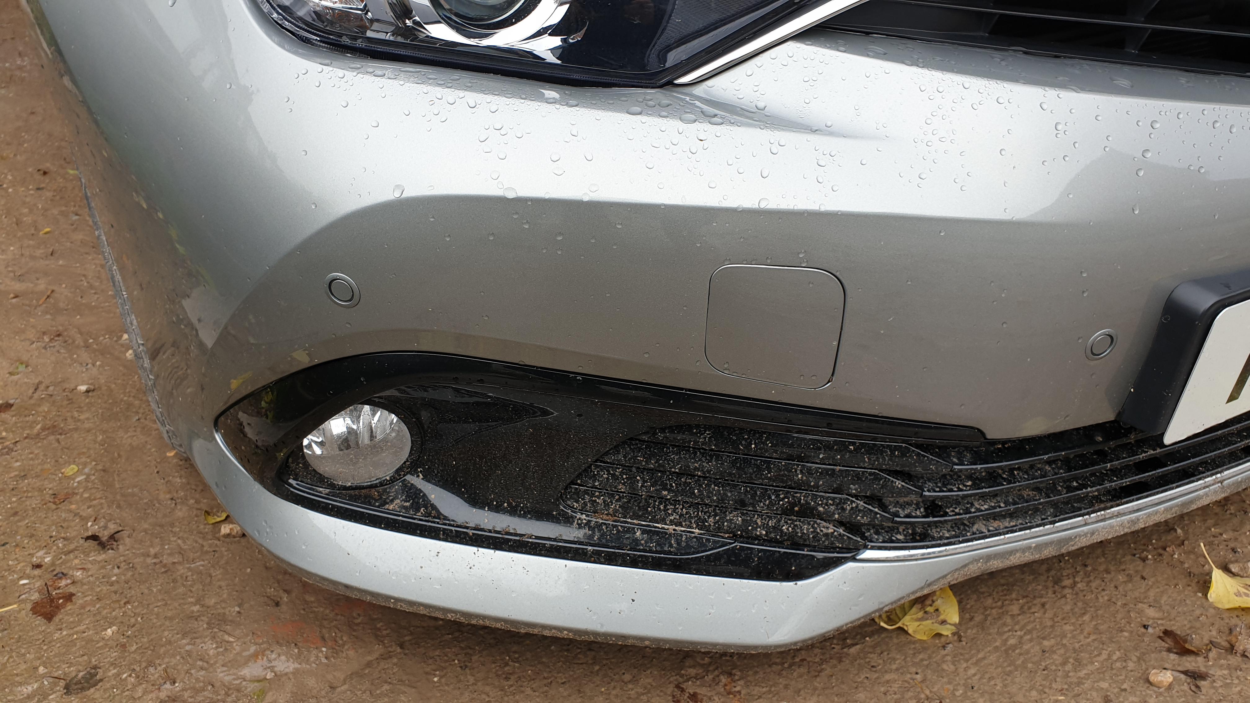

As I promised yesterday, I took some pictures of my sensors. I have 4 at the front and 4 at the rear.
Also here is a shot of my parking assistant button. If the car starts beep at me in traffic, I can push this and it stops....but it comes back again later... Doesn't matter if it is pushed in or out...
Ok your sensors are an accessory item not a factory fit the picture of the sensor and the small snippet of a wheel and headlight suggests you do not have an Excel but perhaps a Business Edition, as Excel models have 17" dark finish wheels, LED headlamp and factory fit sensors.
The button on the dash is an accessory fit along with the sensor, user guide here: Here

Hi,
Thank you so much for your help! That manual helped me a lot. No more confusion. 🙂
You are right. I have a Business Edition not an Excel. Even my V5C shows that. I thought it is an Excel because of the heated leather seats.
