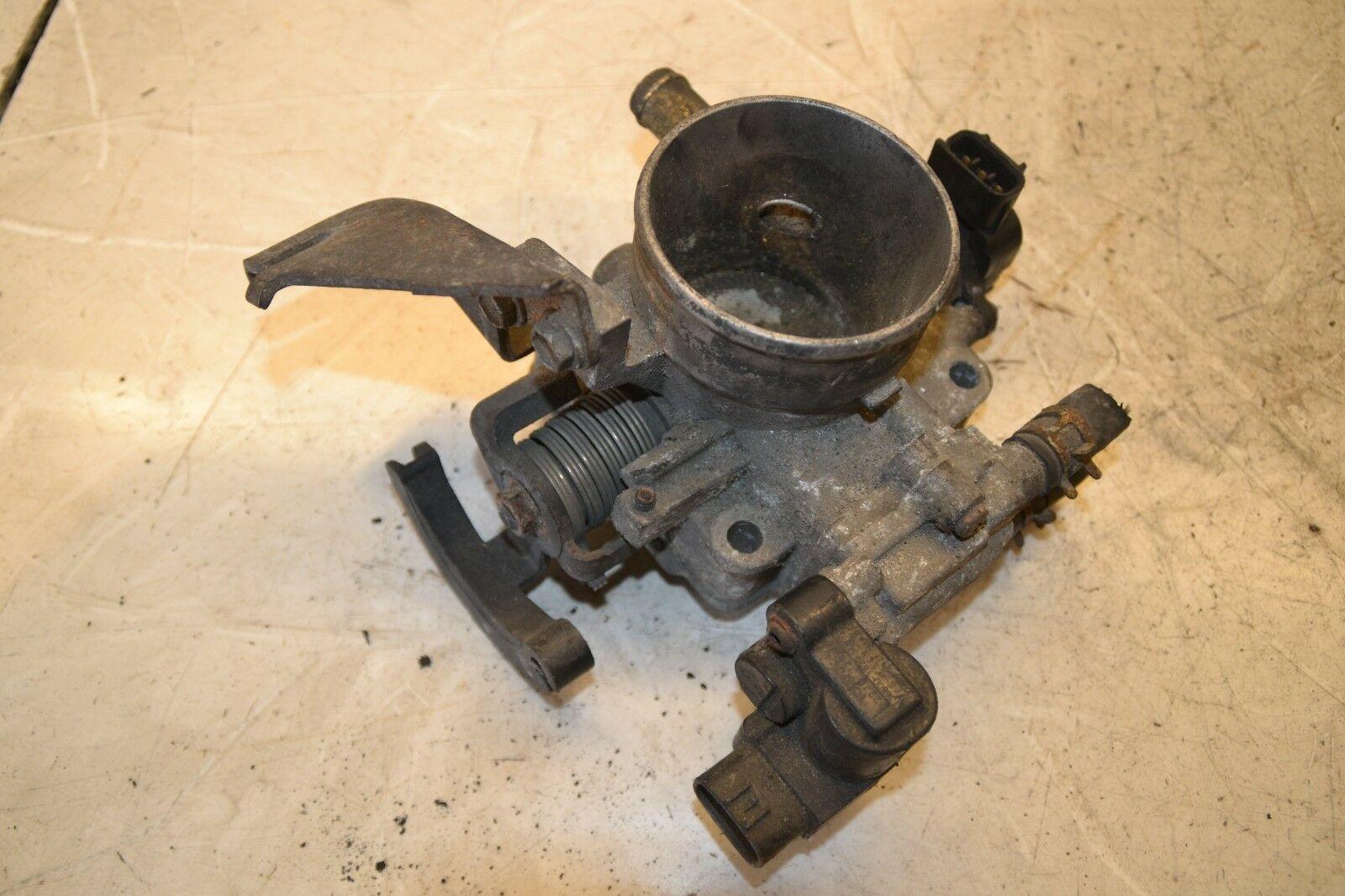

In the absence of anything else to try at moment, you could try this:-
The stepper motor for the idle control valve, if I understand your engine correctly, is the black plastic unit that sits at the bottom of this photo (taken off an eBay item).
If your throttle body does look like this, you could try disconnecting the plug that goes on to it.  This will likely create an error code (which will eventually go away some while after you have reconnected it and driven the car etc.).  The car idle speed will be incorrect, so you may need to apply some throttle just to steady the engine.  If the revs no longer jump around independently of your throttle input, then maybe the stepper motor is at fault?

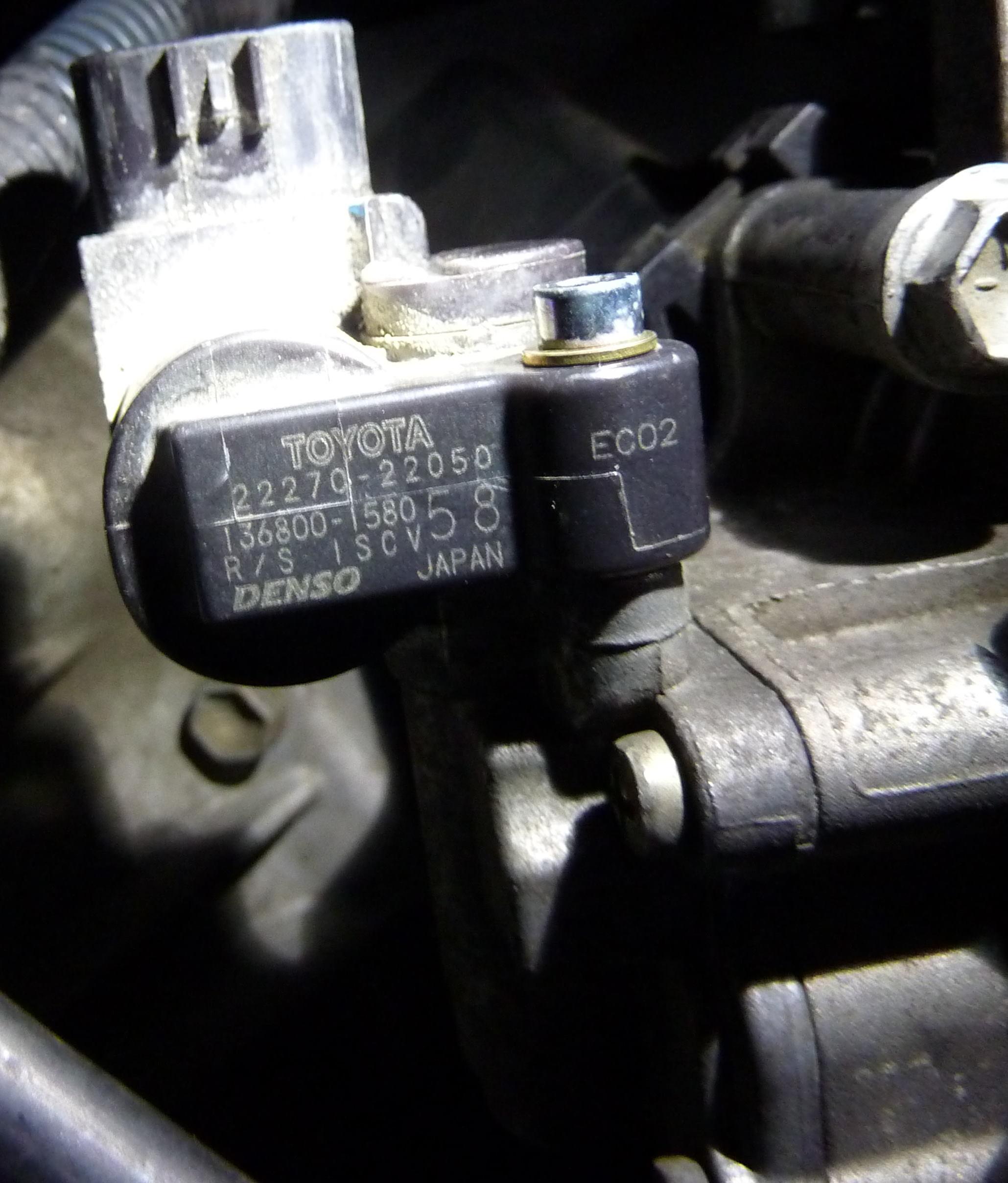

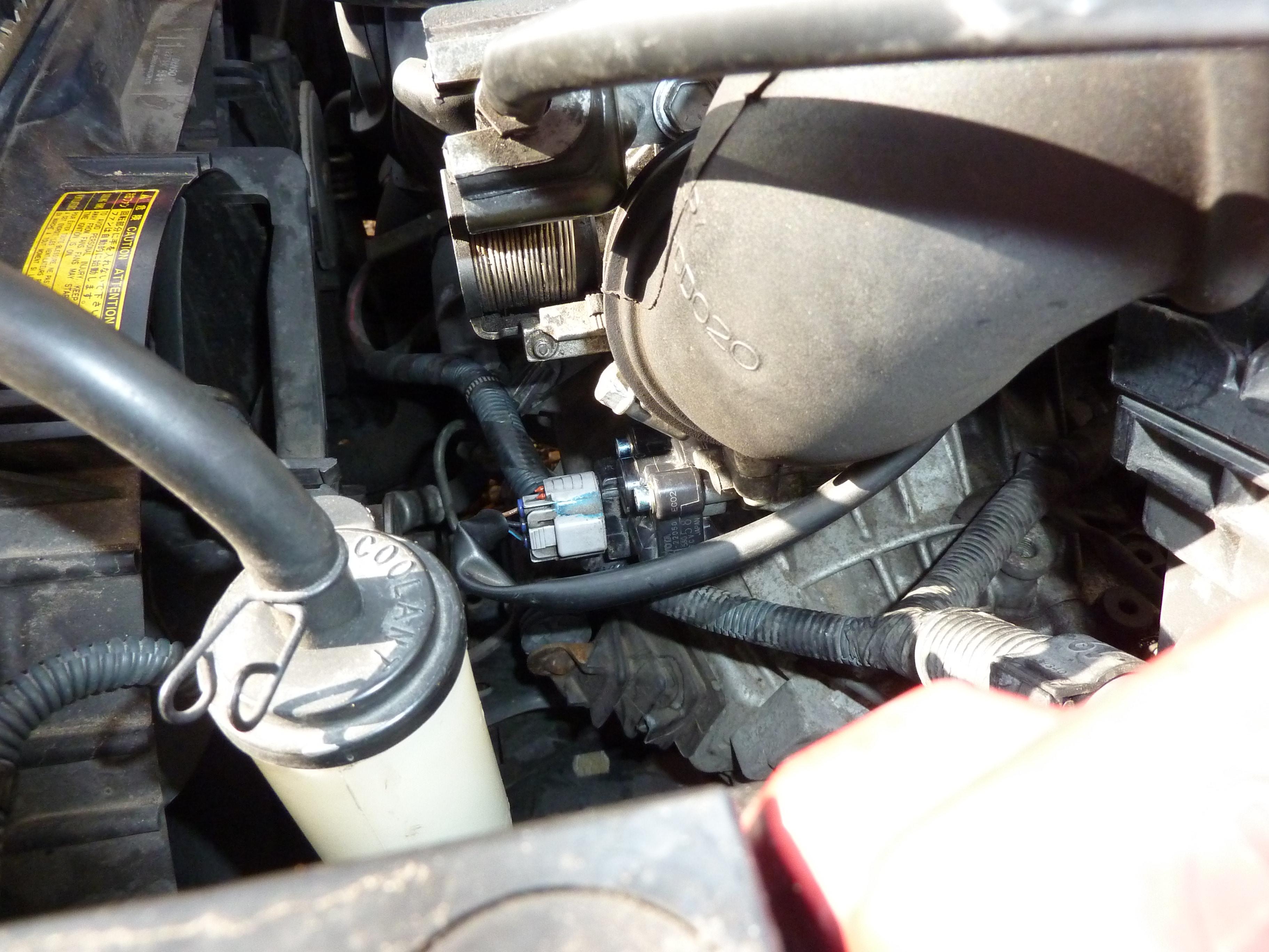

I replaced just this stepper motor with a secondhand one six years ago, it has never gone wrong since.  I also replaced the bolts with some other ones I already had (shown with a slight blue colouration in the next pictures).
But, on the Corolla an error code was eventually triggered as the engine warmed up, which you don't have.

I still think you have a fault with the throttle body/idle air control valve. Remove the IACV and clean it thoroughly.

Yes I agree. You are describing the idle air control valve
