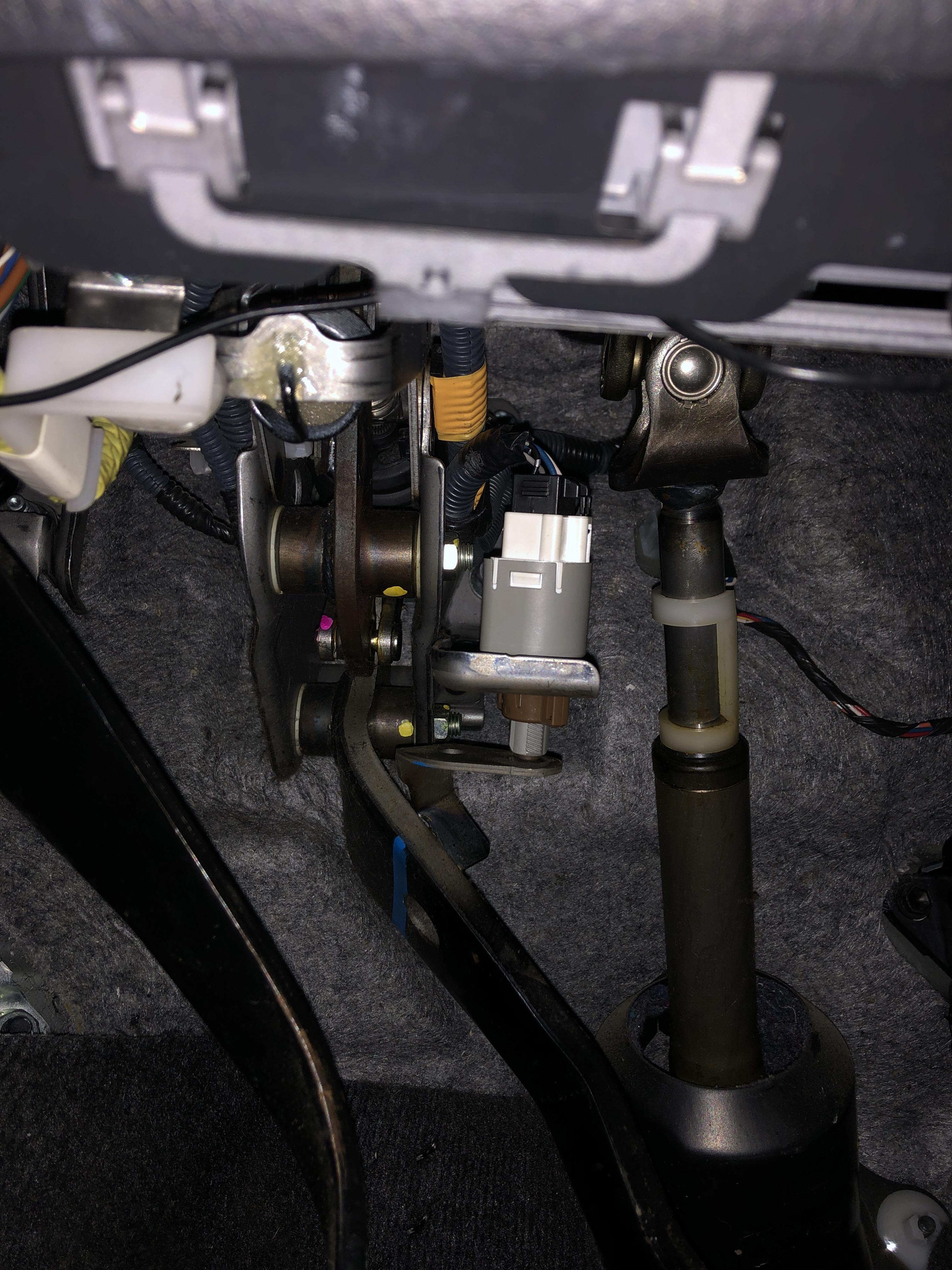

I have checked the connector to the brake light switch, and it only has 12V on one pin when the ignition is on...... As I understand things, it should have 12V on one pin all the time, and 12V on the other pin when I turn on the ignition?
Any ideas of where to look for the fault? I have checked all the fuses, and tried to check the relay. Could the relay be faulty?
As mentioned above, the brake light switch frequently throws up such fault messages. I bought a new one for my wife's car and before I fitted it I checked out how the old one was fitted and played around with the connections in preparation for fitting the new one in the morning. I didn't even need to fit the new switch as the next day the problem was cured and never reoccured.

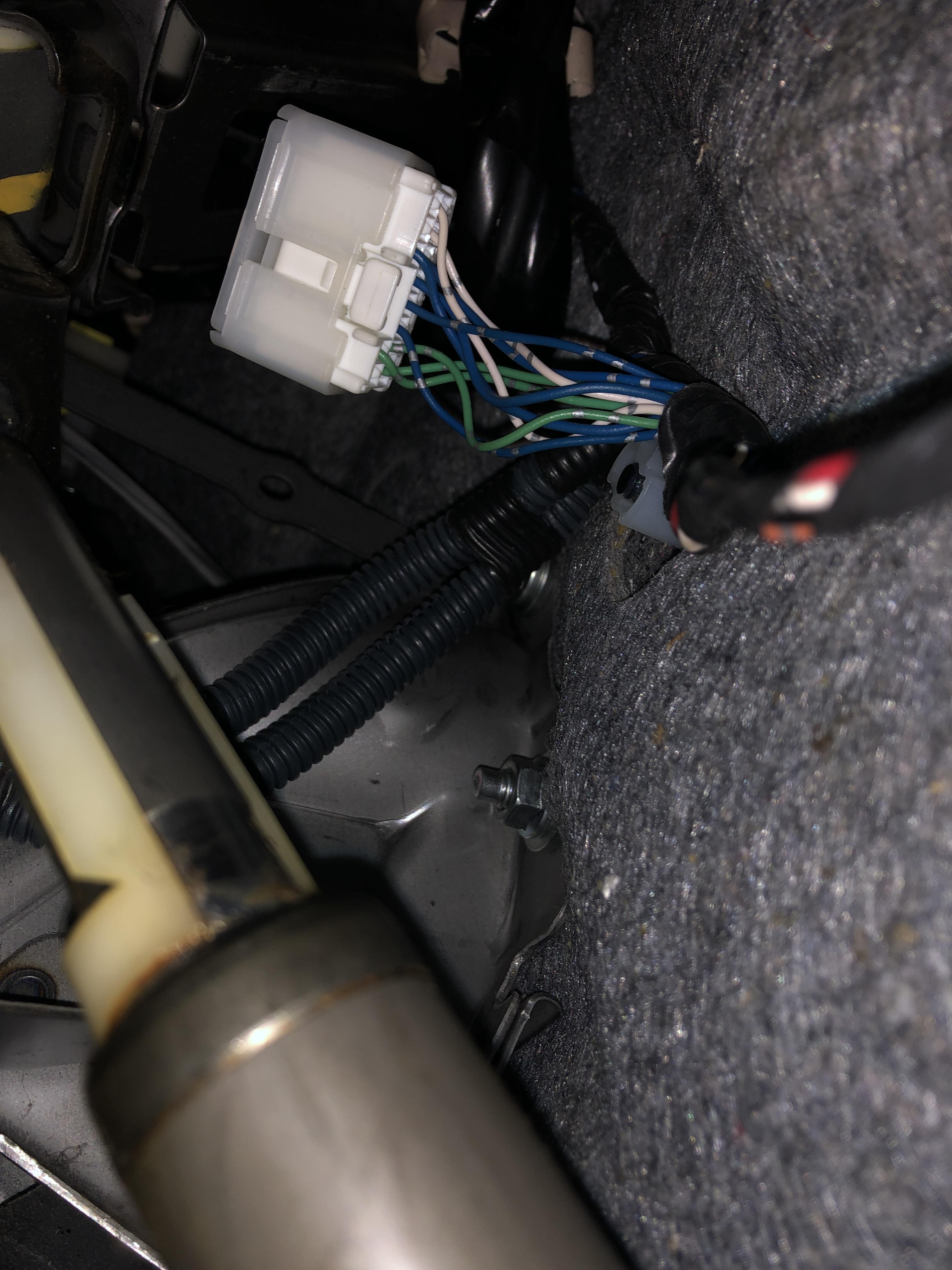

Well, I’m afraid the new one hasn’t helped.... I’ve been looking for a relay, nr A43 I think, but can’t find it.
Only found the connection on picture 2, but that’s not a relay....
No clue to futher action, other than going to a workshop and ask them to check??
