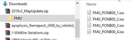

I downloaded the update file from MY Toyota to my computer desktop. The file was called 2019v2_MapUpdate.zip
This is a zip file containing one folder called FMU. Inside this folder are four .iso files.
I extracted this folder from the zip file then copied it, with its four files, to the empty USB stick.
As for your problem, I don't know what you've done. But you CAN try again, I've just done it... don't try to buy it again, go to your account and look for the link to your purchases. There you can find a record of your new map update.
First click on the link called "Download instructions".
This explains what to do: Step 1 Download file to your PC. Step 2 prepare USB and copy files to it etc.
I know the link title is misleading but now click on "Download to USB". This actually initiates a download to your computer. This is the zip file I mentioned above. You may actually have this on your computer already and not realise it. Have a quick search for it in case you have!
So you know what you are looking for the attached pic shows mine in my Download folder and what's inside the zip.
