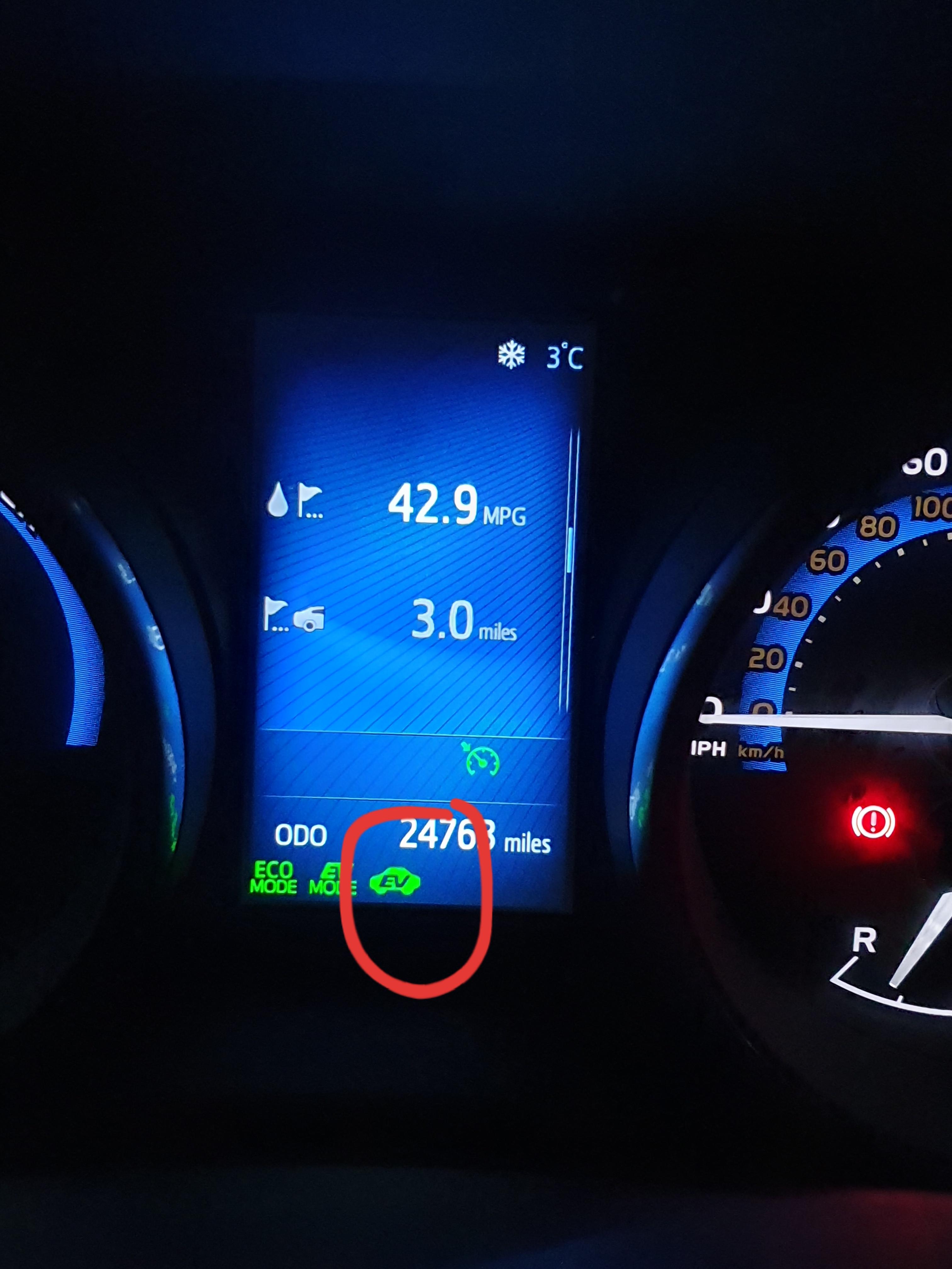

Hi does the ev not work during cold weather? I know the ev mode does when you press it
What makes you ask the question? What is or isn’t happening that you expecting to happen.
Hi, thanks for coming back to me. I wasnt expecting it to happen. It's a new car I bought about 3 weeks ago. I love it though. Is it something that generally happens??
Your Auris has a computer, what car doesn’t these days, but a very sophisticated one in the case of Toyota hybrids. You, the driver, has little control over what the computer does, it’s programmed. So, the computer is programmed to run EV only when certain criteria is met, mostly it protects the engine.
So when the engine is cold the computer fires it up to get it to a decent temperature. You may be able to press EV Mode, if enough HV Battery bars showing, and run with engine cold BUT only up to a predetermined speed limit, which is relatively low, then the engine will kick in.  This is so you cannot be going ,say, 50mph on a stone cold engine then it kicks in.    In the cold weather, like we been getting just recently, it means the computer will be ensuring the engine is running more, thus keeping the system at a determined temperature. So EV will be running less. Even when the engine is warm an computer allowing EV to run more, the engine will be cooling off, and when it cools to a predetermined temp the computer will kick the petrol engine in again to produce heat.
